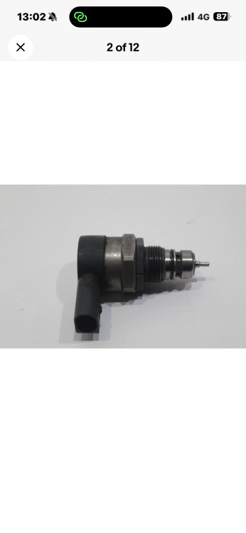

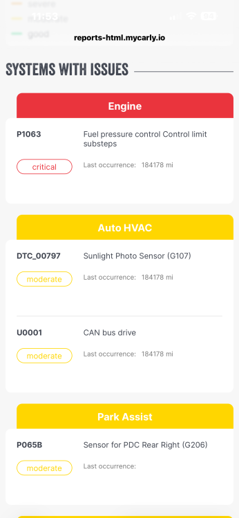

You put ya foot down glow plug light flashes and limp mode get code p1063 am I write in thinking it’s the fuel sensor on the left side of the bank tht is faulty

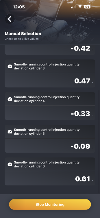

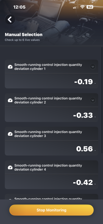

Hi no its the O2 sensor after the cat and not the fuel pressure regulator in the picture, also the injectors are not looking good.

Hi Steve it has no dpf or cat both been mapped out it’s straight piped and been told anything below 3.00 with injectors is fine when I google the fault code comes up to replace tht fuel sensor

Hi even if its a straight pipe it should still have all three O2 sensors so the system still works, I was just observing the variance on the injector readings as they should all read pretty much the same at idle,
