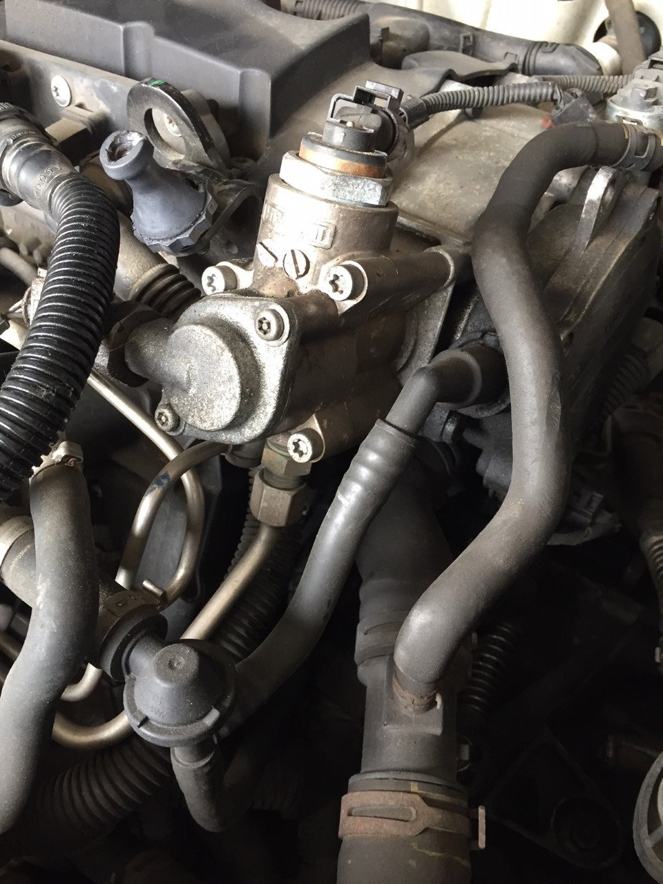

I've brought an A3 2.0 TFSI on a 2005 and I'm looking to replace the Cam follower for the fuel pump for peace of mind. After looking at countless guides and videos I can one of the first steps is to bleed the fuel pump...However I don't see a bleed point on the one on my car...can anyone help?
The first picture is my car ( no bleed point), the second is a generic picture of what most peoples fuel pumps look like with a bleed nipple.thumbnail_IMG_0570.jpg
In this instance, I would suggest removing the fuel pump fuse with the engine running and then turn over a few times to burn off any remaining fuel. Switch the ignition off & disconnect the battery. Allow the engine to cool before disconnecting any fuel lines. The fuel pump should then be depressurised enough to crack loose any fuel supply pipes and unions.
