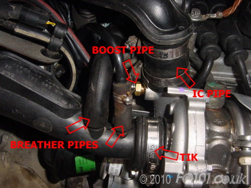

How would I distinguish the breather pipe to any of the other pipes? I believe the turbo is in behind the engine and it is very hard to get in behind to see it. (Maybe I'm looking in the wrong place?).

Also theres all different parts of the turbo, Have a look at this link, its the circle bit at the top/next too your turbo buts it's apart of the turbo. http://www.gfb.com.au/tech/troubleshooting/20-blow-off-valve-leaks-boost
1 hour ago, Surfwill123 said:
"How would I distinguish the breather pipe to any of the other pipes?"
Look at the picture linked :)
