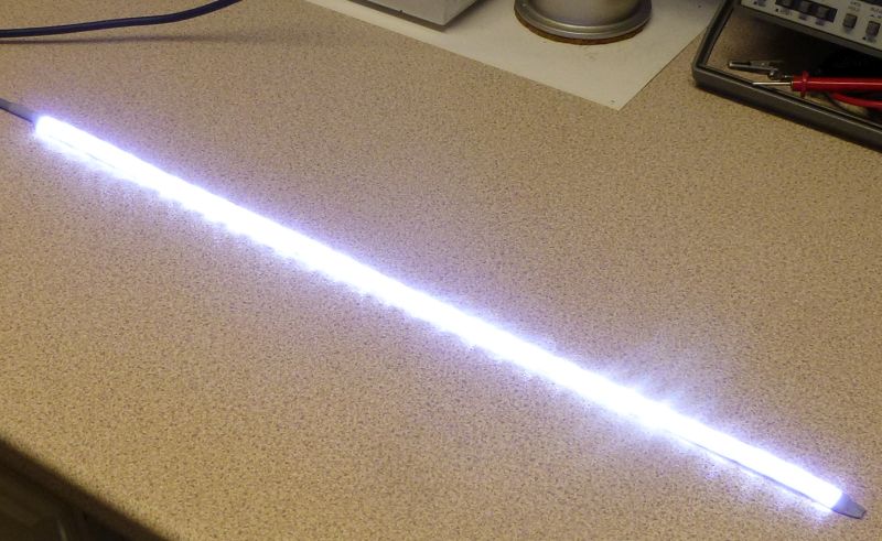

I've also obtained a 50cm length of 12V LED strip lighting, that is just 15mm wide to stick directly under the licence plate lights & rear door handle, above the number plate. I can connect this to one of the reversing lights and it would give a very much better rear view at night. I don't think it will look too unsightly there as it's partially hidden.  I've added pictures of the strip.
