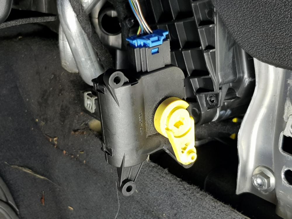

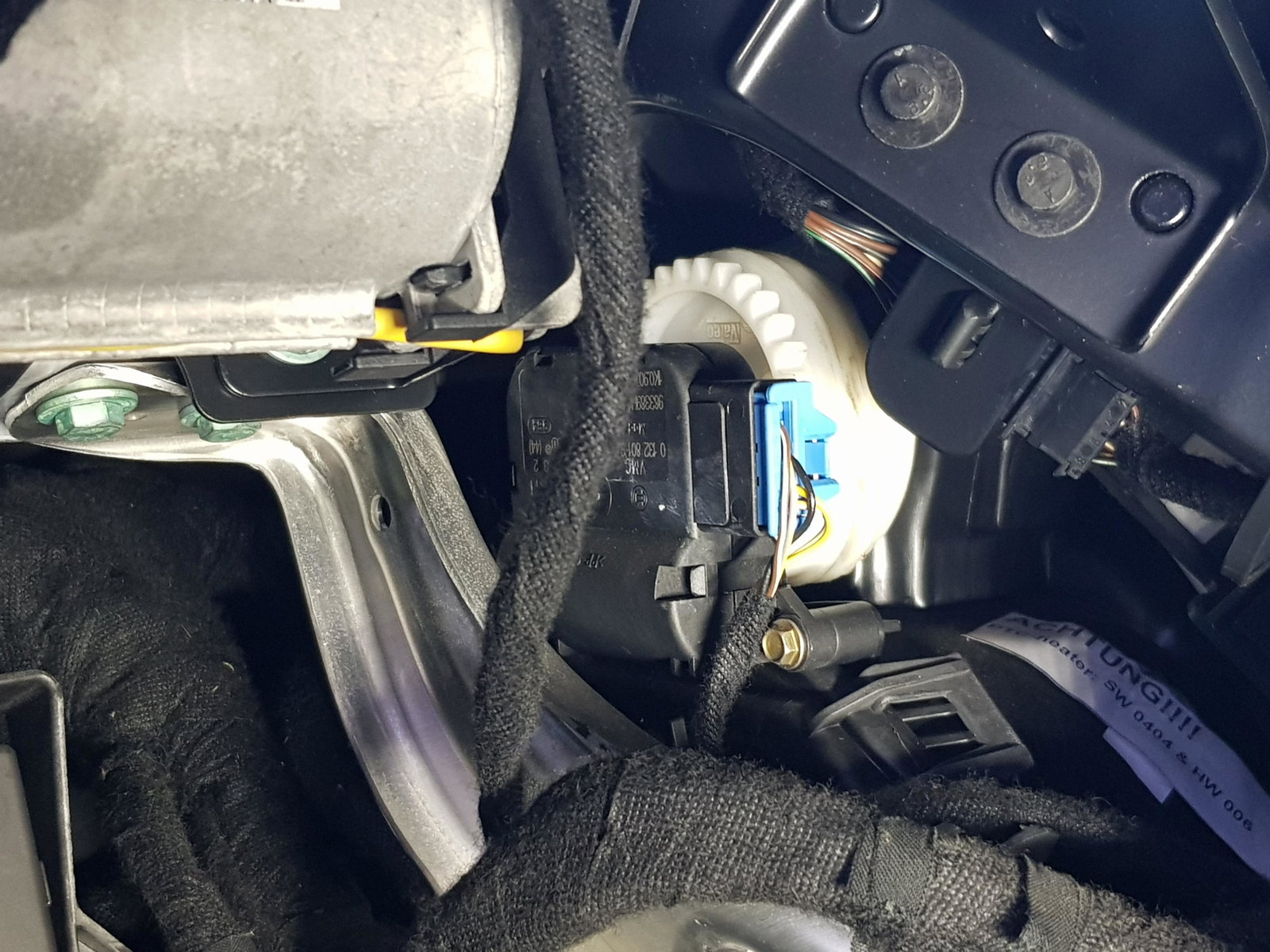

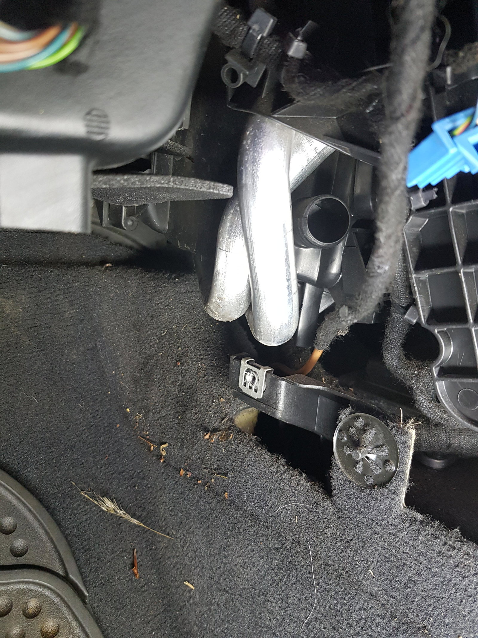

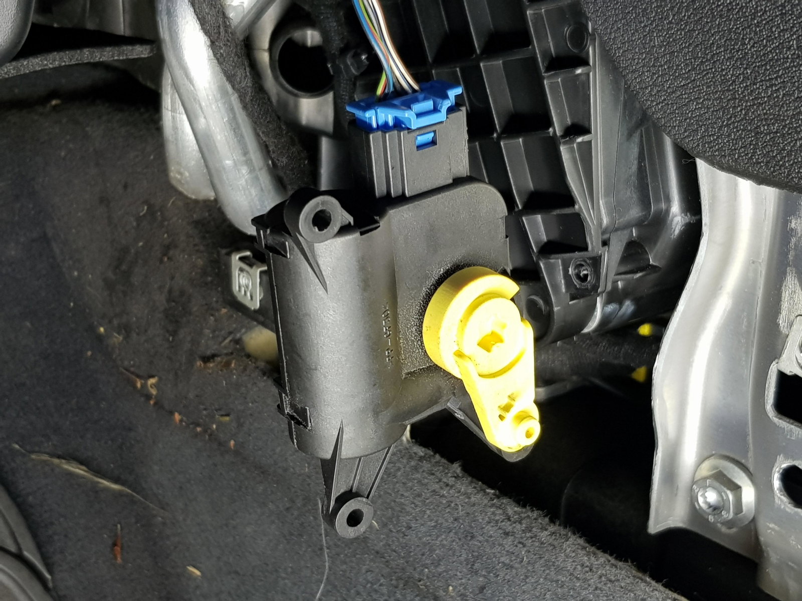

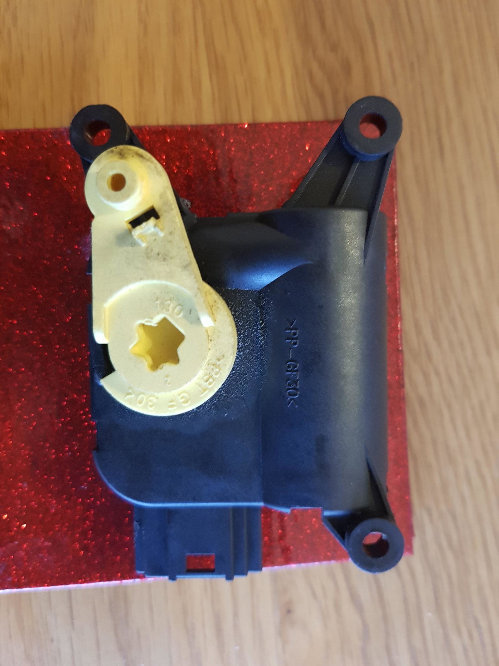

Hello all looking at the 2 silver pipes I notice the left hand side one gets boiling so you cant touch it but the right hand side one only gets just warm is this correct ? or is this a blocked matrix also ive taken the heater flap motor off and just to check it can anyone tell me how to check this with a multi meter please …
Just now, mortzz said:
On the first picture I re plugged it back in but no matter what I do with the heater controls the arm does not move , on the second picture the same thing the flap does not move , on the last picture the white cylinder moves does move up and down and I play with  the heater controls im thinking multiple failure's
Andrew.
If the hot and merely warm silver pipes are the heater inlet and outlet then something is definitely stopping the flow of water. Whether that is a blocked matrix or a seized water valve has not been established conclusively, but my money would be on the controls being faulty. Unfortunately I have no idea how to test it.
Thanks Cliff , with the bad weather today I could not get  under the bonnet to take off both matrix pipes and get a hose to see if there is any blockage , but I think there is issues as well with the flaps..

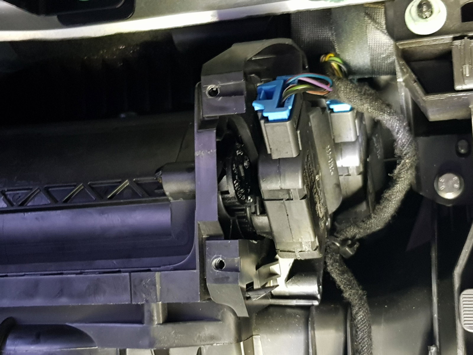

quick update on this guys ,, just to confirm that its not to bad a job getting the matrix out on a 2003 a3tdi s line 8p and also it comes out of the passenger side footwell not the drivers side, mine came out fairly easy once you pull the silver pipes off I personally would not use any tool around the silver pipes just get hold of them and pull them its a pain but doable ,, so I looked at just about all the electric flaps and tried them all manually and still no heat so just taken the matrix out , it seems to be full of little black bits so ive cleaned it as much as I could with boiling water then gone and bought  oven pride not the foam the stuff ,  you leave on for around 2 to 4 hours so will let ya know when it goes back in but I also think my radiator is not working as it should
Glad you're getting somewhere. I hope there's no aluminium in the matrix if you are using the caustic version of oven cleaner. (The less effective oven cleaners are just surfactants; the effective stuff contains caustic soda as well.)
im a tad fed up and unsure were to go with this as ive cleaned the matrix and a fair amount of little black bits came out and water flows through ok,  so after putting back on no change cold air,,, so im confused as the matrix pipes are hot in and out and it blows air out so why no hot... ive taken most of the motors off from the flaps to manually move flaps and still nothing … just don't get it... the only thing left is the Heater Control Valve as  in this..
