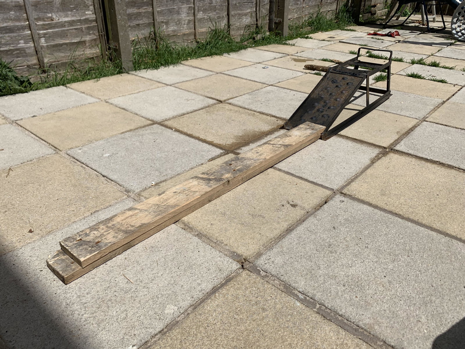

On 5/23/2019 at 1:32 PM, den9112 said:
Hi, i have the above car and i normaly do all my own oil changes on my previous cars via steel car ramps and always found it to be no issue ,however i have just tried to get the ramps under the A3 but they won't  go ,not enough clearence ,never thought i would have this issue so now i am looking for another way or if anyone as managed to do it via low level ramps then i would invest in a pair ...I also noted that the underbelly tray appears to be metal and not plastic with a few fasteners missing ,not sure what they are as i can't see them clearly enough..Any help would be apreciated ..Thanks
drive onto some wooden planks before the ramps,then onto the ramps
Share this post
Link to post
Tried that before ,very easy to slip using that method, i have done the job but i do like to get the front end as high as i can so may try for some ramp extensions for the next time .
Share this post
Link to post
Yes, rev the engine too much and the plank shoots backwards, dropping the valence onto the steel ramp. Only planks use planks.
