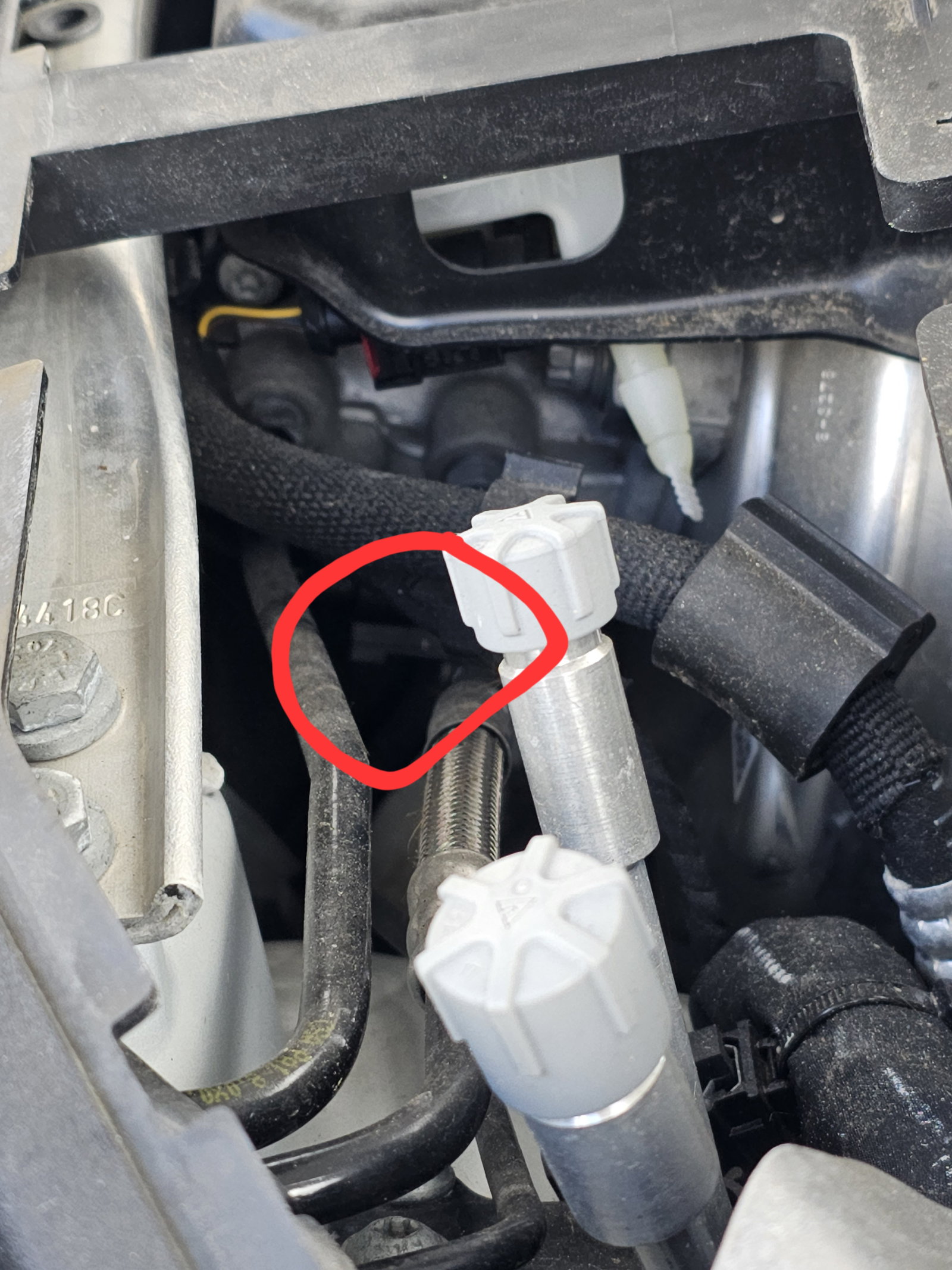

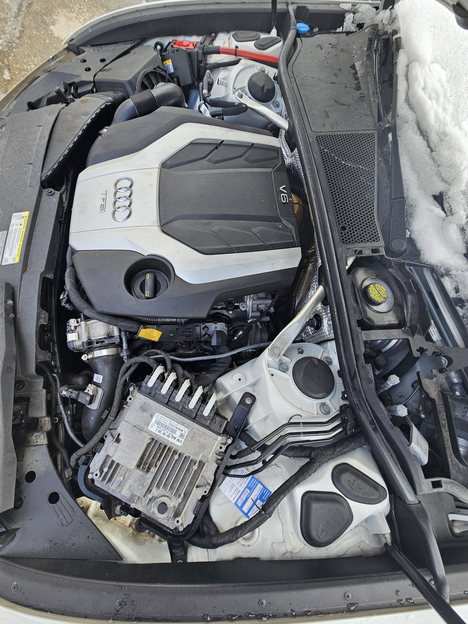

MarioVersus Posted March 2 Share Posted March 2 Hello I need help please , can someone share a photo or a video where is located the brake servo sensor on a Audi A3 e-tron 2015 204PS , I see that is very simple on an A4 but I can’t find anything for my car no photos no videos nothing I can’t find his location to see if I can change it myself , any help it’s appreciated! Thank you Quote Link to comment Share on other sites More sharing options...

MarioVersus Posted March 5 Share Posted March 5 Hi Steve , it’s nowhere to be found buddy , I’m guessing it’s electromagnetic brake servo and if it’s like this , there is nothing I can do 😬 but still I don’t know I can’t find any info anywhere… thanks Quote Link to comment Share on other sites More sharing options...
kh904 Posted March 5 Share Posted March 5 Have a look here: https://cardiagn.com/audi/ or https://www.car-repairmanual.com/audi/audi-a3/ 1 Quote Link to comment Share on other sites More sharing options...
MarioVersus Posted March 5 Share Posted March 5 Thank you kh904 , I will check 👍 1 Quote Link to comment Share on other sites More sharing options...
MarioVersus Posted March 5 Share Posted March 5 Hi kh904 , i found something but not sure if this applies to my model , it says its behind the air intake pipe , so i will have a look if that's the case and will update Many thanks 2 Quote Link to comment Share on other sites More sharing options...
