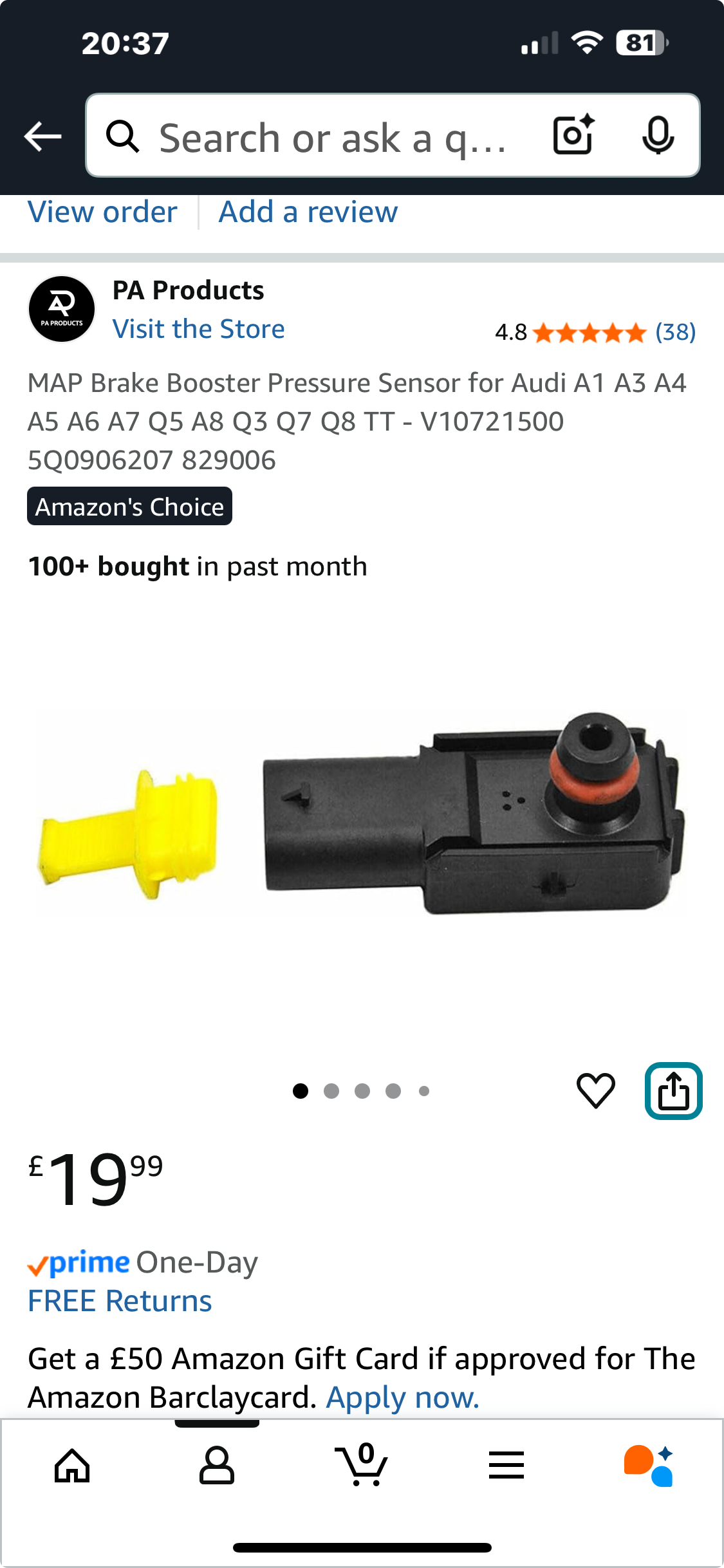

sorin s Posted April 28 Posted April 28 thank you KH904, is it the one advised a few messages up? is it the MAP Brake booster pressure sensor?
ian.f Posted April 28 Posted April 28 1 hour ago, sorin s said: Hi all, So glad I discovered this forum. 6 weeks ago, while reversing my 2016 A6 S line, my dashboard started to light like a Christmas tree, showing the following errors/faults: - stabilisation control (ESC/ABS): fault!, see owners manual - hold assist: unavailable - main beam assist: system fault - tire pressure: system fault! - parking brake! - Audi adaptive light: system fault! - brake servo restricted. You can continue driving. Please contact workshop. Since then, I probably did a further 500 miles and the car drives as normal...or at least I didn't feel anything suspicious with it; lights work ok, it brakes ok, steering wheel is ok, parking brake holds ok. Have any of you experienced similar? Do you have any advice? Thank you. I second, DO NOT DRIVE ANOTHER MILE! Yes, buy the sensor that’s listed in this thread and change it before you drive it again. I didn’t, and it cost me a fortune to replace & repair the subsequent damage.
kh904 Posted April 28 Posted April 28 1 hour ago, sorin s said: thank you KH904, is it the one advised a few messages up? is it the MAP Brake booster pressure sensor? It's the brake booster pressure sensor
sorin s Posted April 29 Posted April 29 Thank you both for the valuable advice. Just ordered one from Amazon; will share my feedback after I fit it.

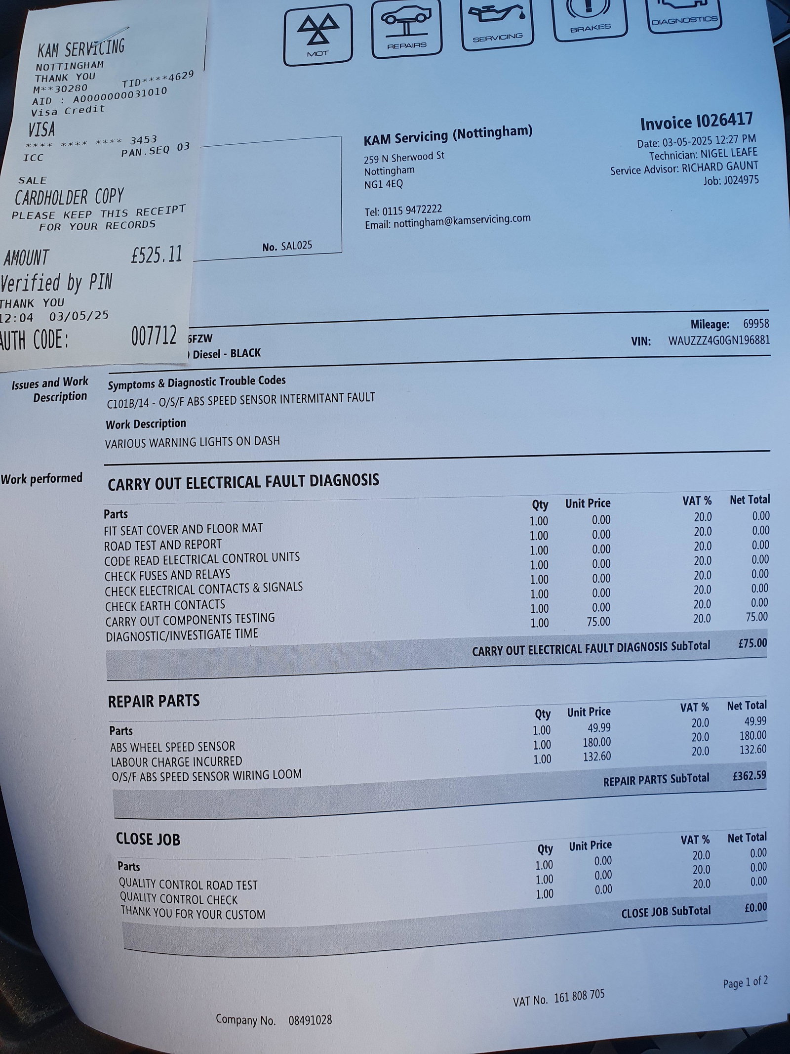

sorin s Posted May 16 Posted May 16 On 4/29/2025 at 9:31 AM, sorin s said: Thank you both for the valuable advice. Just ordered one from Amazon; will share my feedback after I fit it. Hi all, 2 weeks ago I bought the said sensor and installed it myself, however, the errors remained in the dashboard. Following that, I decided to take the car to a specialist and after they diagnosed it, it was found that the RHS front ABS speed sensor was faulty. After replacing it and running another diagnosis, it was found that the wiring loop for this ABS sensor was fried as well and that required to be replaced. In the end, it cost £ 525 to fix it. I attach the invoice to show the error codes, hopefully it will help others.
kh904 Posted May 16 Posted May 16 Ouch, that's made your wallet lighter. At least the ABS module wasn't bricked! Any idea how the wiring loom got fried?
sorin s Posted May 16 Posted May 16 What they said was that when the ABS sensor failed, the wiring loop got shorted... don't know what to say, I don't really trust garages/mechanics 🙂 1
