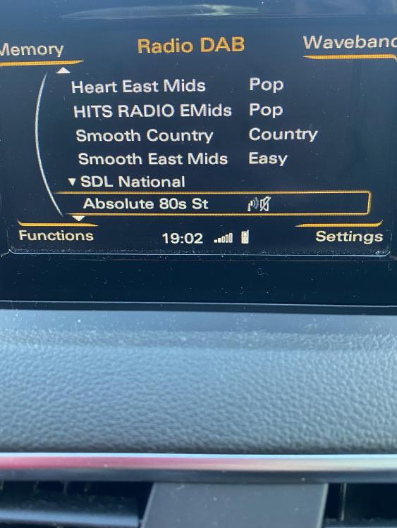

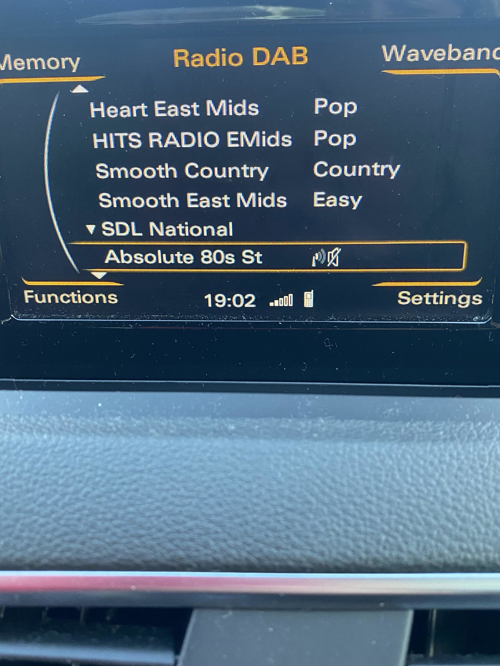

I've just had the same issue on my q3. All stations are there but the D1 National ones are not working, no sound then when you move the volume it shows the no connection symbol. The only one that works is classic which flips to FM. The BBC ones work on Dab though. Mine stopped working roughly last Saturday as well.

My audi q3 2018 SDL national channels stopped working? All other channels work.

So going to the control buttons,  select Car, Cetup MMI, then scroll to the bottom to Version Information.
Mine shows the version below.
I did try re-scanning stations like others have suggested, and only the local / non-national stations have come back into play.
@Mark A6 I have the same software version but an older navigation database version.
Is there a newer revision of MMI software that can be put on? Newer than RMC_EU_P16342?
