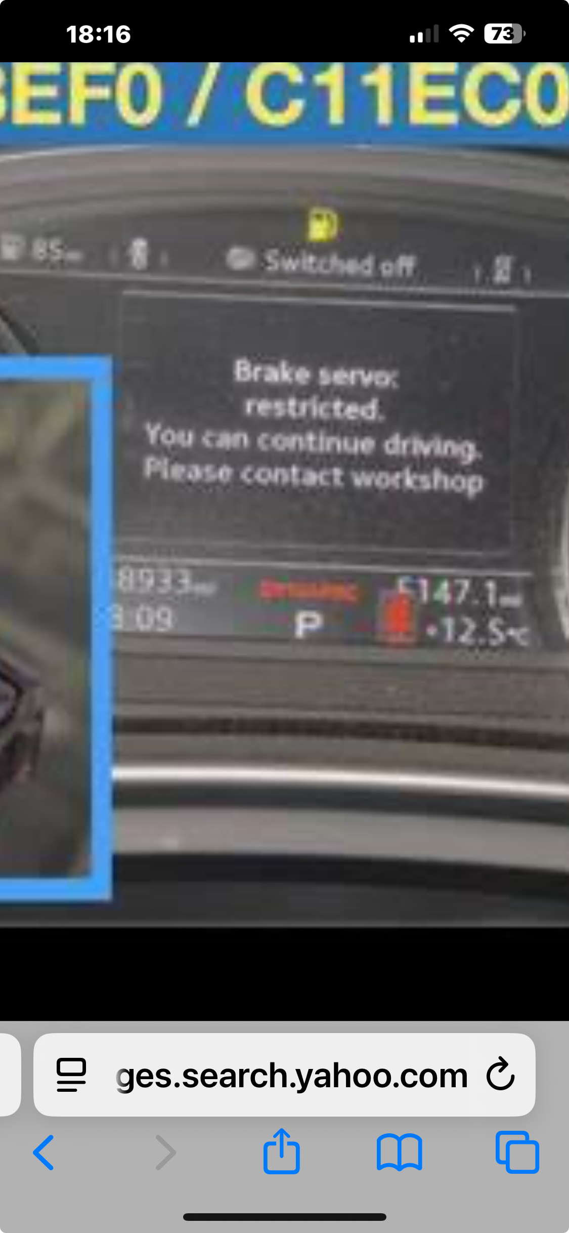

C11EC04 with the dash bit saying brakes restricted / start stop gone etc etc. It popped up as soon as I started the car and was after the car hasn't been used much in the last two weeks and perhaps nor for 3 days before that (seems common that if they sit the sensor dies). I drove it 10 mins and then came home as I knew it could brick the ABS eventually.

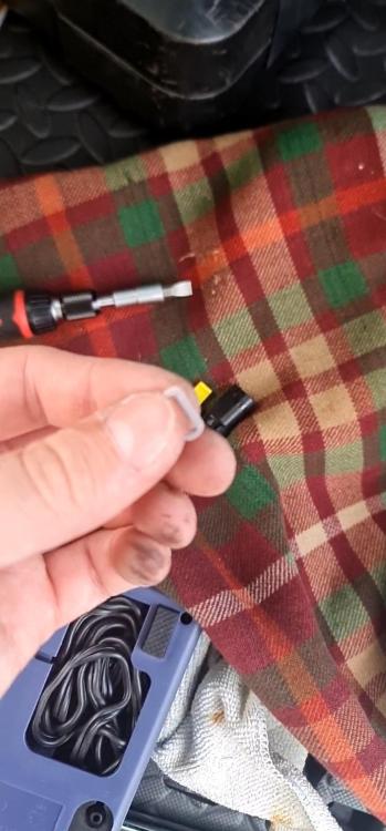

Long story short (haha) the sensor was not plugged in correctly. It was not quite seated enough. I removed the rubber seal (car side plug) and seated the sensor properly, this time making sure it latched fully. All cured.
To add, it was actually semi latching the first time and visually it looked normal, it pushed most of the way in and it wouldn't pull off from a small tug, making me believe it was properly on.
Before you mess around try using a needle and working the small white rubber water seal out, and making sure the car side clip is fully backed off then push the sensor on all the way, latch it properly (it shouldn't be able to be pulled out at all by any tugs) and then plug the sensor back into the car brake booster reservoir.
I knew before I started it again that the problem was solved. It just wouldn't yank off this time like I could before, and the short to gnd and pos suddenly all made sense.
