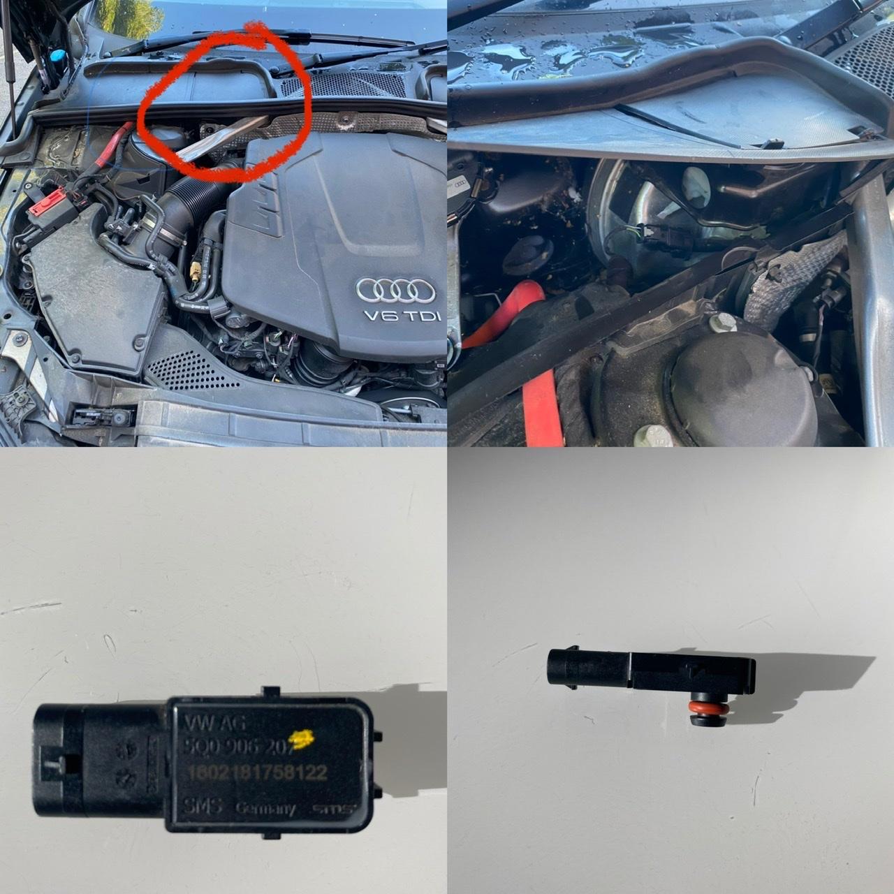

I had the same problem as others (‘brake servo restricted’ warning followed by a ‘stop/start not working’ message) with my 66 Reg A4 Avant TFSI which had only done 24,000 miles and was used only very occasionally during lockdown. Because the brakes still worked and the display message said I could continue driving I did so but only for a few very short journeys (and after the first time the ‘thud’ of the ABS kicked in I then made sure I applied the brakes even more gently) and intended to get it booked into an independent Audi garage (cheaper than main dealer) when convenient. However, after reading in the forum about the ABS issue (which clearly added urgency) and Simon Ryder’s report on how to change the pressure sensor I decided to give it a go without any further delay. My A4’s pressure sensor 5Q0906207(A) can be bought online for about £50 but as my Audi wasn’t on the website’s list of models that the part fitted(!) I decided not to take a chance and instead bought it direct from a main Audi dealer for £75 incl. VAT (as this meant a 40 mile round trip I paid £4.99 + VAT for it to be posted to me although the postage only cost the dealer 65p). I’m no mechanic but it was really easy to change, took less than 5 minutes, and everything is back to normal. I’m just so relieved that I was able to sort it for £75 plus postage AND before the ABS became an issue, so two fingers to Audi and a big THANK YOU to Simon.
On 8/20/2020 at 9:06 AM, Simon Ryder said:
Hope this helps.
I’ve circled in red the area of the sensor. It’s under a plastic flap. You have to pull the rubber edge off to lift up.
The sensor pulls vertically off. You then slide a plastic holding clamp off the other end. Just reverse the process to put the new one back in. It’s really simple and annoying that everyone seems to want to charge a couple of hundred pounds for this??!?
Hi, I was given a £120 diagnostic fee and whatever the cost of repairs, using the description given in Simons post I ordered the part from a dealer $75 (inv VAT), I have waited 2 weeks before reporting the results in case something didn't work after I replaced the sensor.
I pumped the brake to equalise the pressure, clean the area from dust and dirt (seemed the right thing to do as I was going to expose the servo pressure mounting to the outside), unclipped the electric cable, used a small flat end screwdriver to twist the clips over the small lugs you can see in Simons photo (bottom left), as I was doing this I applied pressure by pulling the sensor away from its mounting and it came away with ease. To replace  just line up the sensor apply pressure and it will click into place, attach electric cable.
Both warnings have gone and all feels and looks serviceable. Hope this helps others, Thanks Simon.

I have had the exact same problem, thanks to this post I didn’t continue driving and may have  saved a costly repair to my ABS system!
I checked the sensor data using VCDS and it showed an error on the brake booster pressure sensor. Replaced the part with a genuine part from Audi Edinburgh (£74.10) and now all is well, phew! Same part number as mentioned previously and was delivered in 2 days.
If it helps, my car is an A4 Avant Ultra 190 S-Tronic with around 80k miles.
Thanks again!

Hi C87,
Just to check whether the booster sensor you replaced is the same as the part photo that Simon showed in his post?
I am still waiting for my appointment with Audi and it’s frustrating as I can’t even use my car. I am tempting to replace it myself now.
Look forward to your reply. Thanks.

Big Shout Out to this forum and to Simon Ryder👍👍
Like most on this thread I hadn't used my Audi A4 Avant 3.0TDI Sport 66 plate much over the last 6 months. It's our second car and only done 10k - So like a new car.
Yesterday after using the car for first time in a couple of months the brakes were a bit sticky but freed off after a few miles. To be expected sometimes after a lay up. About 20miles on I got the Brake Servo:restricted warning alarm. I Drove to my destination about 10 miles further and parked. On starting up to travel home The Brake Servo & auto/start Stop warning showed. I drove home gently and parked the car.
Luckily I found this thread and first thing this morning went to my local Audi parts department and purchased the Brake pressure sensor 5Q0906207A for £74.10. The old sensor was 5Q0906207 but the new one by a different manufacturer has an A on the end. The Audi parts guy confirmed it was the correct part. I informed him of this thread and potential to damage the ABS system. He said they stocked a few sensors so that would suggest they get used often🤔
Following Simon's guide I had the old sensor exchanged in a couple of minutes. Small flat screwdriver to unclip the side catches and pull back the gray locking toggle on top of the electrical sensor. Pumped the Brake pedal a few times and started the car. The Brake Servo restricted alarm disappeared but the autostart stop disabled warning still showed. I turned off the engine and waited till everything was off and dash blank. Then restarted the car and the auto start stop warning also disappeared. So success thanks to this thread and Simon's guide. It does feel like a win and no damage to the ABS system so over the moon👍😁
If you have a 66 plate Audi and come across this thread I would seriously consider swoping the sensor before you have a failure and possible bill for an abs system pump.
Thanks again
Chris
Hi All,
Just to update, I purchased a brake pressure sensor from Audi dealership for £74.10 and replaced the broken one in a couple of mins. All the error messages were gone. Big thank you to this forum and to Simon Ryder for the instruction. Clearly this is the way to do it when the error messages first appear.
Please take care everyone.
J
I have the same problem on my 2016 A4 having done 21,000 miles. I'll be searching for the replacement part asap.
Many thanks to Simon Ryder and to this forum !
The number on my failed sensor is 1606060544094 so the manufacturing period spanned at least two months. I guess that many more Audi owners are about to experience the same problem.
So yet another sensor gone. Mine has 26k on the clock 2007 A4. The sensor came on in June and stayed on for a few days whilst I was away so unable to take it back to the dealer I bought it from. When I booked it they couldn’t see me for a week, during which time the fault self rectified and the warning stopped. I took it in to the dealer( not an Audi main dealership) they plugged it into the diagnostic computer and said that there were no faults recorded. He said the sensor may have got wet when the car was pressure washed and not to worry, just bring it back if it comes back on. About a month later and 1 week after the 6 month warranty it comes back on! I needed the car for work so drove it back and forward to work having no idea that this sensor fault was going to cause significant damage to other parts of the braking system.  I took the car into my mechanic last week who repl@ced the sensor for £100 but has suggested I try and get the rest of the work done by goodwill at Audi or the garage I bought it from as the servo now neeeds replaced at an estimated cost of £500-£600!
