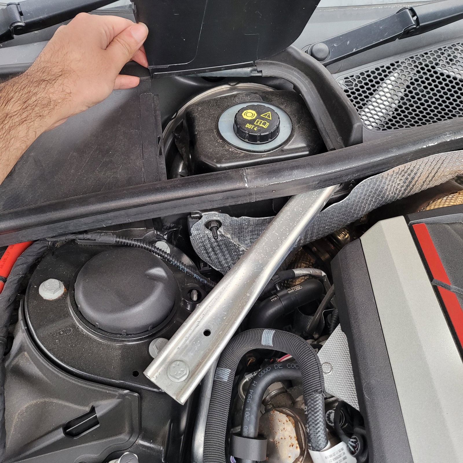

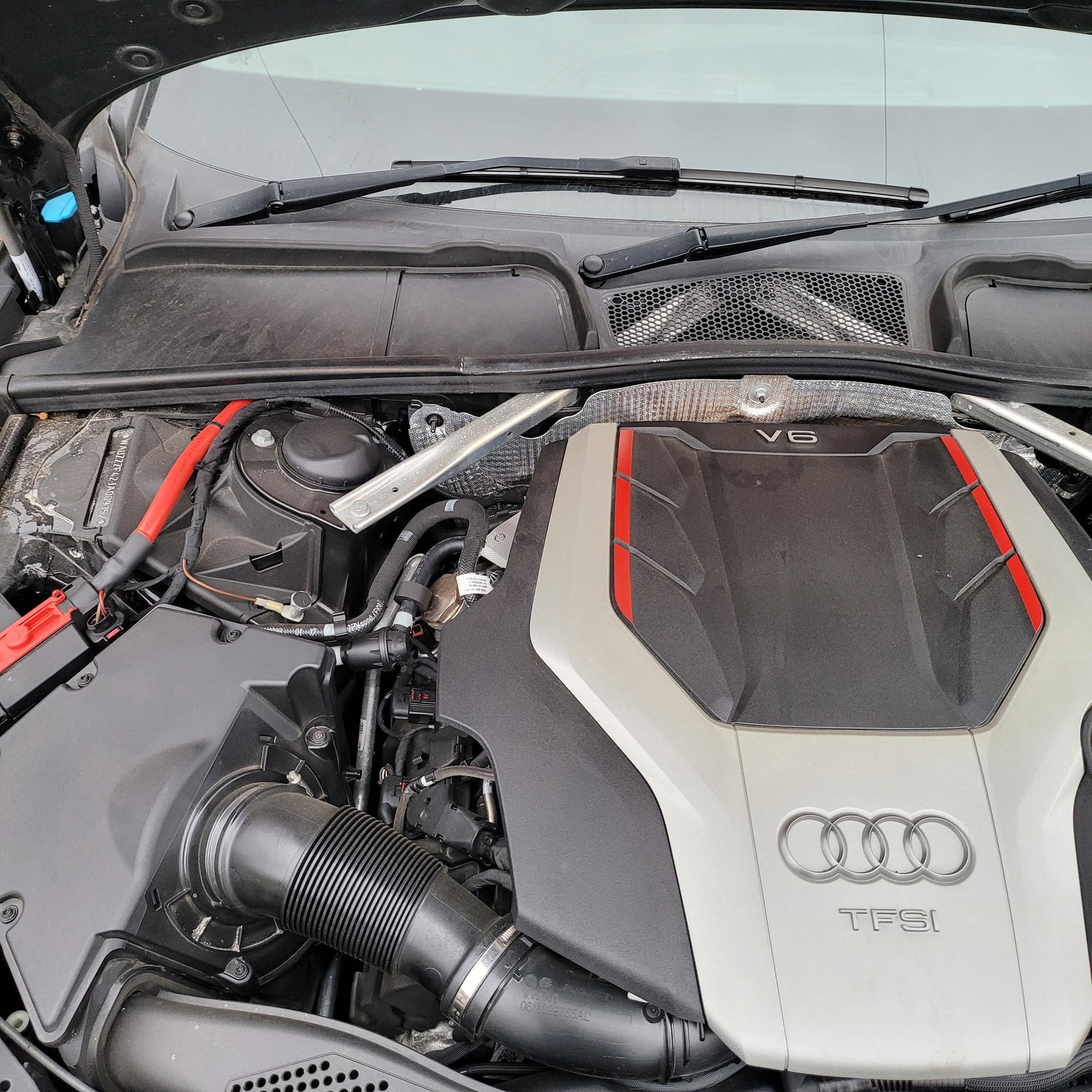

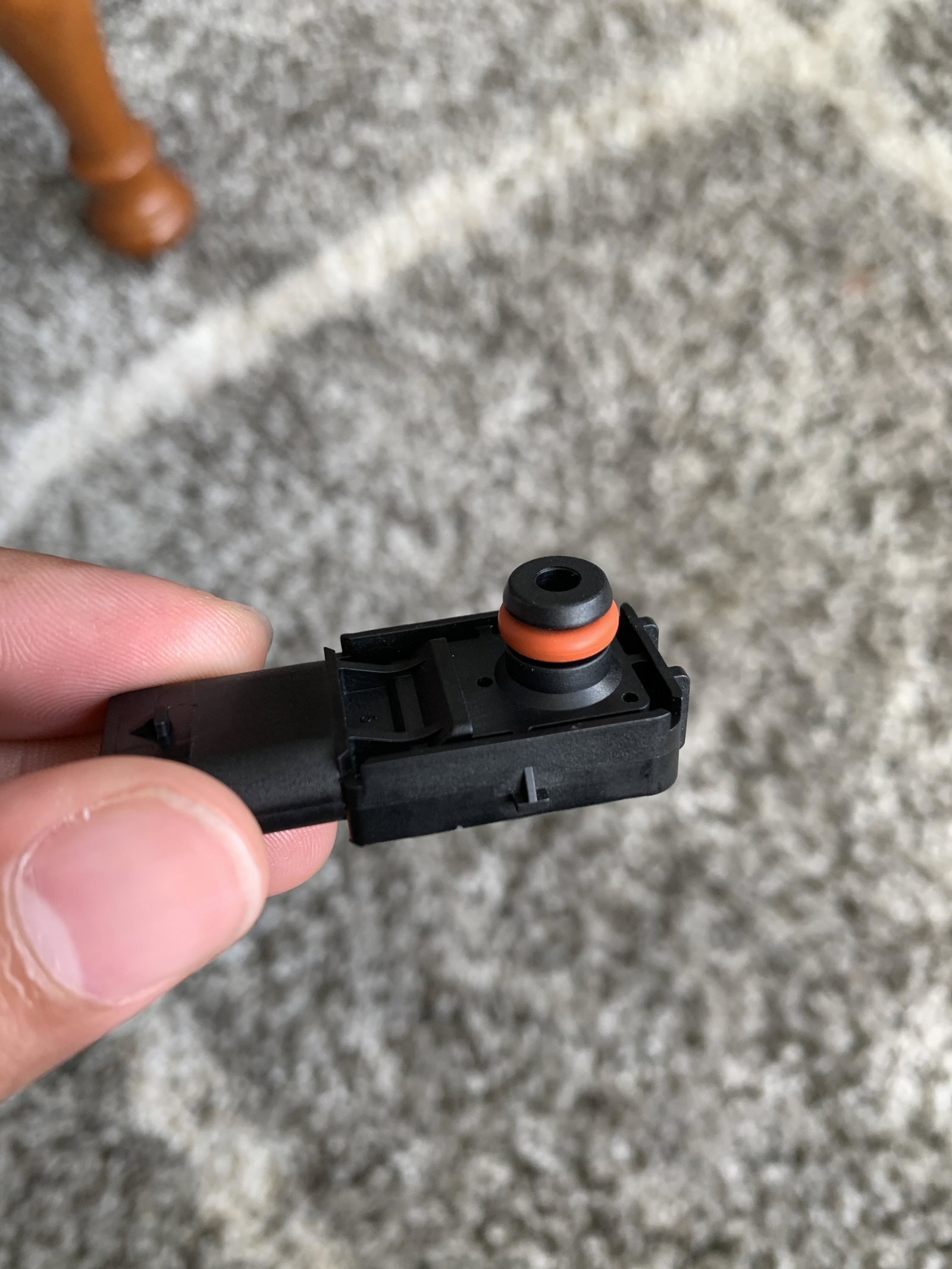

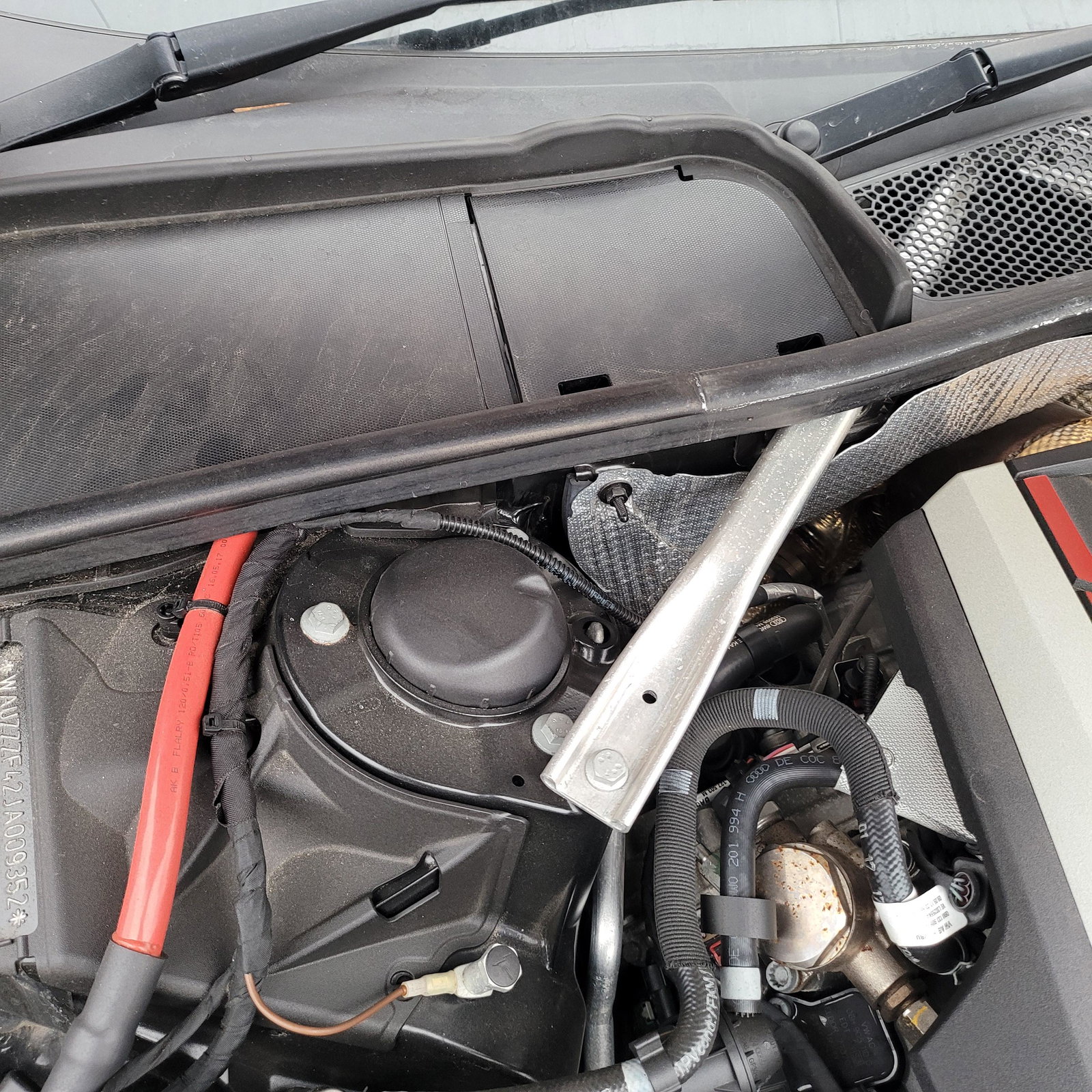

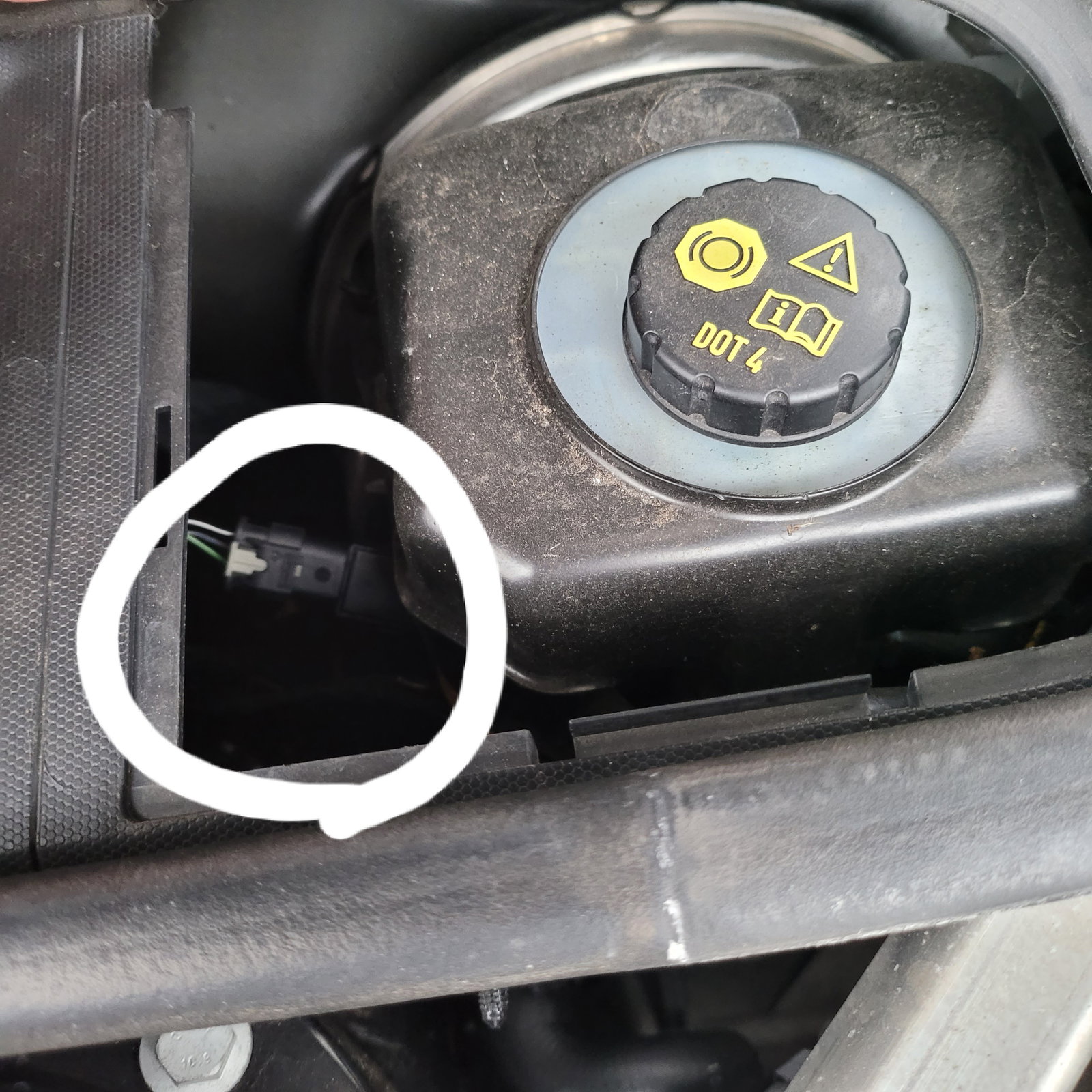

Just want to thank u everyone for the post's save over £100 by just buying sensor my self and without paying any money for labour and diagnostics.
I have attached some images please see and solve the issue your self if you can.

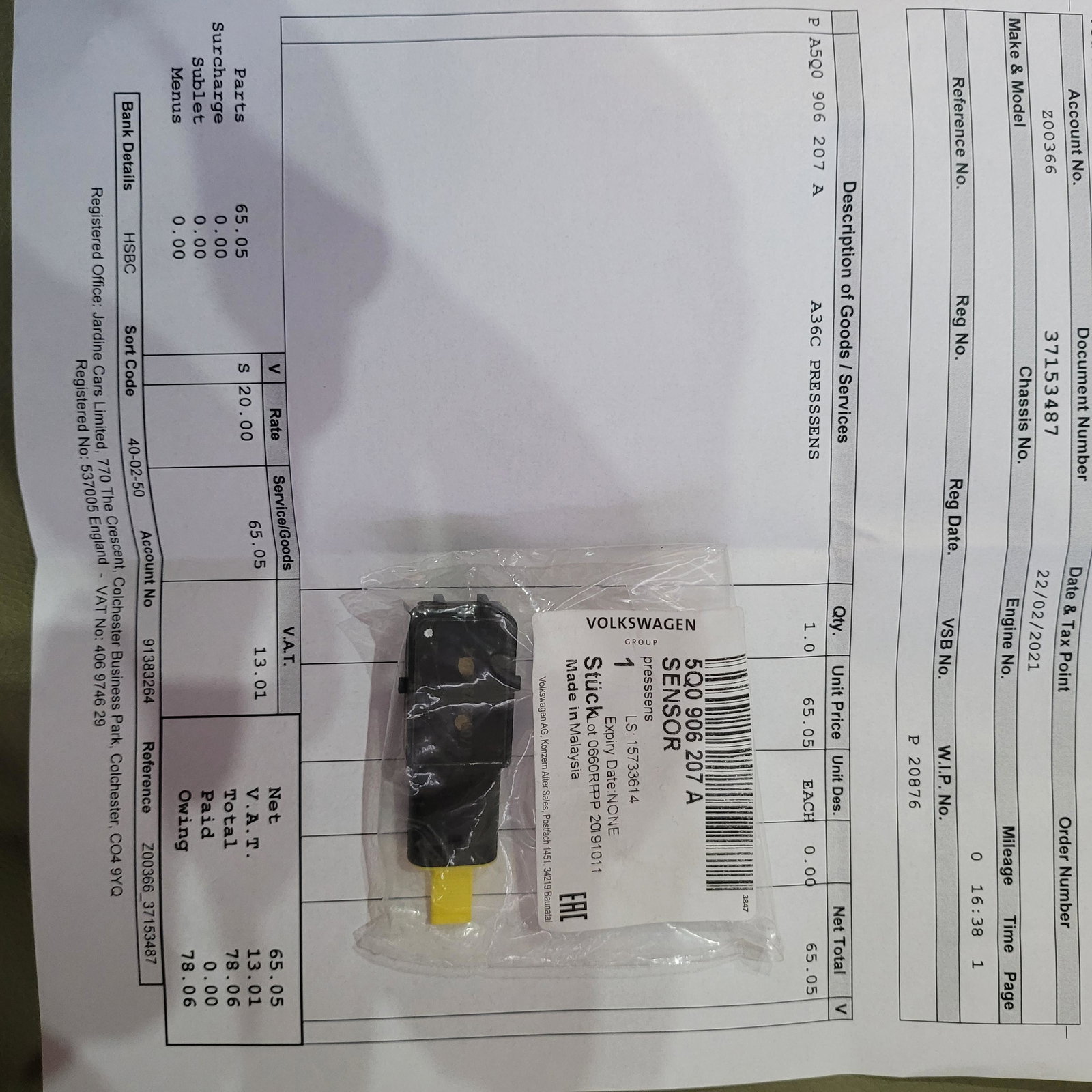

Hi Giuseppe do you have a part number at all?
I have a an Audi A3 64 plate- I have rang Audi and they want to know where I am plugging this into and apparently this part doesn’t exist.
Can anyone let me know what the specific ‘key words’ are to say to let the part department know which part I am looking for 😞

The part is listed through the forum, thats the code i used, there is also a picture with the full code, thats the one i ordered, giuseppe
