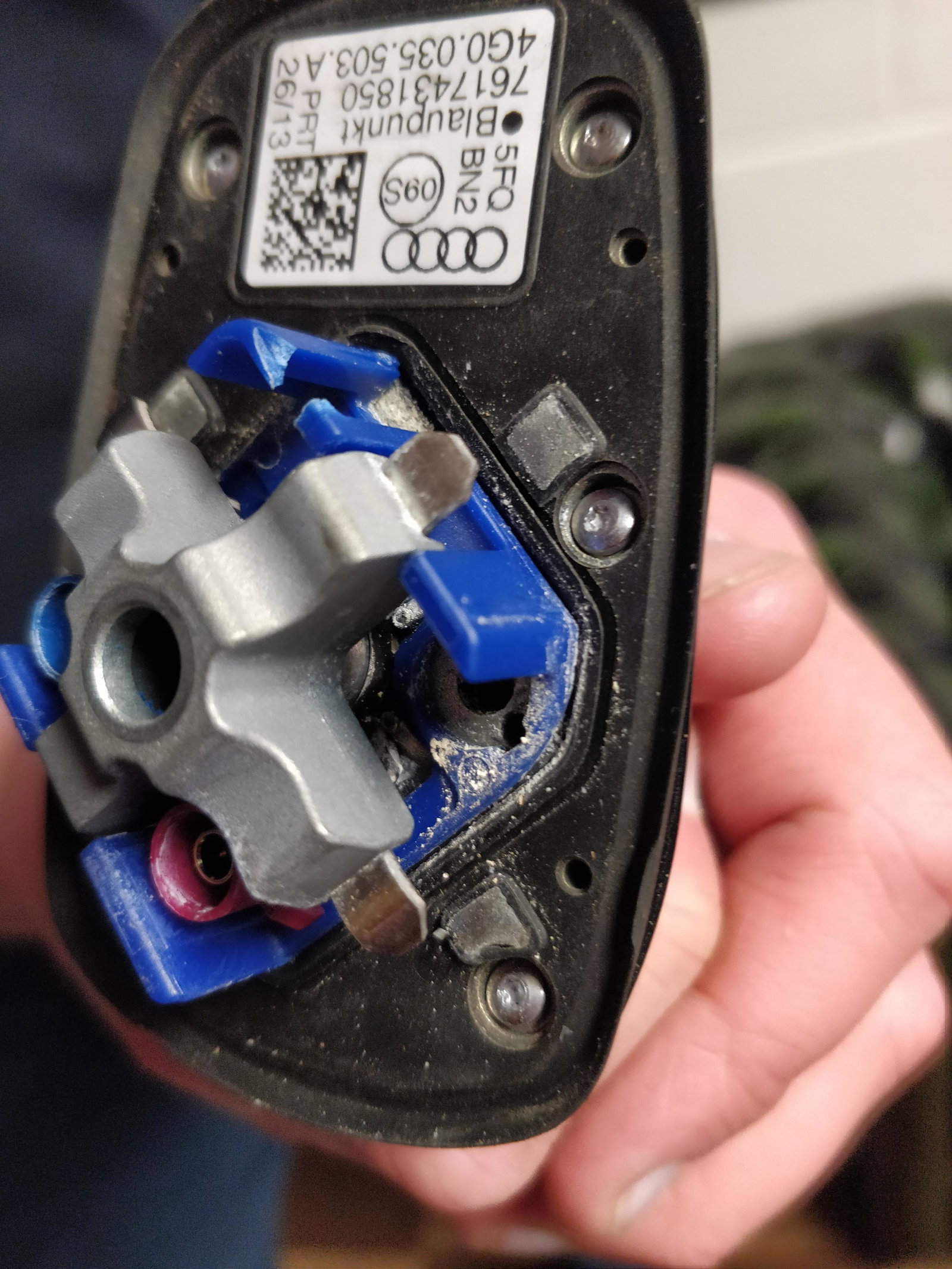

Gareth,
All done - it WAS the GPS fin. Local garage fitted a new one, the old one was corroded inside. Why Audi didn't check that when it came up on the scan!!? N A completely clear scan now...nothing at all.
Amazing how water ingress into the fin caused a bevvy of issues.
