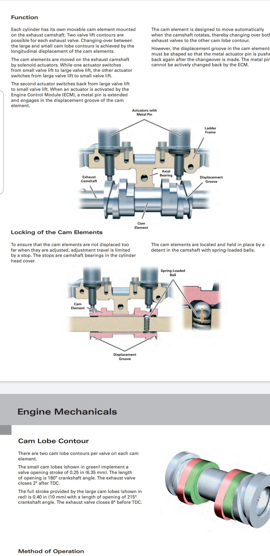

Daviemac Posted July 26, 2020 Share Posted July 26, 2020 Hi All I lost 2 of these spring and ball bearings (picture attached )and am trying to save myself from buying a whole camshaft because theres nothing wrong with it.Anyone have these or know were I can source them from. cheers Davie Quote Link to comment Share on other sites More sharing options...

Daviemac Posted July 29, 2020 Author Share Posted July 29, 2020 50 minutes ago, Steve Q said: It's in the right section. My advice would be to speak to Audi or a vag specialist. Hi Steve I have Spoken to local audi dealer there say part is park of the camshaft and not separate, so not ideal hoping some had a broken camshaft or something to just take them from but dont seem like the case cheers for the reply Quote Link to comment Share on other sites More sharing options...
