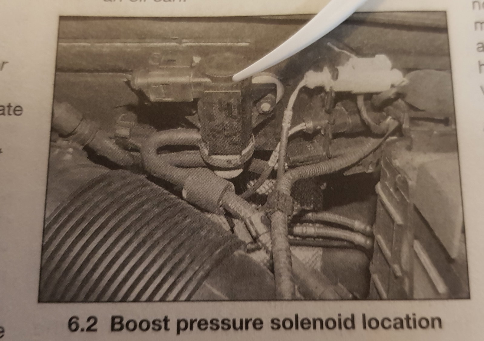

Thanks for your advice, however being a newbie not too sure if I am looking at the correct MAP/Boost sensor on the intake manifold side, as you said in your reply.  I only have an HAYNES manual to go by.
May I ask if the attached picture from the manual is the boost sensor in question white pointer, pointing at it.
Also is it easily accessible to disconnect and remove, to identify the product number to buy a new one to fit. As there appears to be many types or can you recommend one such as Bosch from eucarparts or replace with an Audi one?
Much appreciate if you can advise me on this DIY or would I be better asking a garage to replace it with a new sensor?

Hi sorry for the late reply, the picture you supplied is indeed a boost sensor, if yours looks like that you are in, either way scrub the dirt off and get the part number then go fishing on eBay plumb in the Audi part number and it will give a good range of choices this way it will be a lot cheaper than the thieving scrotes at Audi or Eurocarparts.
I am pretty sure that this item is plug in and play and won't need coding, I will check, if you have a problem deciphering which number is the part code either post a picture of your cleaned part so I can see the numbers or email me the VIN for your vehicle and I can't the number off of my system, Do not remove the old part until you have a new one as the pipes can be awkward to remove because they are crusty and may need persuading with a bit of hot soapy water
