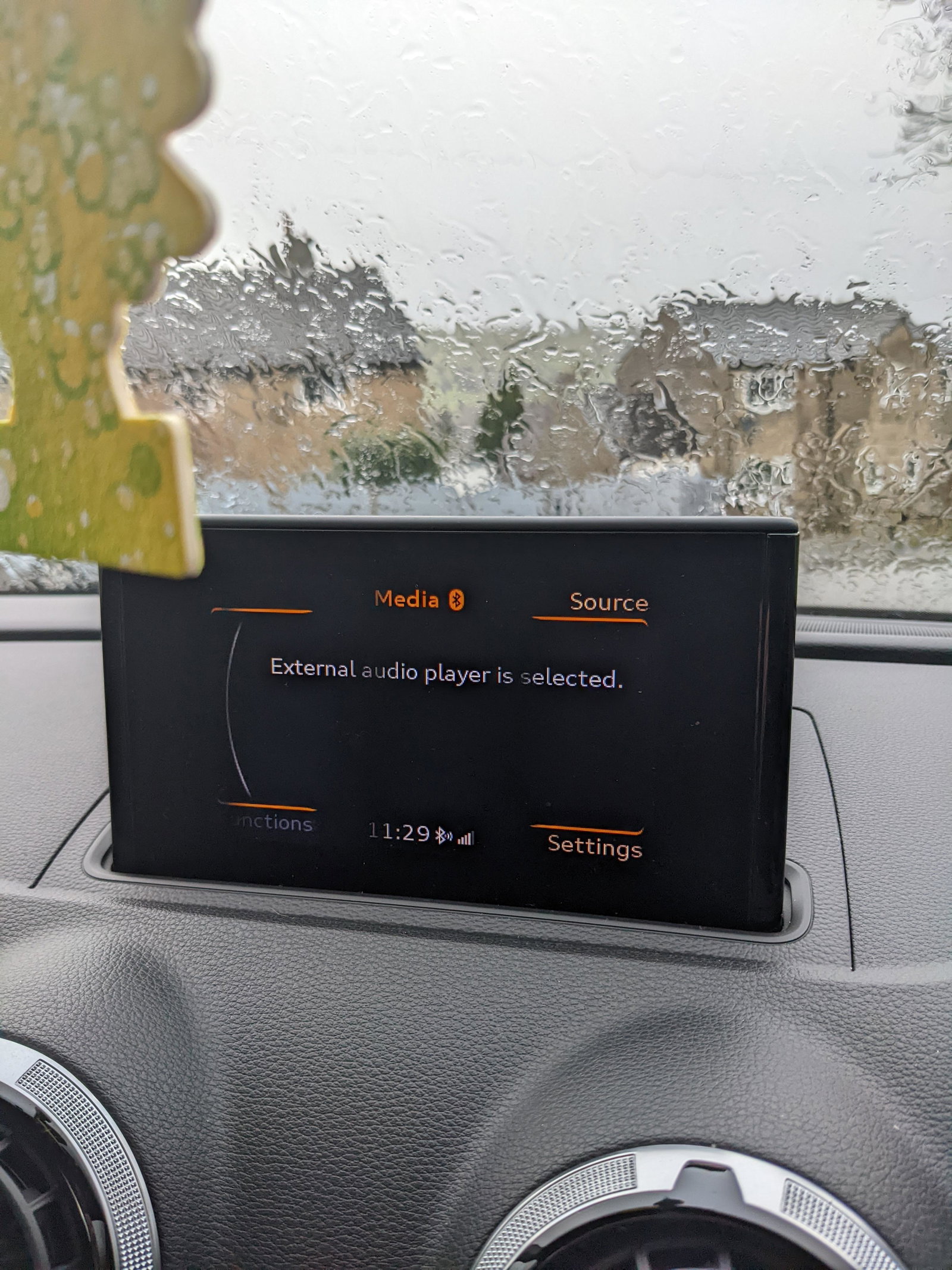

Just bought an A3 I can connect to the phone to make calls and everything it will play songs through Bluetooth but won't let me skip songs with car control and have to do it through the phone. Searched the net high and low can't seem to find a fix.
I have enabled all Spotify Bluetooth permissions and other permissions. Really bugging me.
Also doesn't display what's playing just 'external audio player is selected' but that's not really a big issue

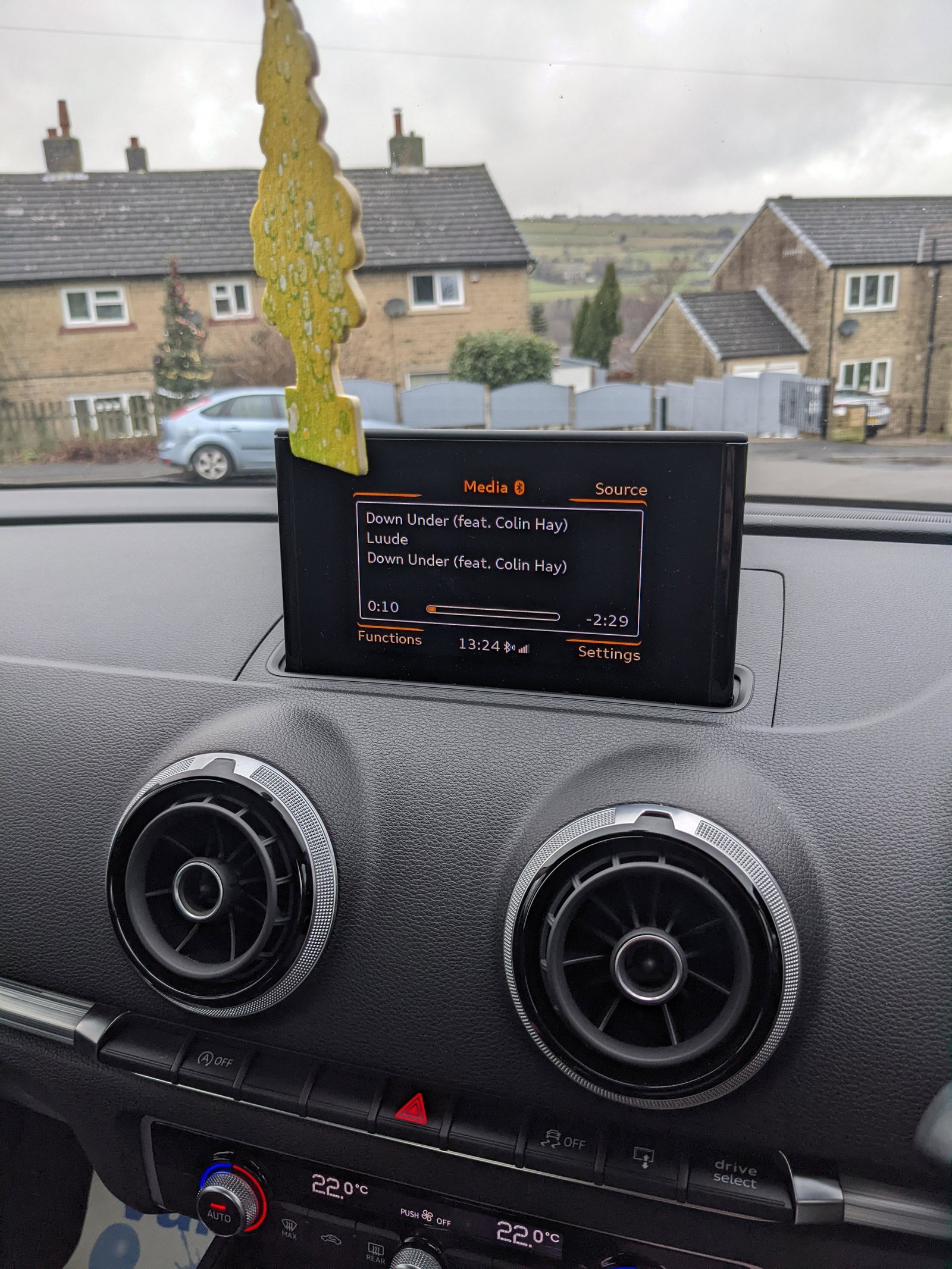

Hey mate got it sorted. It's a problem with Android. If anyone else is in the same boat. Unluck your developer options by going to settings > about phone > tap on build number until it says developer mode active. Then go back to settings > system > developer options > Bluetooth AVRCP version > change to 1.4... sorted!
