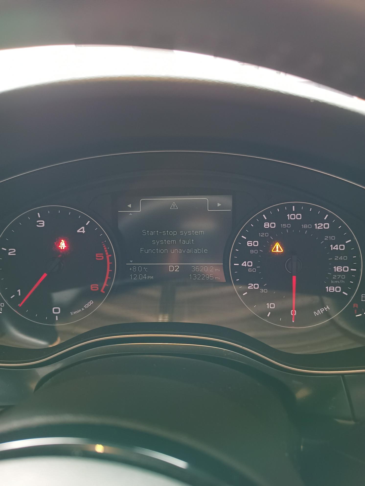

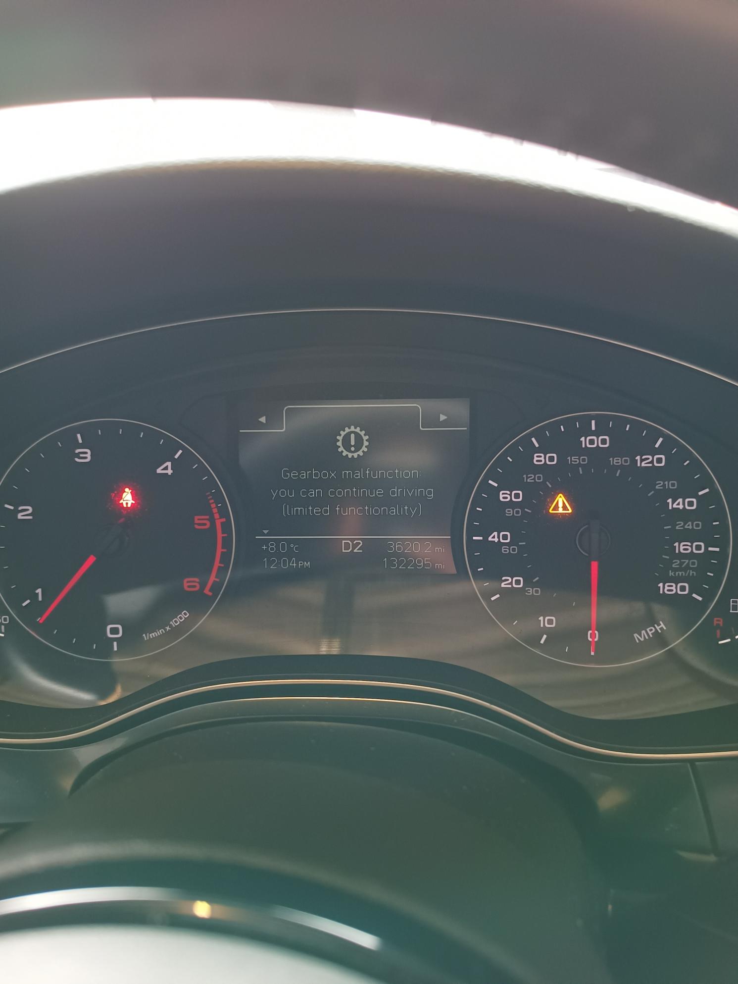

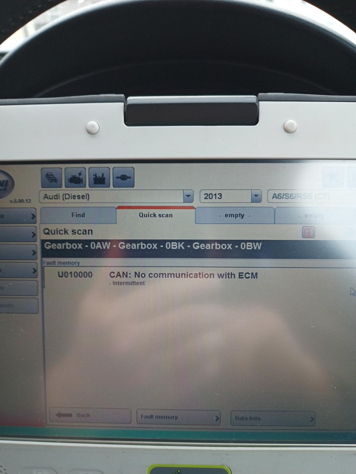

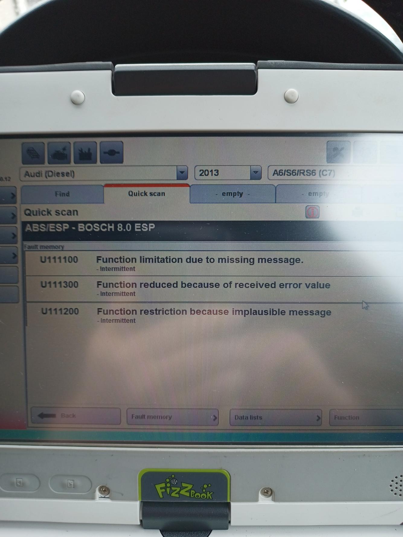

Kev555 Posted February 18 Report Share Posted February 18 (edited) Wife was driving the car last night and message flashed on cluster " Gearbox low oil pressure" or similar (it was the wife driving so limited observance) also in conjunction with the handbrake and possibly ABS warning light and another orange triangle? As this all happened the car became stuck in third gear. She managed to manually shift the gears for a bit and it went back to normal. Unfortunately she switched it off when she got home and when I started it and took it for a run the car was faultless and no warning lights. I pulled these codes from it today. They all cleared again, I looked online but it could be anywhere from a relay or ABS sensor issue to possibly a loom/gearbox issue? any techs out there could point me in the general direction? I realise these are fairly generic codes but I did clear a previous rear wheel speed sensor issue when I first plugged the laptop in a few weeks ago which hasn't come back yet. Edited February 18 by Kev555 Quote Link to comment Share on other sites More sharing options...

Kev555 Posted February 18 Author Report Share Posted February 18 4 hours ago, Stevey Y said: Hi Kev the battery if knackered will cause all sorts of problems and yes its in the boot, rule of thumb is never replace any part based on a U code and the other question is has the gearbox ever had a service, the problem with Delphi software is its a shade vague on descriptions of faults but intermittent looks very much like the battery, if you get a new one regardless of make it must match the original unit in every specification, physical size and cranking amps etc and it will need to be coded to the car or you will kill the new unit in record time. Steve. I'm using the Wurth Wow software ATM Stevey as its the only software I have can interrogate the the Audi to pull any decent codes. Your right, the Delphi just doesn't pull the codes, not really compatible with VAG. Quote Link to comment Share on other sites More sharing options...
Stevey Y Posted February 19 Report Share Posted February 19 17 hours ago, Kev555 said: I'm using the Wurth Wow software ATM Stevey as its the only software I have can interrogate the the Audi to pull any decent codes. Your right, the Delphi just doesn't pull the codes, not really compatible with VAG. Hi Kev try gabbing OBD Eleven it pretty good even at entry level and is definitely VAG specific and has a fearsome amount of options regarding re adaption/ coding and has invasive interrogation on the pro version, have a read up on the internet before choosing which version there are guys on here using it with good reviews. Last but not least when changing the battery have another spare battery connected to the jump points under the bonnet as this will provide power continuity when you disconnect the old unit and stop things like the window operation and central locking losing their adaptations, just remember to be very careful with the red lead on the battery as it will still be hot from the donor battery voltage, I found wrapping a marigold glove round it when disconnected normally stops it touching things it shouldn't. Steve. Quote Link to comment Share on other sites More sharing options...

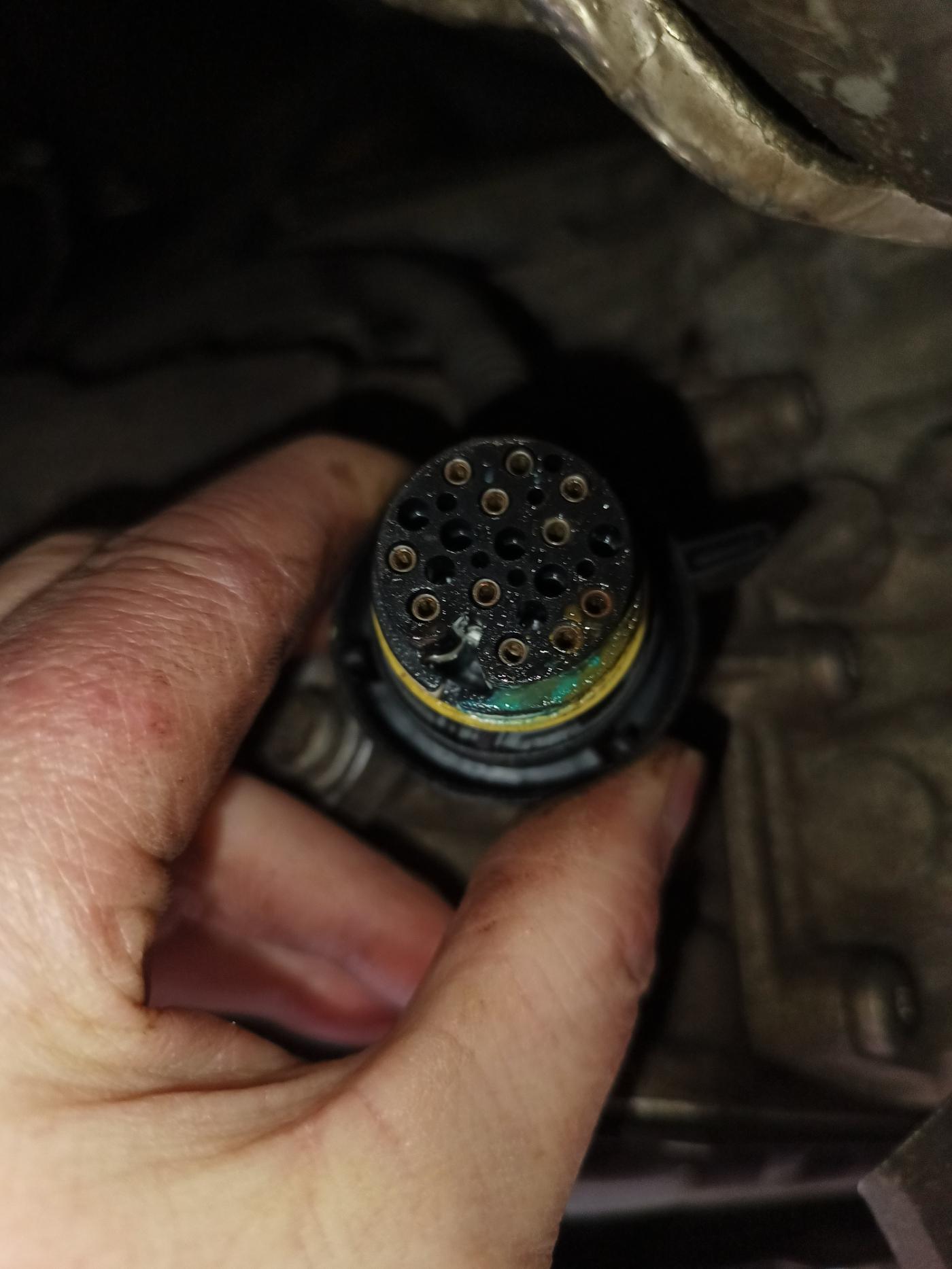

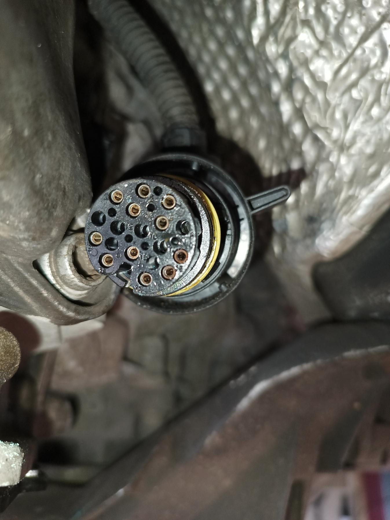

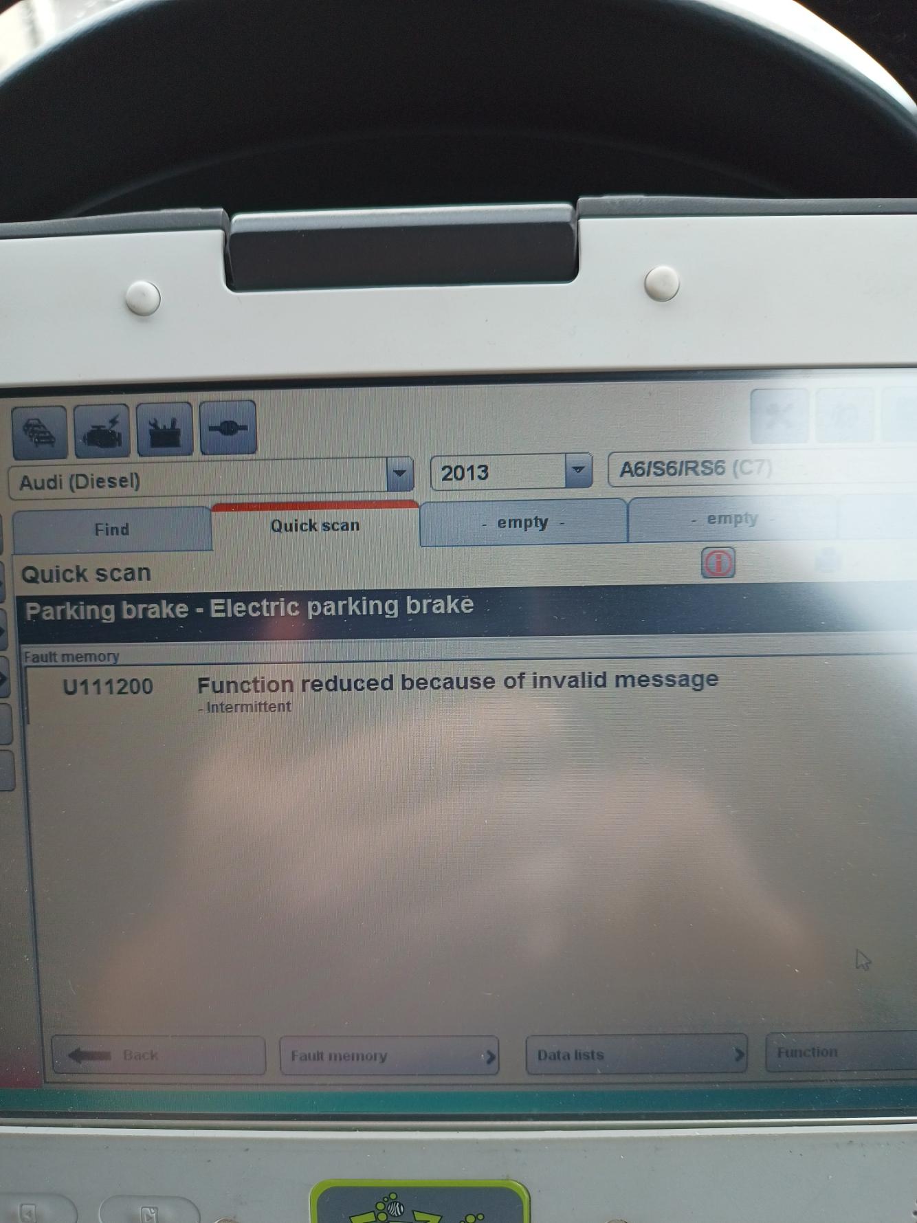

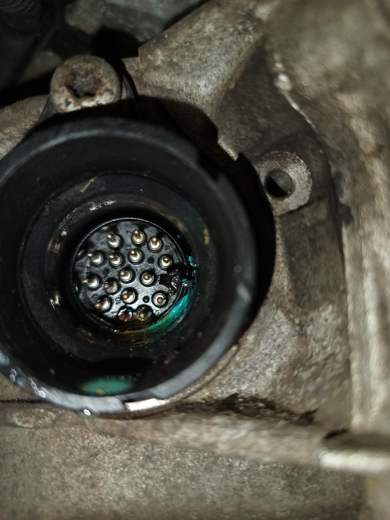

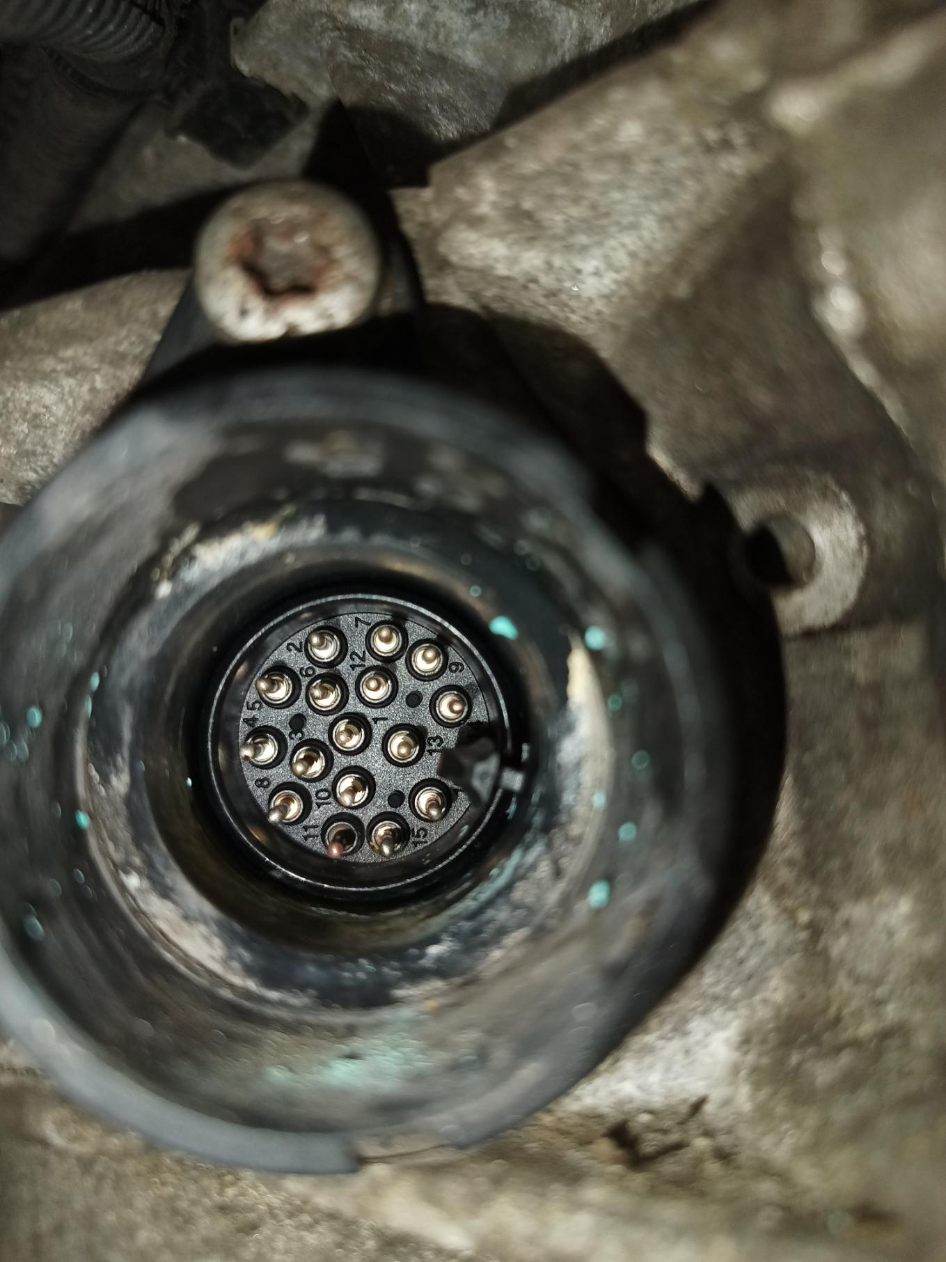

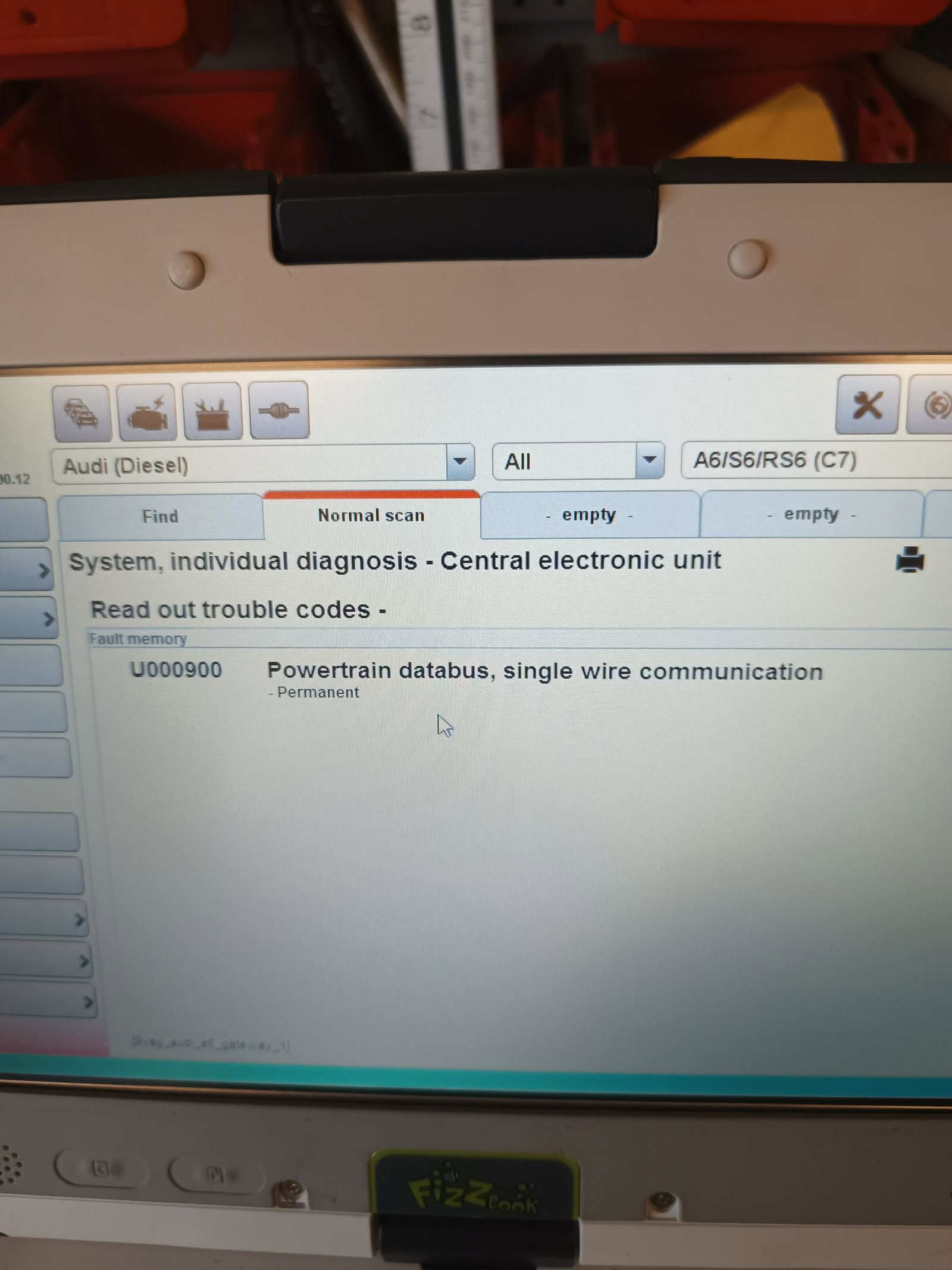

Kev555 Posted February 28 Author Report Share Posted February 28 (edited) Took the A6 in to do the gearbox service today and the intermittent gearbox error finally showed up on the dash for me instead of the wife. Funnily I could replicate it then by bumping the car over the lift plates. I was suspicious of water ingress or a broken wire the way the fault arose bumping in and out of the garage. So I took the gearbox plug off and it was corroded but pins are all in good shape luckily as its in the early stages. I still have a permanent fault code ATM on the car which may be related to the battery as its a U code and hopefully not linked to the transmission. Any info would be useful on that code. Whats the reason theres water in that plug as its not following the loom into the plug that I can see? I just hope the water hasn't blew the mechtronic unit pictures posted below Edited February 28 by Kev555 Quote Link to comment Share on other sites More sharing options...
Kev555 Posted February 28 Author Report Share Posted February 28 Gave connectors a clean up with electrical contact cleaner so looking better. Quote Link to comment Share on other sites More sharing options...
Stevey Y Posted February 28 Report Share Posted February 28 2 hours ago, Kev555 said: Gave connectors a clean up with electrical contact cleaner so looking better. Hi Kev, good find and judging by the corrosion/water ingression that would have given problems sooner than later, think because the databus is a single wire its just had a problem with communication and won't have blown the mechatronic unit as that would be a different code, the reason for the water is probably after ten years the plug seal is a bit tired, you can usually help it out with a good coating of silicone grease, with the software you have it should clear the code but if it won't after the fix try driving it a few times if it was the plug it will cycle the fault out. Steve. Quote Link to comment Share on other sites More sharing options...
Kev555 Posted February 28 Author Report Share Posted February 28 Thanks Steve I was actually looking up why this happened to the plug when you answered. So its nothing to do with transmission oil cooling valve thats documented online as causing this issue? Thanks for clarifying that code does relate to the transmission electric plug. Quote Link to comment Share on other sites More sharing options...
Stevey Y Posted February 28 Report Share Posted February 28 12 minutes ago, Kev555 said: Thanks Steve I was actually looking up why this happened to the plug when you answered. So its nothing to do with transmission oil cooling valve thats documented online as causing this issue? Thanks for clarifying that code does relate to the transmission electric plug. Hi Kev, I wouldn't have thought so as any specific code would flag up that failure, the best bit of advice I ever had from the guy who taught me the basics of diagnostics on my first Ford Eighteen years ago was, you never replace anything on the basis of a U code as it is sort of generic and covers a communication issue between two or many parts, P codes are specific but still may lead to multiple parts as most systems are daisy chained and one sensors failure can lead to other sensors registering as failed, example, on the codes given for a MAP and MAF failure its normally the MAP thats gone sideways as it lives in a hot grotty environment which is my point with diagnostic platforms the generic platform may throw codes for the two sensors but manufacturer specific software will tell you there is no correlation between the MAP/MAF which narrows it down and more digging will reveal which sensors not working on the live data. Quote Link to comment Share on other sites More sharing options...
Kev555 Posted February 28 Author Report Share Posted February 28 Yes Steve ive learnt that before at my peril LOL. I take a bit more time nowadays to find out if its exactly that part thats relative to the code. Good to know you think its not the coolant valve. I did smell the water in the plug today but no scents came from it to lead me to believe it was anything other than just water. Quote Link to comment Share on other sites More sharing options...
