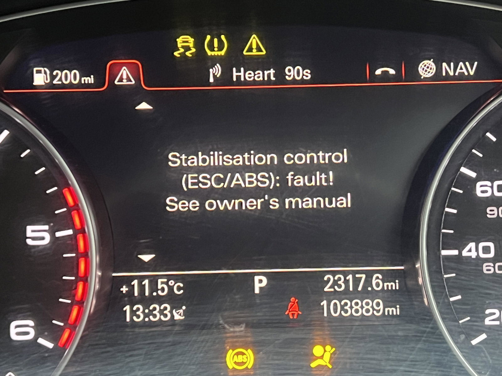

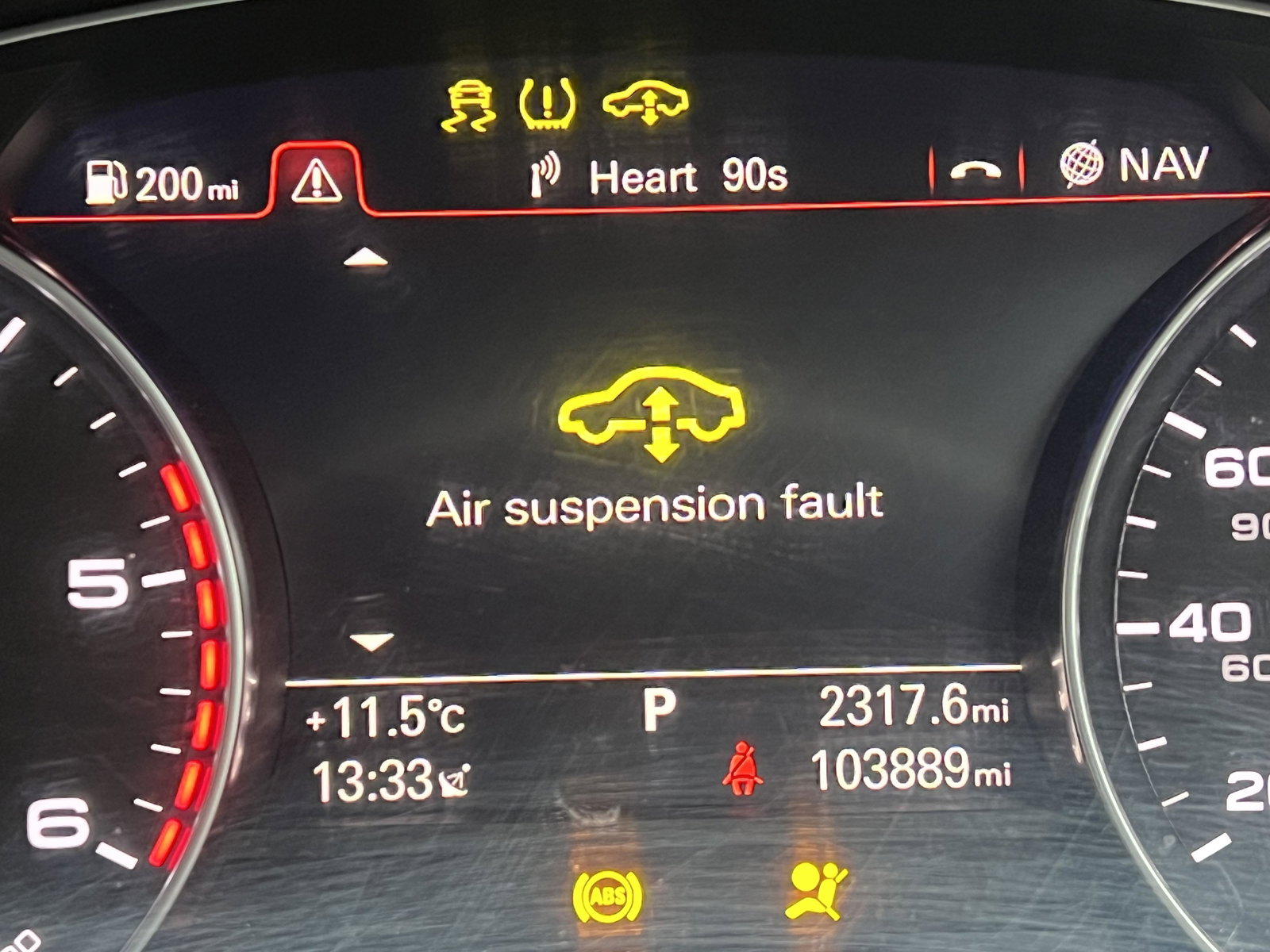

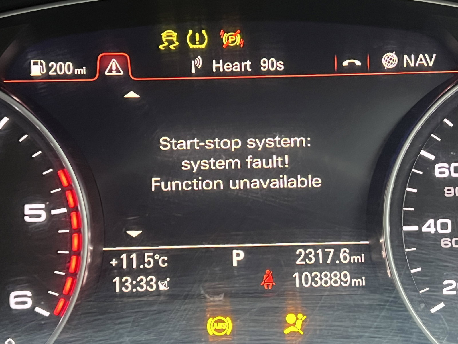

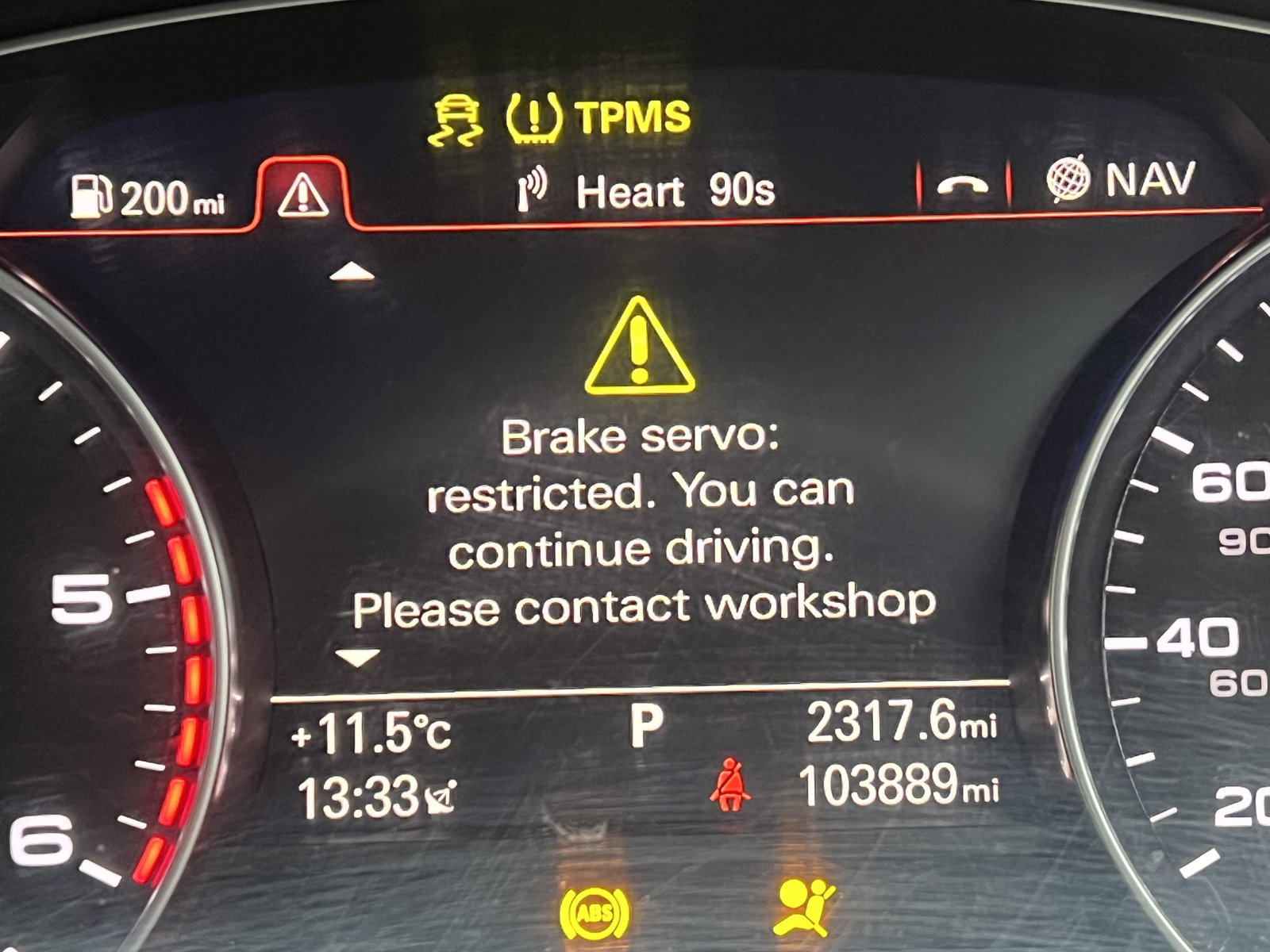

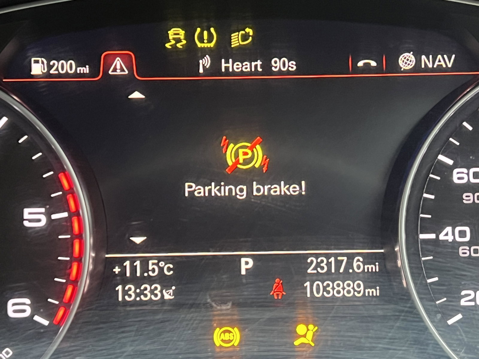

Numerous faults
Paul cairney

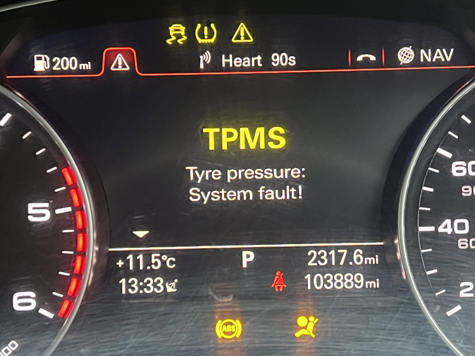

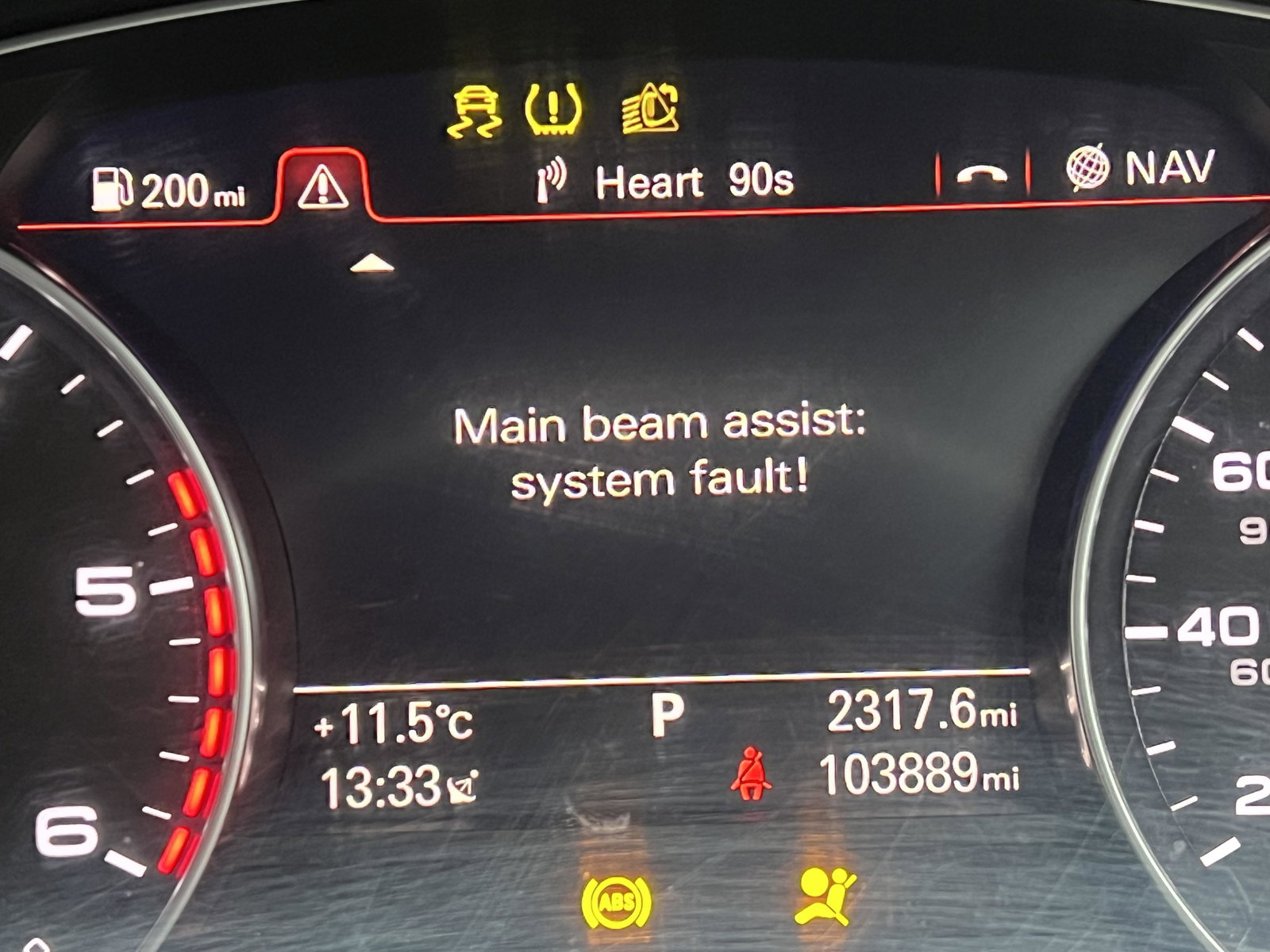

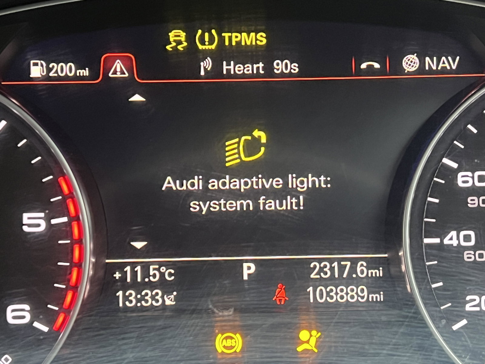

Update - solved the issue.
Upon reading other threads I checked the ABS wheels speed sensors on all 4 corners.
The front passengers side sensor was damaged. A break in the sensor case was letting water into it. I’ve replaced the sensor and the faults have all gone away.
It was a bit of a pig to change as it’d melted into the bearing housing.
Quite a coincidence that the wheel bearing was changed by the garage a few weeks before all these faults started appearing.
