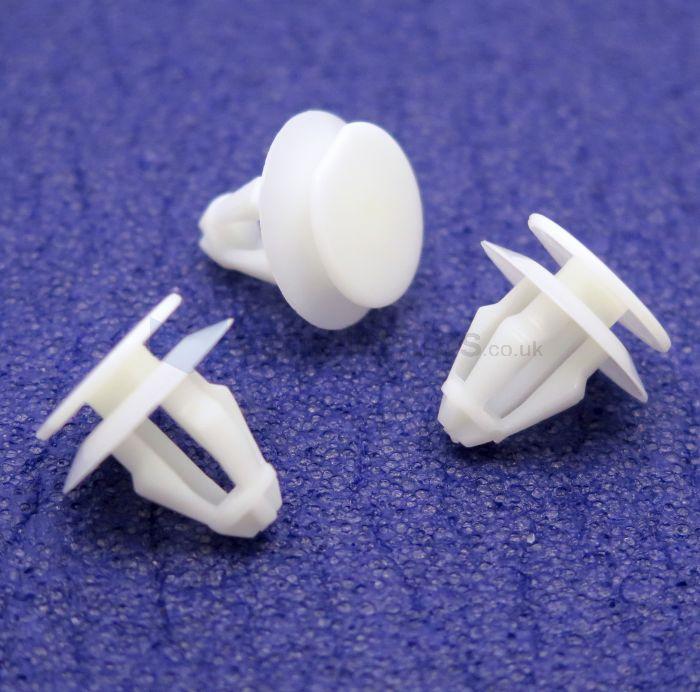

51 minutes ago, Steve Q said:
This should be the Interior Door Card & Trim Panel Clips- Audi 8E0867276
here's a link:
https://www.vehicleclips.co.uk/interior-door-card-trim-panel-clips-audi-8e0867276/

I've just got off the phone to my friendly parts chap - the part number is listed as 8Z0868243, which, when put into the Vehicle Clips search, comes up with these:
https://www.vehicleclips.co.uk/interior-door-card-panel-clips-for-seat-8e0868243/
Interior Door Card Panel Clips for Seat- 8E0868243
...which look like the ones that are on the card at the moment. These were £3.80 for 10 with free postage! I've ordered 10 anyway - handy to have on the shelf.
I can get the real thing from Audi for 98p each, which still isn't excessive, although I'm going to call that Plan C... 😆
Thanks very much for the input Steve - Vehicle Clips' site is now bookmarked... 👍

OK, I did a further search for the correct part number on Amazon and found these:
https://www.amazon.co.uk/gp/product/B08S1WWZW8/ref=ppx_yo_dt_b_asin_title_o00_s00?ie=UTF8&psc=1
I bought a pack of 20, as they would be delivered the following day - and the sun's out, so I wanted to use the car... 😎
They arrived this morning, fitted perfectly, and I've just refitted the door card.
So, for anyone looking for the correct clips for a facelift 2006 A4 B6/B7 Convertible door card, you need Audi Part Number 8Z0868243,  or the link above (which you can find by doing a search for the part number on Amazon).

Thanks for the link for the correct clips, I still have to install puddle lights and at least have everything for the job.
So, I took the door card off again today, and all but one of these clips...
...broke.
Thankfully I over-ordered when doing the job last time and these clips...
...have been fitted in their place. I don't know whether they will prove to be stronger than the others, but they did sort of 'click' into place in the holders, where the earlier ones were pretty loose.These are thee ones from the Amazon link above.
My situation (having to remove the same door card twice in fairly quick succession) was a little unusual, but I think I'm just going to treat these as disposable service items. I'll buy more every time I find the need to take a door card off...

I had to remove the door card today and - although the one surviving clip of the earlier type broke - ALL the ones I sourced at Amazon survived.
That's good to hear 🙂 I guess they're younger parts though.
No Steve, both types were new parts. It seems that one is better quality than the other…
Mike 😎
