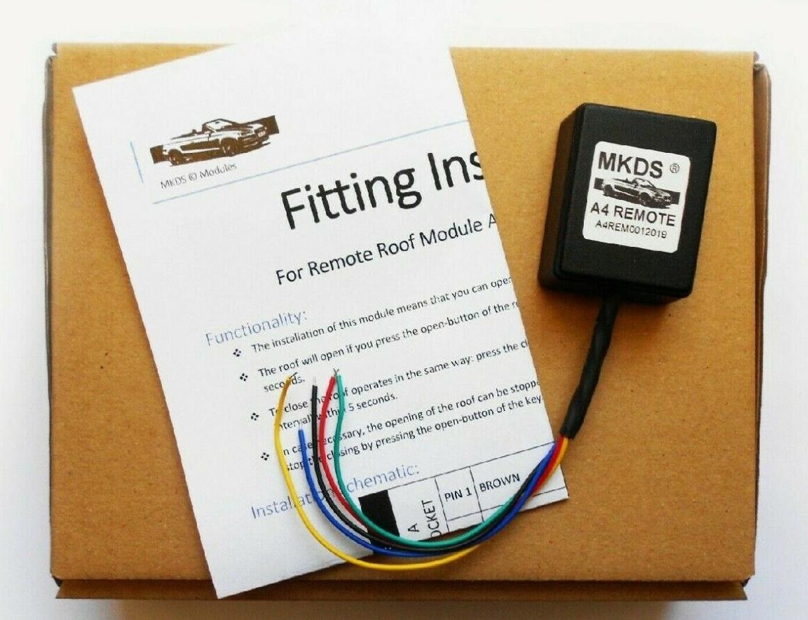

I had a remote roof module fitted in my A4 about six years ago and it worked fine. Recently it started playing up - specifically it wouldn't open the hood remotely. I thought six years was fair for a cheapish after-market gadget, so ordered another one to replace it - this one:

Well the vendor has been brilliant 😃. Here's the response from him first thing this morning:
Hello
I found out what is the issue.
You have a rare version of software in door ECU and this is actually making a mess.
It happened only twice so far for a few hundred modules already sold.
Today morning I posted a compatble version of the remote control module that will solve the issue.
Tracking available at
XXXX
We stay in touch.
Regards
I don't think you can ask for better service than that 😎 The vendor is based in Poland, so from experience it'll take a week or so to get here. It'll be ten minutes work to fit it (now that I have the right door clips - and some spares😆).

So - once it had reached the UK (yesterday, having been posted in Poland on 23rd June 🤔), the Post Office delivered it the next day...

The module is snuggled between the back of the ECU and the foam door lining. I get my trusty box of electrical connectors and get to work...
I soon have the new module hooked up...
...and give it a test. It works perfectly 😃
