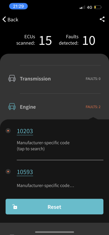

Stuttering when putting foot down sometimes
Changed spark plugs  2 coil packs. Could it be the camshaft sensor ?
P0301 code as well

Hi it could be a wiring connector to cylinder 1 coil pack or a faulty injector or an air leak on the air intake, provided you have not fitted a sports air filter check the ducting for loose joints other than that try a can of injector cleaner in the fuel.
