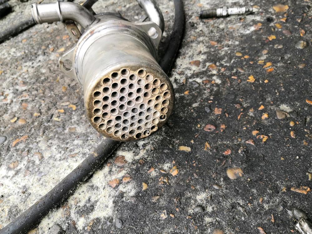

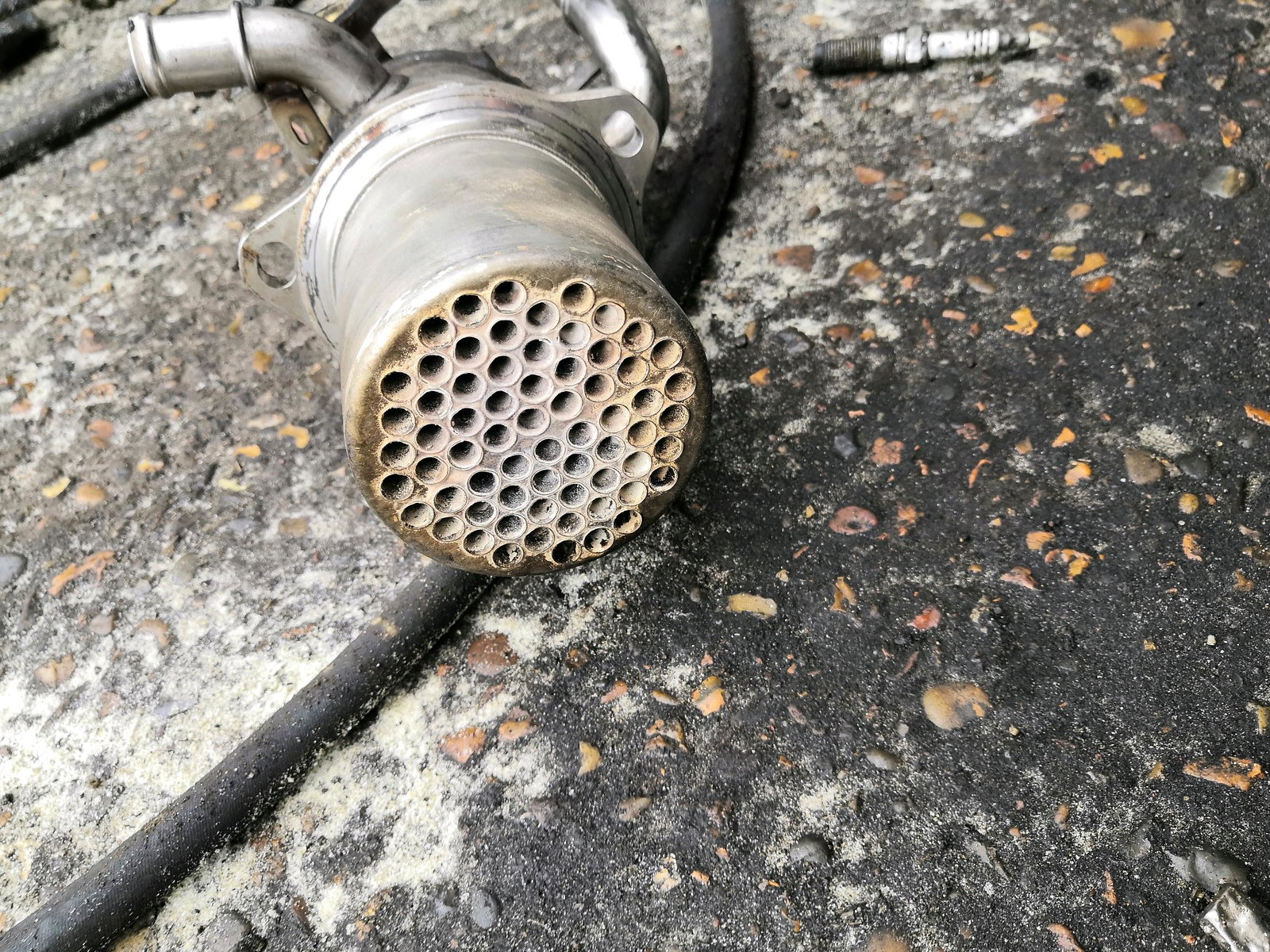

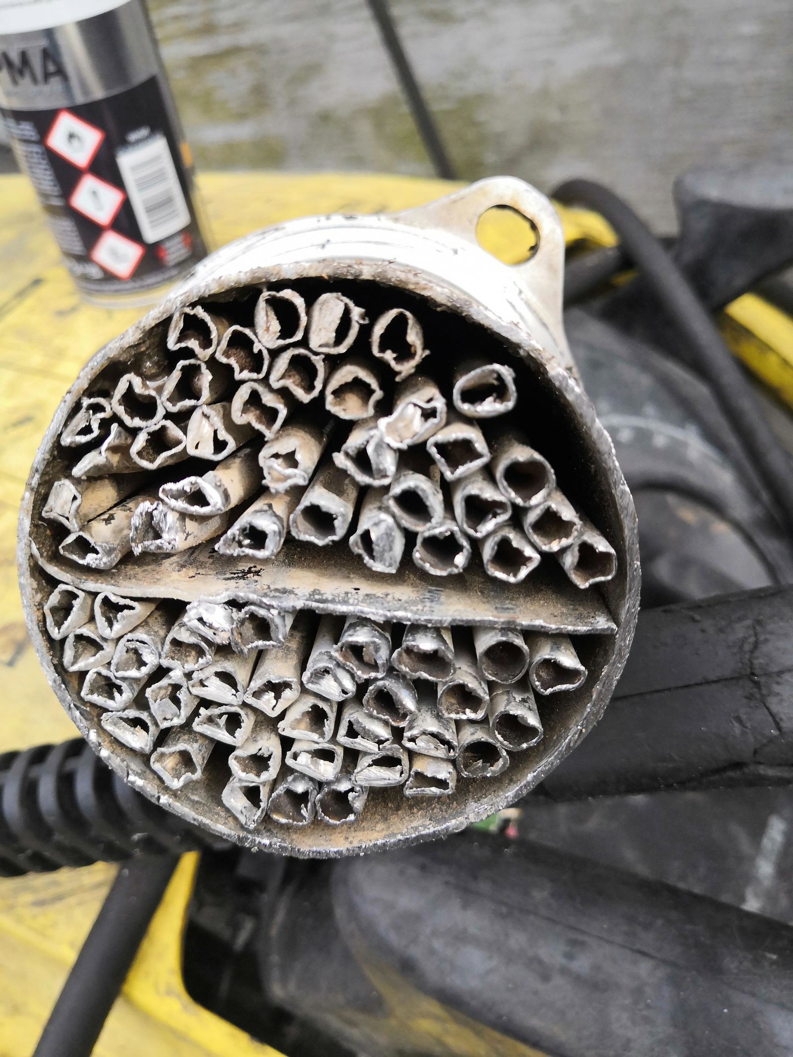

Hi the DPF is Finland your problem is nothing to do with the Adblue delete, garage diagnostic systems are Generic and won't show the reason for the code P2002 which is the EGR low pressure cooler, no one can do anything to tamper with these, the EGR they turned off was on the high pressure side on the inlet manifold you actually have two EGRs one high pressure one low pressure its that which is causing the problem, as far as I am aware no one has written a software to disable this as without it you would definitely fail an MOT on the emissions as the low pressure side is part of the Ultra technology and thus the emission maximum is 0.05 maximum, mine went and please see pictures of what it looks like and why they fail.
As Steve and Stevey have already mentioned, P2002 is caused by a blocked EGR cooler, though it's worth doing a voltage check on the G450 sensors too because that's the pressure feedback.
I was strongly advised to not delete the EGR cooler, so to avoid failure of components/engine from overheating 12-18 months later.
You could be lucky and get away with replacing an £80 sensor vs. £1k for an EGR valve and cooler replacement, but you're already experiencing it getting hot quickly, so chances are it's blocked.
