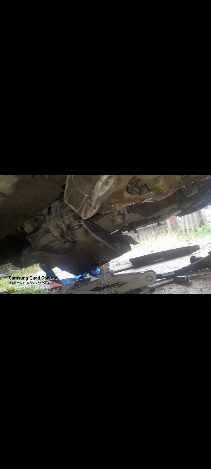

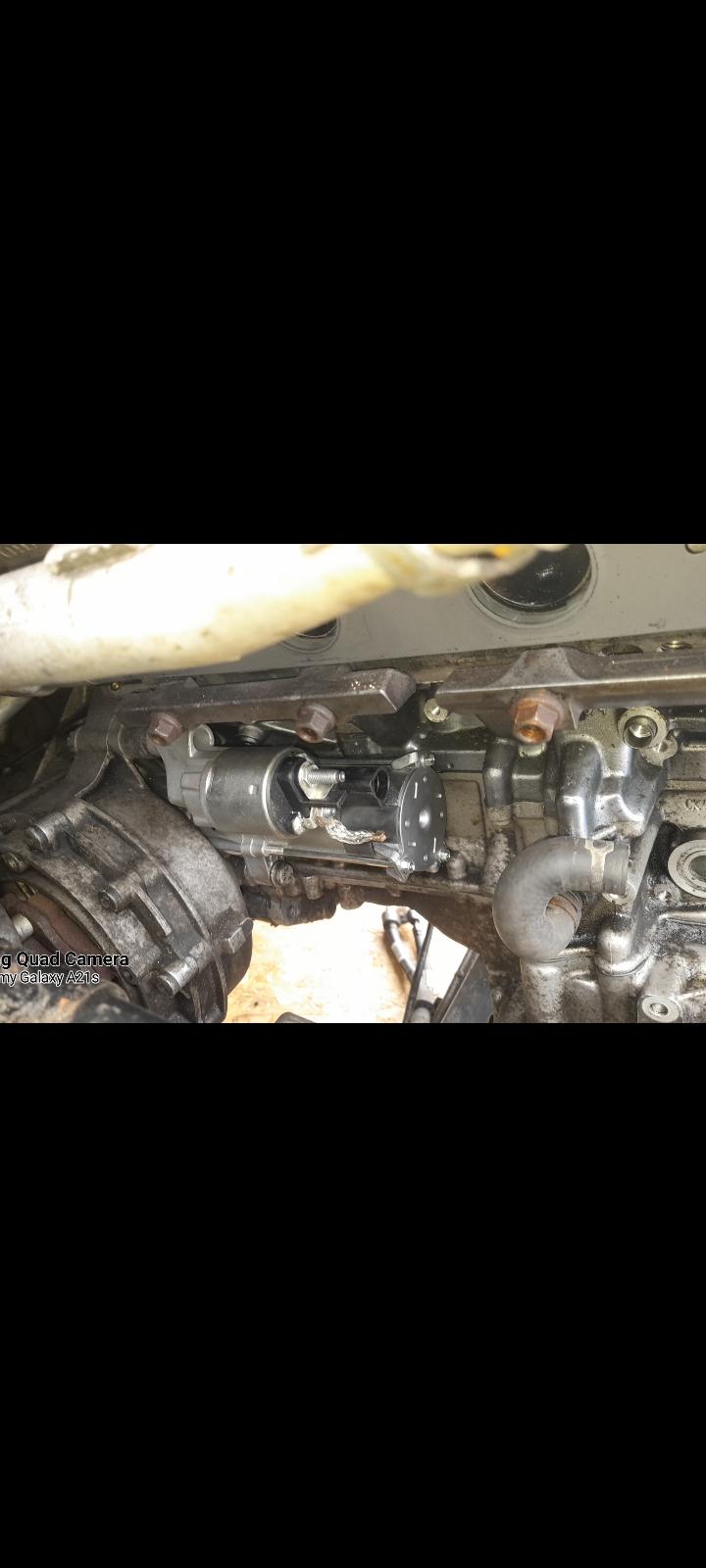

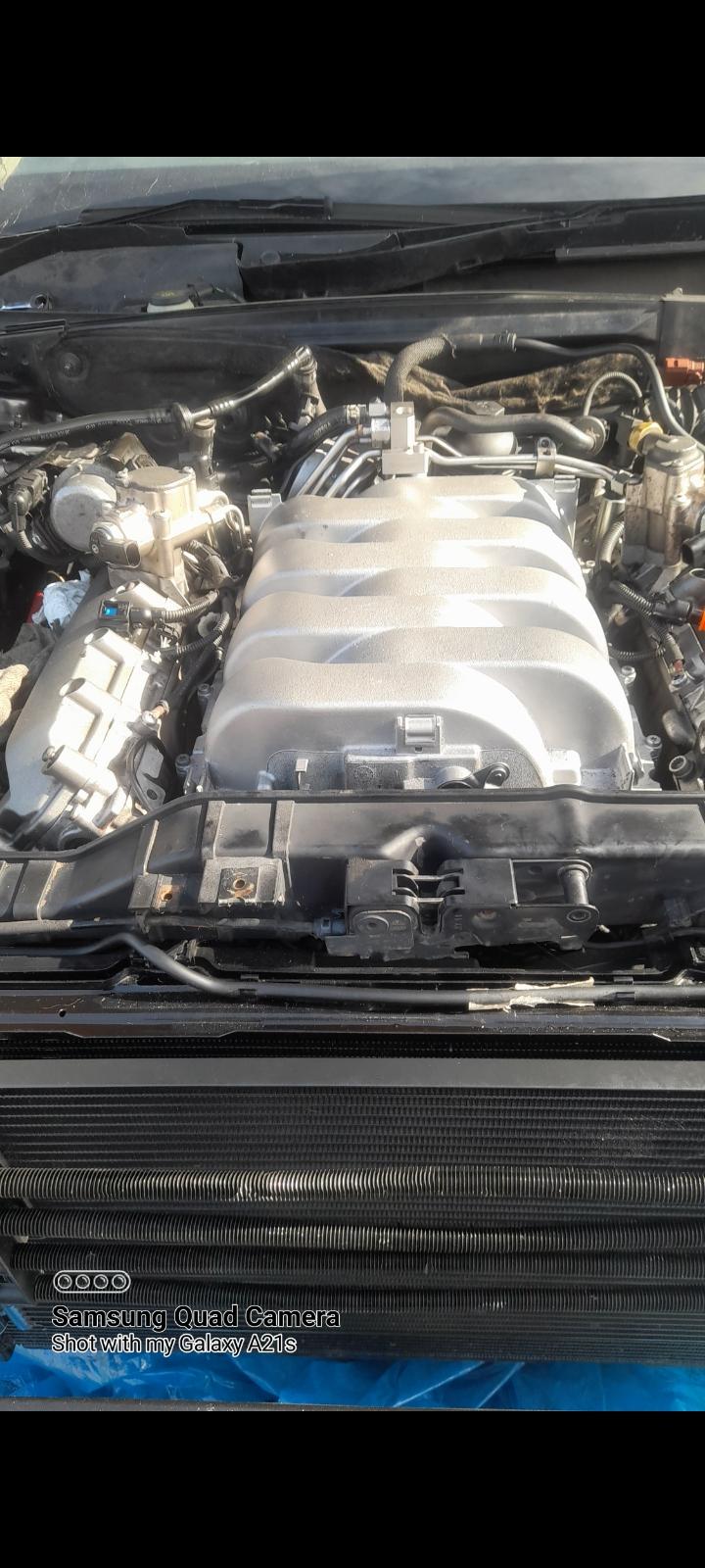

Busy day gearbox back up and sub frame, cats all bolted down and down pipes on, lead and plug on the starter motor, earth leads bolted on water pipes on, oil cooler on and alternator on, for some reason audi made the alternator + lead a black cable not red you can definitely mistake it for one of the earth leads as there 3

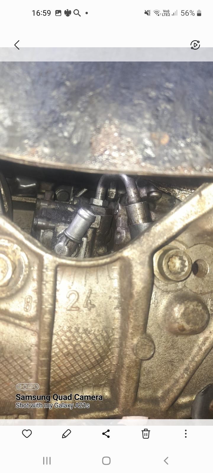

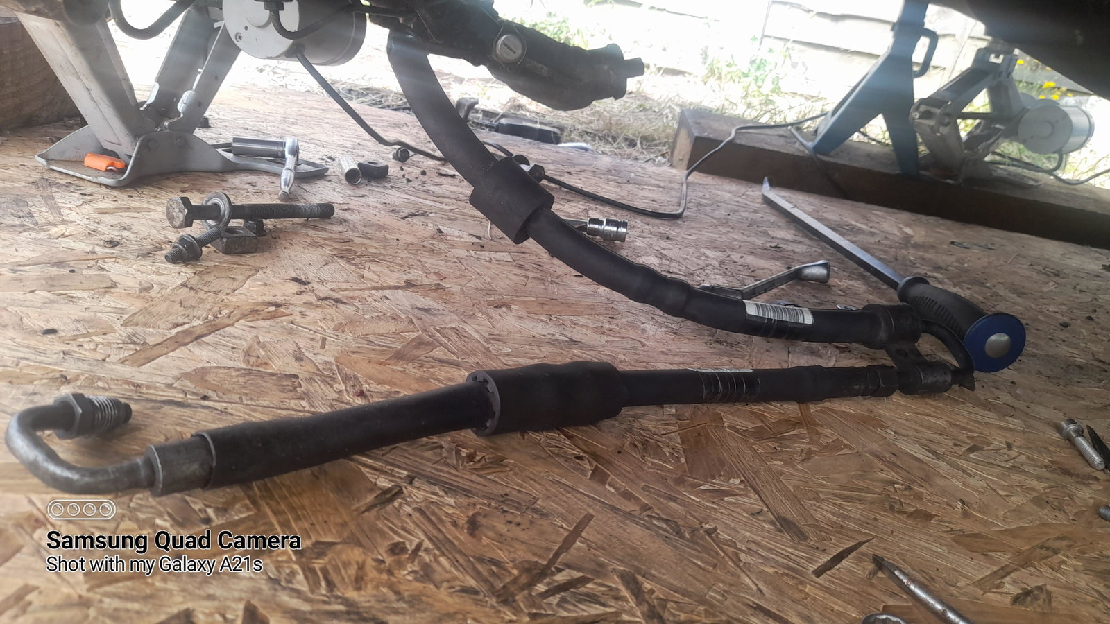

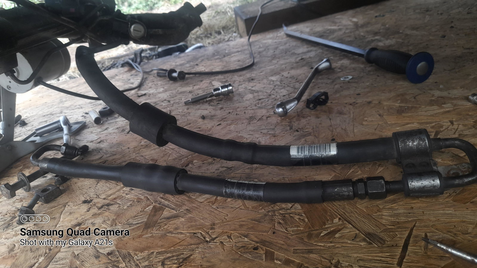

I'm stuck power steering hose one on but can't see where the other part goes pulled the rack down again just incase it's hidden but nothing any ideas anyone
Never mined found it very top of the pump so engine mount off lift the engine a tad job done

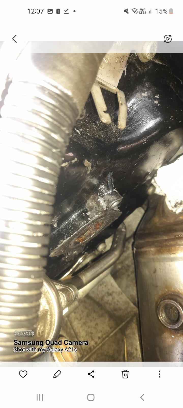

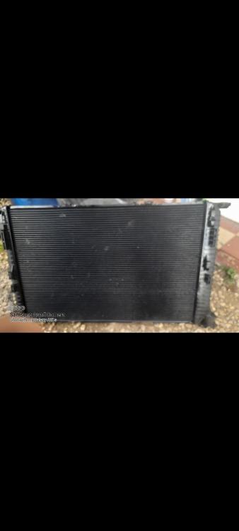

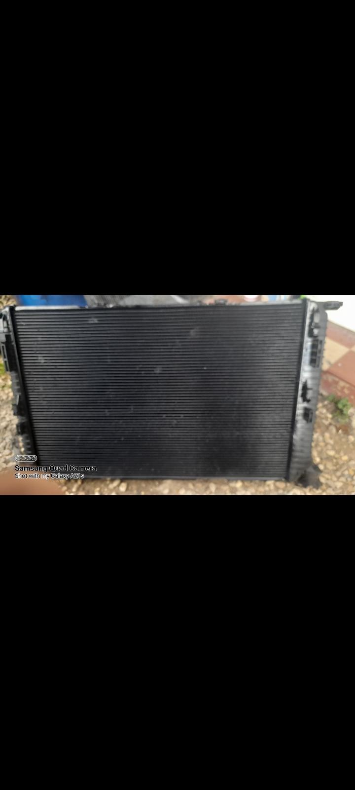

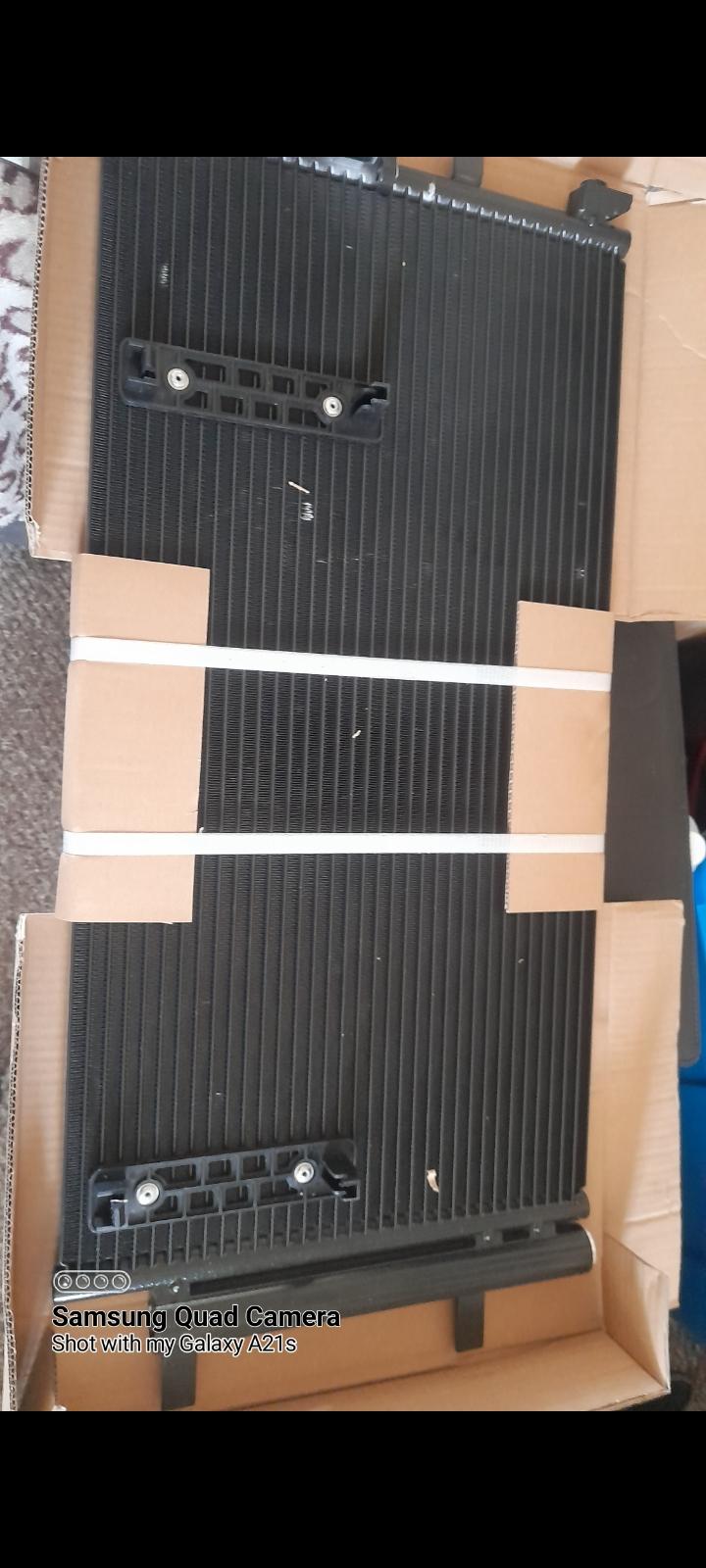

Got the new aircon radiator, was going too get a new rad but decided to clean and redue the old one came out nice found the oil cooler pipe damaged so new one on the way

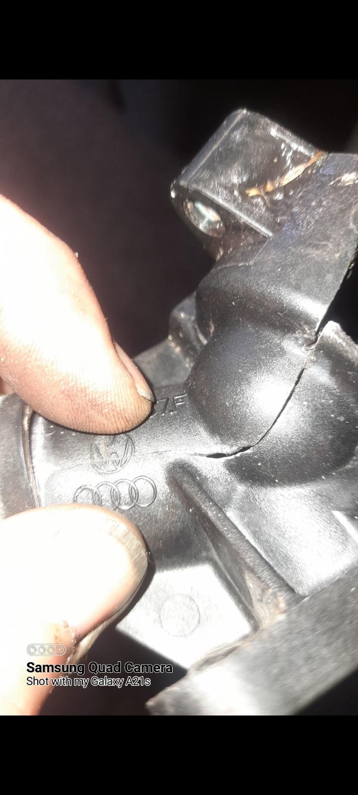

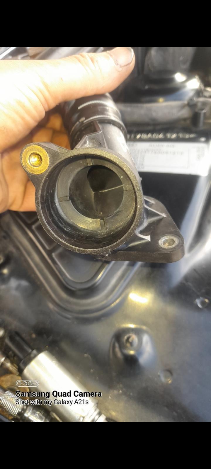

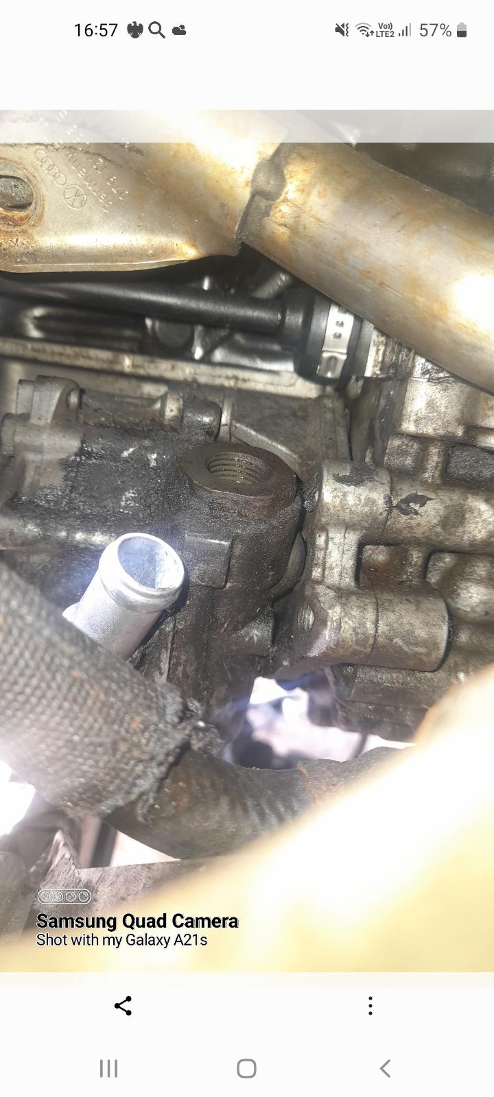

Not been on for a while been busy with work and late parts coming anyway starting to come together water and oil and so on in had a small water leak at the back thought hose so had to remove bits so I could see handy it was the drivers side more room to play with ends up being the bracket that goes to the upper timing cover water way to the water pipe on the side had a small crack in it

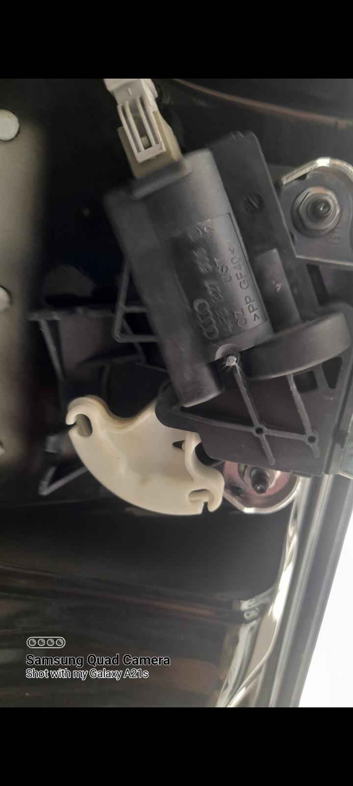

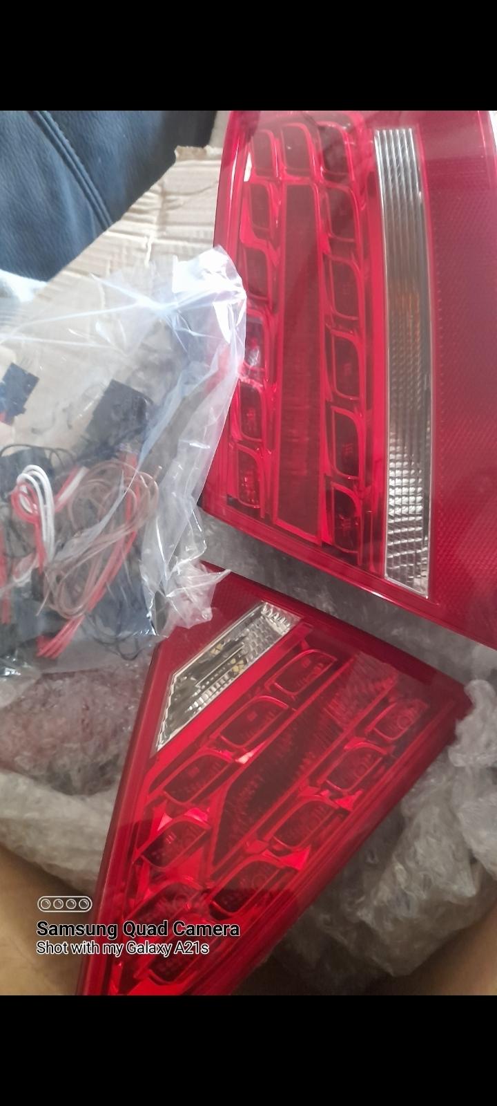

So got some parts rear lights and cables, but thought I'd work on the rear boot when it's shut won't open but it opens from inside the car by button and with the key iv took it apart seems I'm missing a cables 1 what ones and where do thay go as I can't see anything

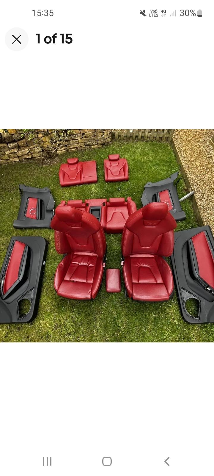

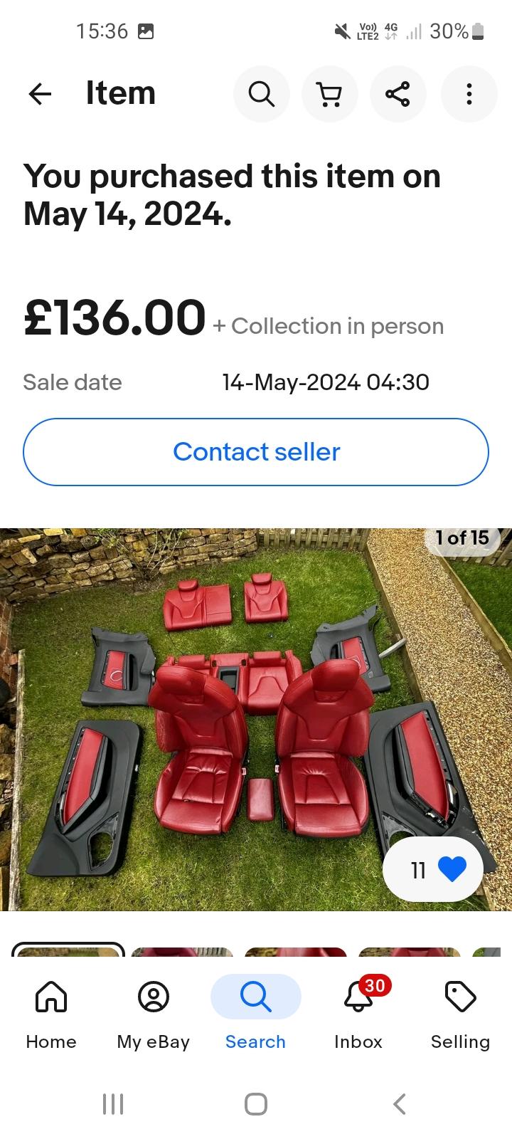

Not been doing too much too her fixed the exhaust on properly and been looking for the red interior, last night had a good touch got a full set normally 600.00 to 1200.00, I won this for 136.00 yea totally stole it
What a bargain!
Be careful regarding air bag wiring though as connectors can vary.
As such, if conne tors are different the easiest option is to change the airbags abs wiring from your current seats to the new ones believe it or not.
37 minutes ago, Steve Q said:
What a bargain!
Yea that's correct Steve the lad took the plugs off this lot too put on his new set he got as thay where different so I'll be taking mine off the front seats and just swop them over
At least you're aware 🙂
Not sure if this is allowed if not please delete, so now iv got the new interior mine up for sale front seats are white, back seat and door cards are black all good condition no rips, and the rear lights 100.00
Yea it's fine to sell on here. I'd recommend doing a separate post under the for sale section.
