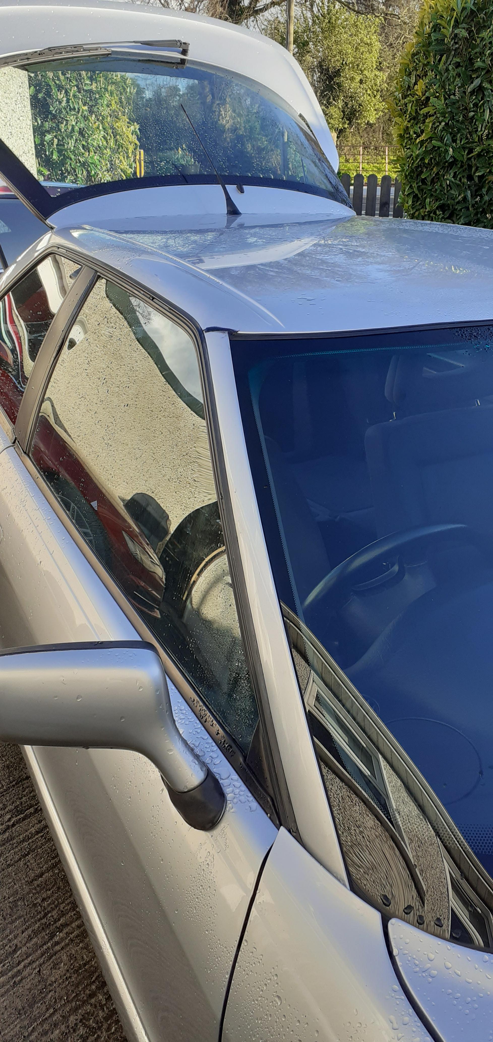

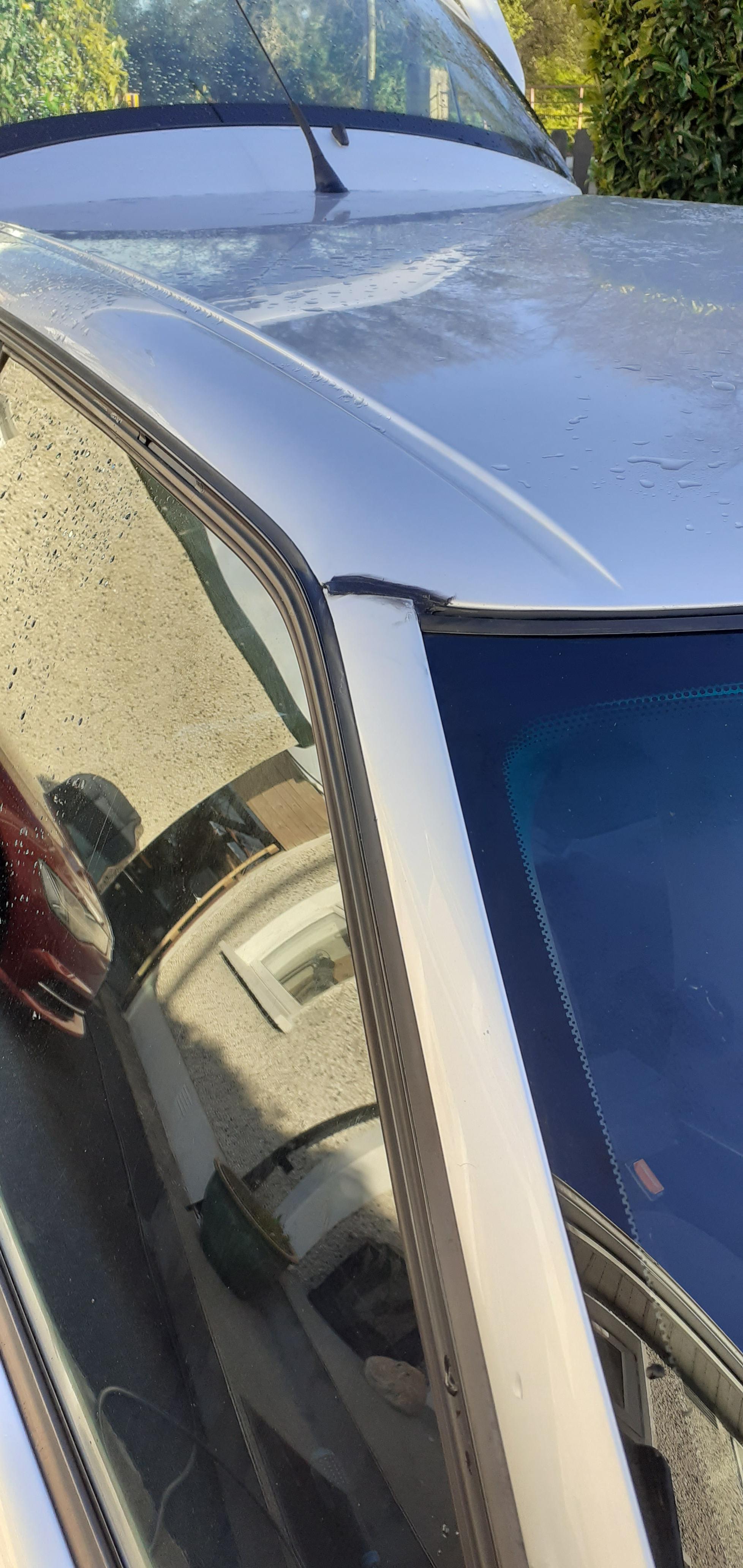

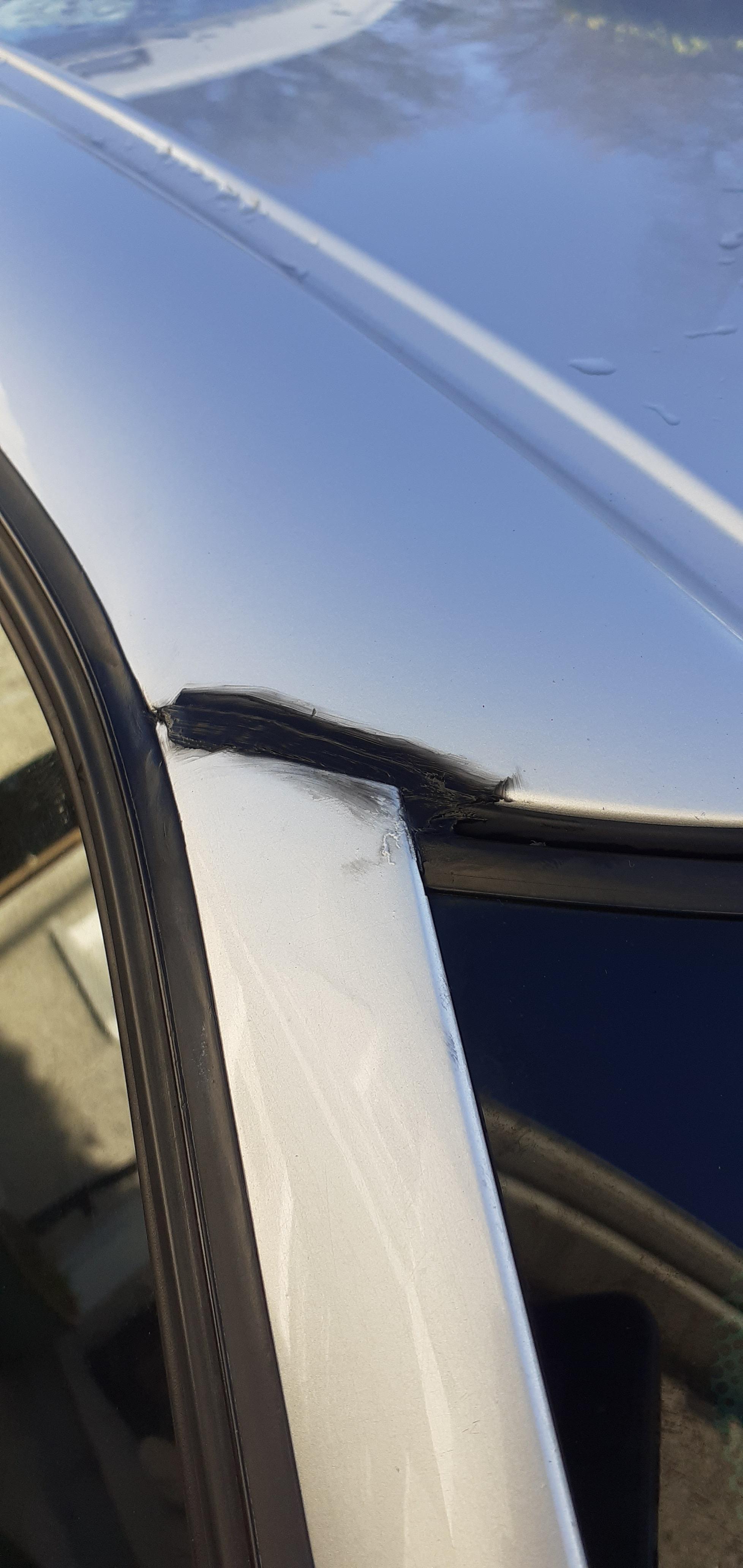

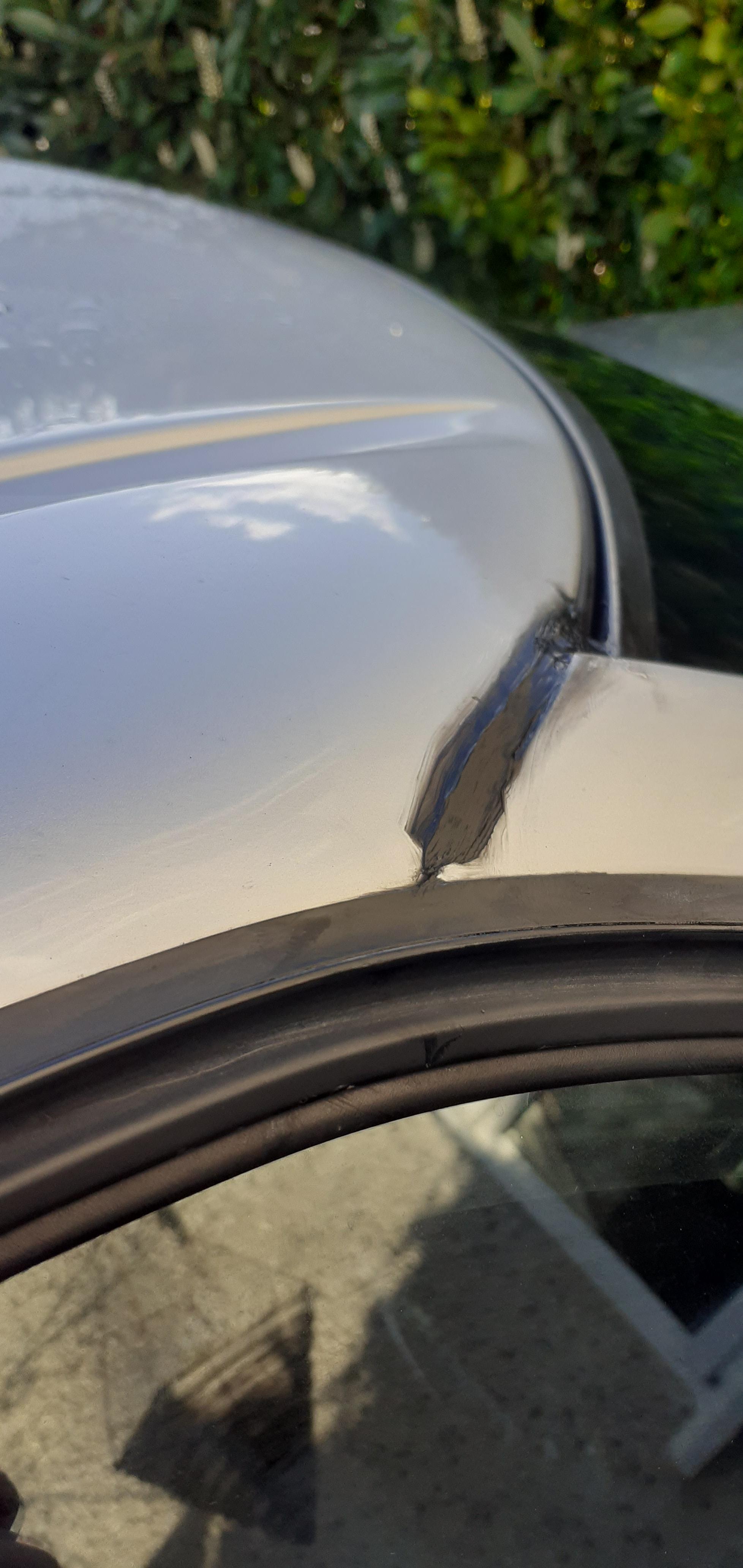

coupe4 Posted April 13 Author Share Posted April 13 latest update on my wet floor,after a very wet few days here in ireland my floor on the ds had a pool of water again so my son and i gave the whole back area a thorough soaking and its completely dry,so we started around the windscreen area and we found water pouring in through a tiny gap.so i now think ive finally solved it.ive included pics[will tidy up and paint area when dry]for anyone whos experiencing similar nightmares.greg 1 Quote Link to comment Share on other sites More sharing options...
