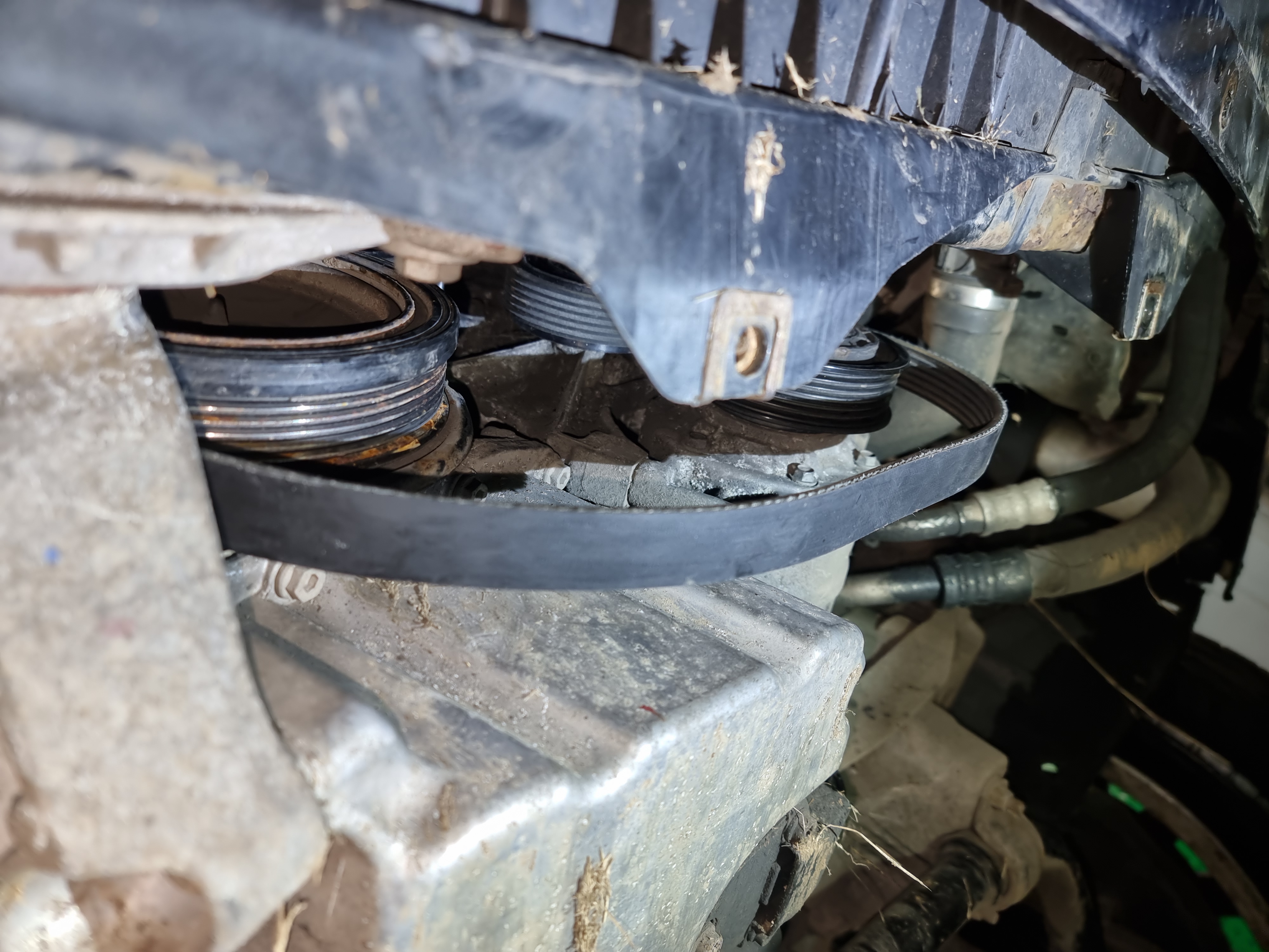

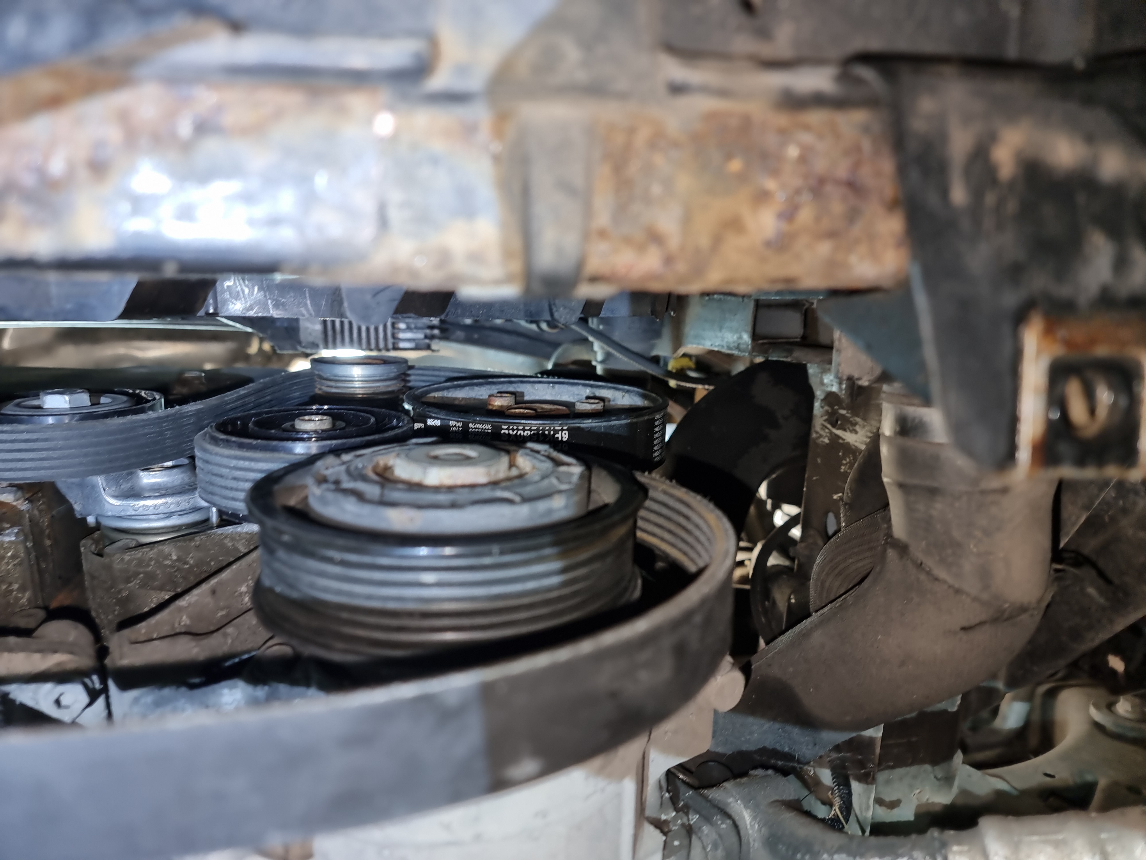

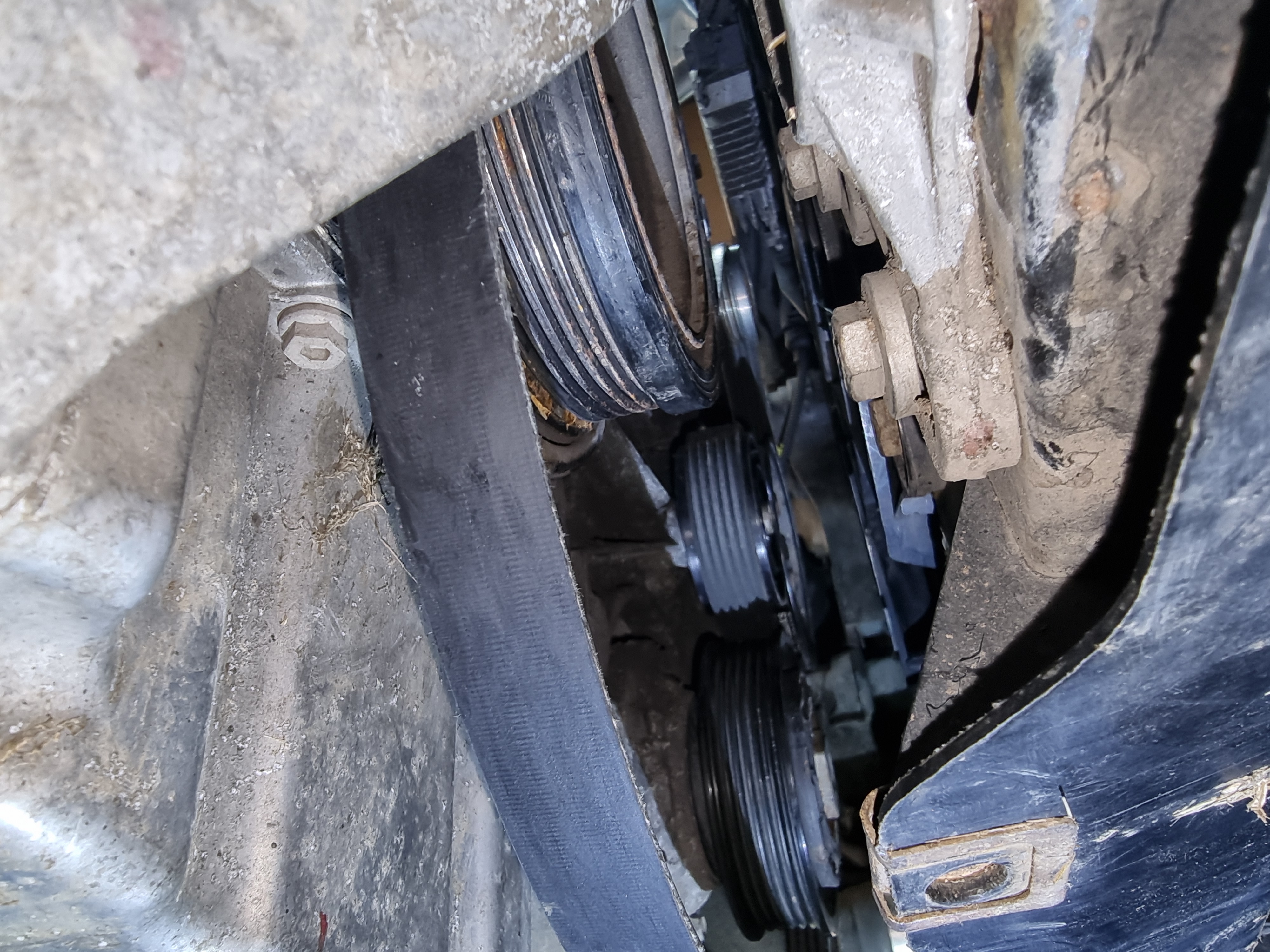

Shmeefly Posted March 17 Share Posted March 17 (edited) Hi everyone I've just bought an Audi A6 2.0 diesel with a snapped belt, so I purchased a new one and tensioner + guide roller, fitted them and put the belt on and have loads of play ??? As if I missed a roller or something ??? Phone parts shop and they confirmed it was the right belt ??? Anyone know what I'm doing wrong here ??? I think the engine is a CAG Edited March 17 by Shmeefly Quote Link to comment Share on other sites More sharing options...
coupe4 Posted March 17 Share Posted March 17 id say youve the correct belt but your not putting it correctly around all pulleys,check a diagram to see the way the belt runs 1 Quote Link to comment Share on other sites More sharing options...

Magnet Posted March 17 Share Posted March 17 Hello Nikki, You are of course at a disadvantage of not having been able to do a sketch of the old belt routing prior to its removal - which is the normal procedure. Did the belt come with the snapped belt? Of course, if so, you could check old against new. Re. Parts Shop confirming the belt you have is indeed the correct one, this may benefit from independent confirmation. What make belt did you buy? For most of the main aftermarket belt manufacturers, you should be able to make contact with their technical section and confirm correct fitment via. reg. no. and/or VIN. Really worth doing. Alternative if you are convinced you have the correct routing, would be to buy a belt from a main dealer. Belt only should suffice, since you will know whether you have like for like tensioner and idler. Perhaps you could let us know how you get on Nikki. Kind regards, Gareth. Quote Link to comment Share on other sites More sharing options...
Shmeefly Posted March 18 Author Share Posted March 18 15 hours ago, Magnet said: Hello Nikki, You are of course at a disadvantage of not having been able to do a sketch of the old belt routing prior to its removal - which is the normal procedure. Did the belt come with the snapped belt? Of course, if so, you could check old against new. Re. Parts Shop confirming the belt you have is indeed the correct one, this may benefit from independent confirmation. What make belt did you buy? For most of the main aftermarket belt manufacturers, you should be able to make contact with their technical section and confirm correct fitment via. reg. no. and/or VIN. Really worth doing. Alternative if you are convinced you have the correct routing, would be to buy a belt from a main dealer. Belt only should suffice, since you will know whether you have like for like tensioner and idler. Perhaps you could let us know how you get on Nikki. Kind regards, Gareth. I have the remains of the old belt and it just about has the label left and it exactly the same belt ??? I've been sleeping underneath this car staring at these wheels 😆 and just can't figure it out Quote Link to comment Share on other sites More sharing options...
Magnet Posted March 18 Share Posted March 18 Matching label/ part numbers on both belts then?? Old belt in tact and complete at a a single break point, and measured like for like on old and new?? Belt makes as a matter of interest? If yes, to the first two questions, then obviously the routing is wrong - assuming old and new tensioner and idler are a match. Kind regards, Gareth. Quote Link to comment Share on other sites More sharing options...
Shmeefly Posted March 22 Author Share Posted March 22 I remembered I had Autodata on an old tablet, looked it up and was the wrong diagram I was using !!! and the belt went strait off the generator strait to the first pulley, not to the power steering and air con first like I was trying to do lol Thanks for everyone's replys 2 Quote Link to comment Share on other sites More sharing options...
Magnet Posted March 22 Share Posted March 22 Good on you Nikki. All thinks being equal, the routing had to be wrong. Kind regards, Gareth. Quote Link to comment Share on other sites More sharing options...
