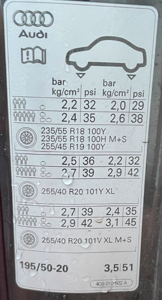

Hi Gareth ,
My tires which were on the car when I bought a couple of years ago are Laufrenn 255/35Z/R29 97Y.
The attached image of door badge does have 40 as option , but tire pressure isnt there for 35/20 ?
Your help is very appreciated

Its and shouldnt be a confusing issue . My door badge as image shows all sizes but not the 35/20 , but does show 40/20 Gareth has been very helpfull, but It does seem 20/40 is a recommended size .

Hello Richard,
Many thanks for your additional detail.
It would appear that your current tyres are a lower profile than Audi recommend, and your proposed 255/40 size is what should indeed be fitted.
Who fitted your current incorrect budget tyres?
I could be wrong, but I fear that the slight increase in tyre profile from 35 to 40 isn’t going to give you that much improvement in ride quality.
Changing wheel size to 18 inch and fitting 55 profile would be the better, but obviously far more expensive option.
If it’s any consolation Richard, you aren’t the first to suffer harsh ride with the ‘fancy looking’ largest wheel option.
When moving to 40 profile with your 20 inch wheels, make careful enquiries whether those tyres would be XL or not. Audi recommend XL for that profile, but that again makes for a harsher ride.
