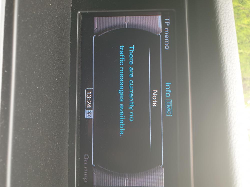

Anyone got a fix for a problem with MMI system traffic messages having stopped flowing?  The Info menu for a few months now says no messages are available.  This screen used to list all the RDS radio traffic incidents and the clever and helpful bit was this flowed through to the dynamic route planning app.
This came as standard with my Black edition A4 2012 Sport - so no paid subscription.
I've read that the Trafficmaster provider of this data has stopped supplying the data.  Surely there are other providers. Dealer doesn't seem to have a fix for this problem and doesn't even recognise it.  Audi Digital online referred me to the dealer.
Please don't say just use a standalone nav app or mobile device!  Thanks.

It seems that many people with different VG group vehicles have noticed this problem during 2023 as the provider of the data to VAG vehicles audio systems, Trafficmaster has stopped providing the data service.
This means that with the current coding Audi (and other similar models) cannot receive RDS data in the UK.   There is another provider in the UK data market, I have learned, Inrix, but the format of their data differs from Trafficmaster so that a straightforward switch-over is not possible.

The problem on the MMI3G B unit is that the location tables in the maps are for Trafficmaster not INRIX. So new maps with INRIX location tables would be needed assuming that the TMC supplier could be changed over in the head unit. Only other solution is to reinstate the Trafficmaster service which simply will not happen. I know that mobile phones etc can be used but the whole point of having a built in navigation system is that you do not have to use one.
