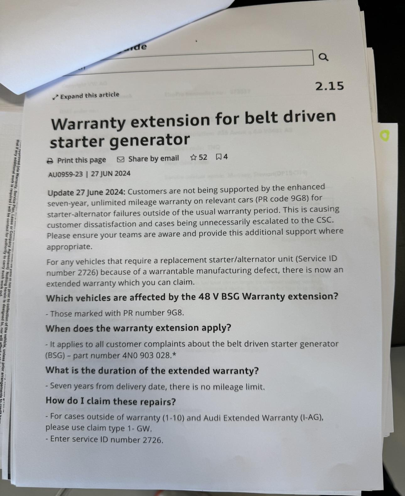

Hello,
For the 48V issue it is confirmed that all vehicles with certain build codes are covered fully which covers most models from production 2020+. I’ve successfully had Cheltenham to get Audi UK to fully compensate the cost of labour and parts.
I took a copy of the internal document with approval from my Audi dealer to help all users from the UK out on this forum.
I hope this helps anyone that’s stuck.
Anyone wish to use Cheltenham Audi I highly recommend. Point of contact is service manager Nigel and he’s fully aware that I have been contributing in this forum.
Thanks

Many thanks for this, it’ll be very interesting to see how long it takes Leicester Audi to catch up. It’s quite apparent that the service managers should be ensuring their staff are up to date. I have repeatedly asked if they are aware of this issue (regardless of whether our car is affected) and they are just unaware! Now that Audi UK customer services are involved I’d guess they are not too happy with the dealer for getting to to the point where we have “unnecessarily escalated it to CSC” as the point of the internal bulletin is to prevent it!!
Fair play to Lister Audi. We’ve rung around and had nothing but helpful people look it up for us… and confirm it should be appropriate to our Q7.
I am tempted, once we’re agreed it needs doing under warranty, to insist that the car is transported to Coventry Lister so that they get the warrant income…

I attach an internal Audi bulletin that describes a warrantable manufacturing defect with the alternator.
Audi should have honoured this and replaced the part on my car at no cost. I even had to pay for diagnostics.

Hi, yes, we’ve considered that. However I seem to have a sensible person talking to me now. Taken 2 weeks but he’s listening to me instead of treating me like a numb skull. I have provided the bulletin kindly posted further back on n the thread dated 27 June, and he’s toddled off to investigate. He did then empathise with how it looked, based on the information we have.
The PR code of 9G8 is key. If this is included on the build sticker in the  boot, or the one on the inside cover of the owners manual, and it’s the alternator that has failed (confirmed by diagnostics) then I don’t think there much argument really now. Ours has this. My debate is whether the battery has gone too, and then if the battery was killed by the alternator (which is highly probable). My beef is now that they needed me to indemnify them to guess by a parts swap with another car…
We’ll see soon enough.

OK - good luck - I was advised by Listers that the Alternator failure can kill the battery - but this would be established post repair with a road test.  I would expect this to also be replaced as a consequence if it was proven not to be charging.  But Leicester should be ordering the parts and booking your repair in not messing about with further investigations.  Mine failed on a Tuesday I think and I had the car back the following Monday all fixed, road tested and valeted......
