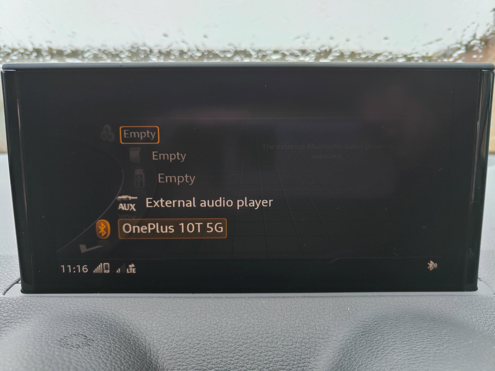

George Sibley Posted December 3, 2023 Share Posted December 3, 2023 (edited) I have a 2023 Q2 35TFSI nodel. The CD player and SD card slots are physically available in the glovebox, but are not accessible from the media menu? Also, I can't put a CD in the CD player. The slots are showing as 'Empty' in the media menu. We're still waiting for Audi to come back to us with our query. Does anyone have any ideas on what's preventing us from using the functionality? I have added an image of the media menu. Edited December 3, 2023 by George Sibley Added photo of media menu Quote Link to comment Share on other sites More sharing options...
Steve Q Posted December 3, 2023 Share Posted December 3, 2023 This should go back to main dealer for diagnostic check to see if any fault codes flag up. In the handbook it should tell.yiu how to do a system reset on it. Might be worth trying that also. Quote Link to comment Share on other sites More sharing options...

G Clark Posted December 8, 2023 Share Posted December 8, 2023 Further to my last post. I have just spoken with the service advisor. It would appear that whilst it looks like there is a CD player fitted, in a limited number of Q2 chassis numbers it is in fact only a blank covering the MMI box. I am currently waiting to see whether mine is one of these. Quote Link to comment Share on other sites More sharing options...
G Clark Posted December 8, 2023 Share Posted December 8, 2023 Service have now confirmed that all q2s made after week12 of 2023 do not have dvd/cd package and it has been discontinued on the model. Quote Link to comment Share on other sites More sharing options...
