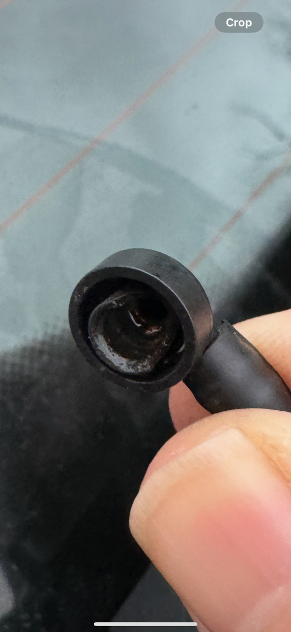

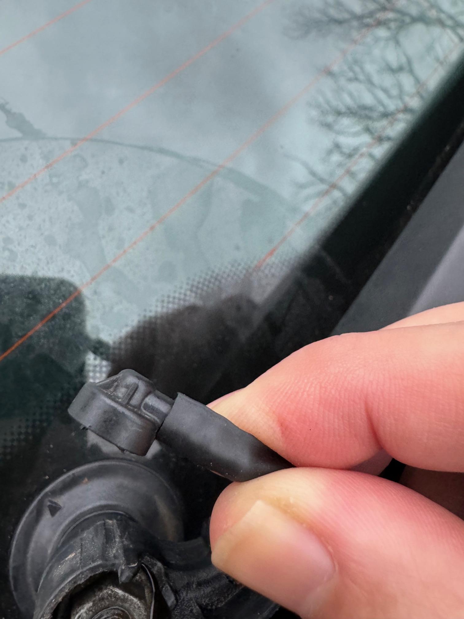

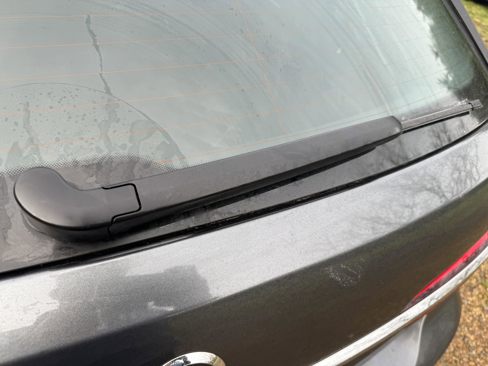

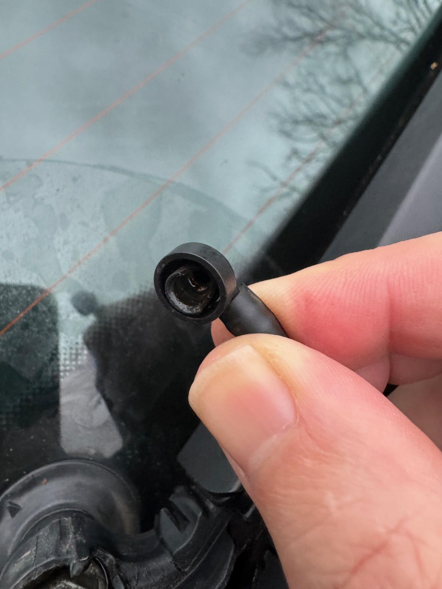

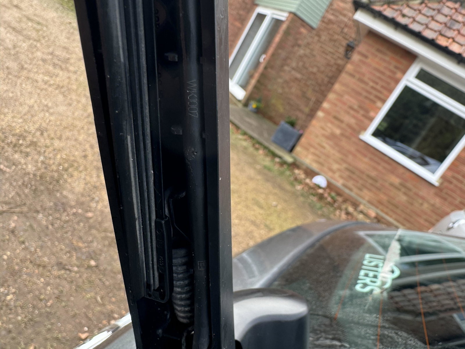

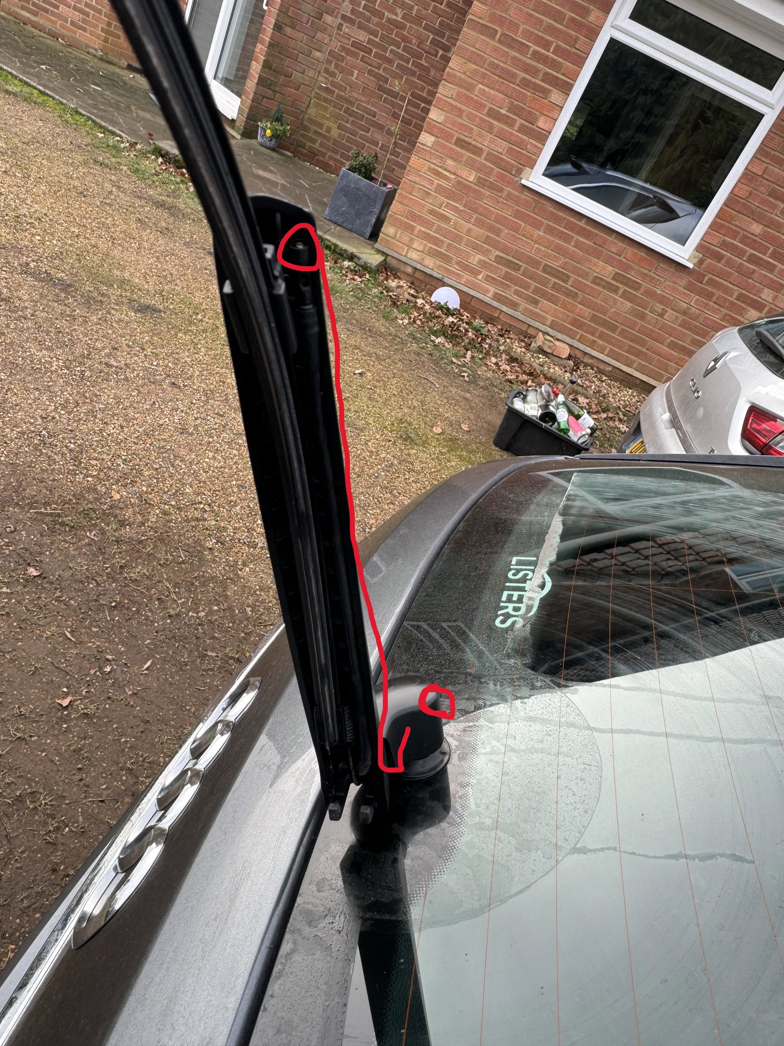

Daniel Ralph Posted January 21 Share Posted January 21 Anyone know the parts diagrams for the rear wiper ? 4K9955407B Its got a hose running the length of the rear wiper and the plastic connector under the cap has broken a bit and needless to say, wiper fluid just dribbles down the back logo. The rear wiper cap is solid, so its not the type that has the nozzle under the cap. As I mentioned its connected a 10cm hose that has the jet/nozzole at the end. about half way along the rear wiper blade. Quote Link to comment Share on other sites More sharing options...
Stevey Y Posted January 21 Share Posted January 21 5 hours ago, Daniel Ralph said: Anyone know the parts diagrams for the rear wiper ? 4K9955407B Its got a hose running the length of the rear wiper and the plastic connector under the cap has broken a bit and needless to say, wiper fluid just dribbles down the back logo. The rear wiper cap is solid, so its not the type that has the nozzle under the cap. As I mentioned its connected a 10cm hose that has the jet/nozzole at the end. about half way along the rear wiper blade. Hi the nozzle that is under the cap is probably sold as a repair section as the nozzle would have to unplug from the top of the wiper spindle to facilitate removal of the wiper arm, try the dealers. Steve. Quote Link to comment Share on other sites More sharing options...

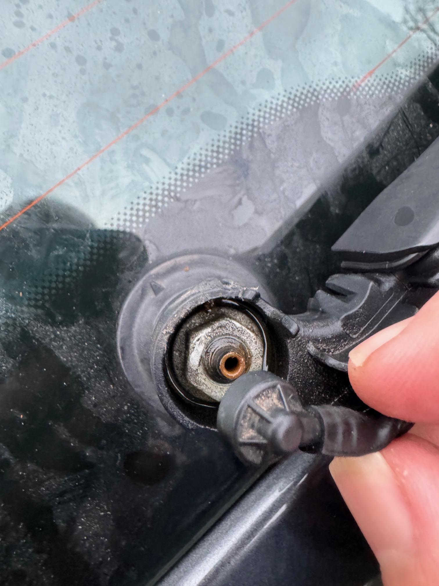

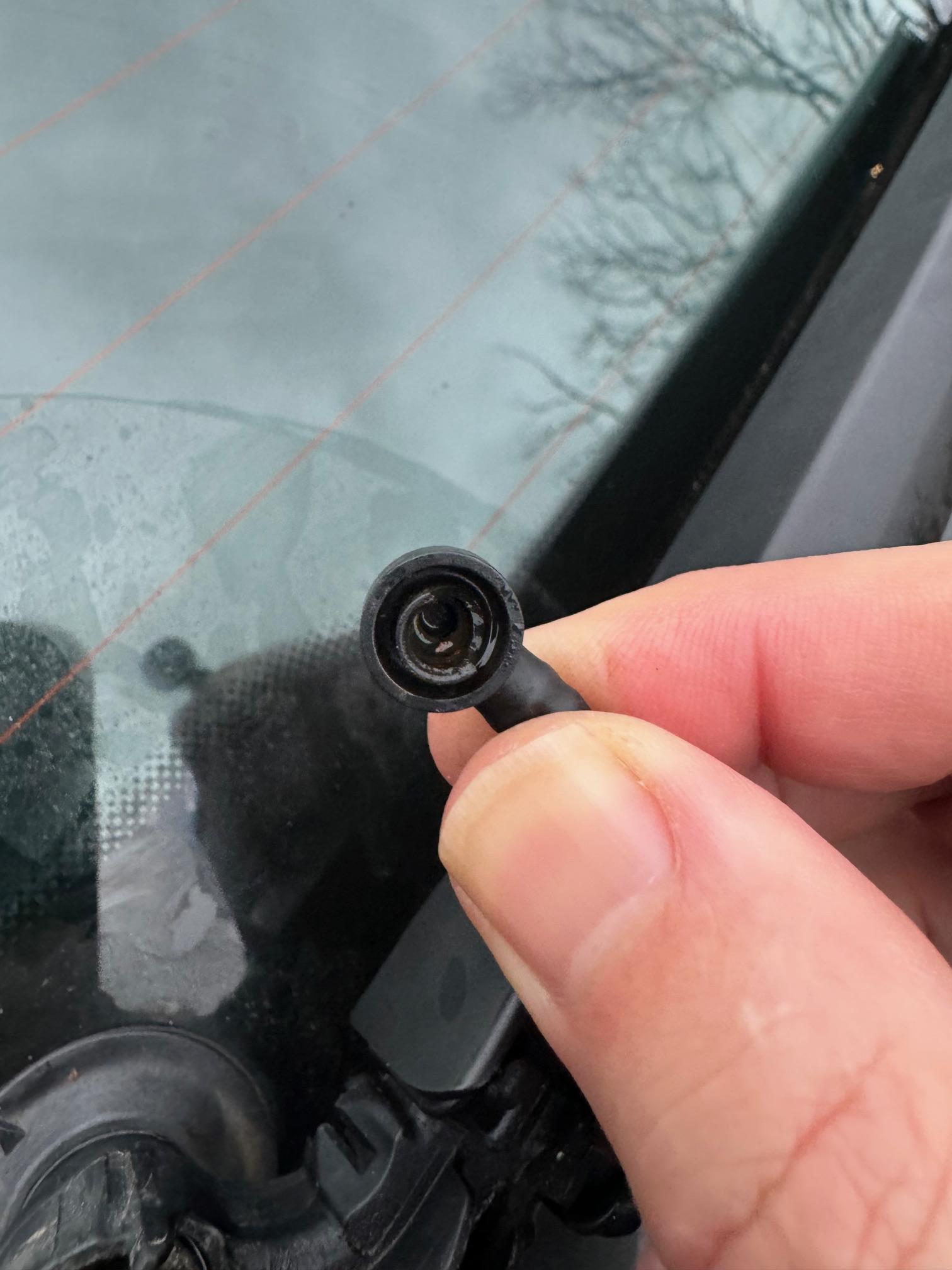

Daniel Ralph Posted January 21 Author Share Posted January 21 9 minutes ago, Stevey Y said: Hi the nozzle that is under the cap is probably sold as a repair section as the nozzle would have to unplug from the top of the wiper spindle to facilitate removal of the wiper arm, try the dealers. Steve. It’s the black round connector. It pushes onto the wiper outlet and the hose. looks straight forward to replace. Currently screen wash just dribbles straight out the bottom when it’s actioned. i’ll try the dealer. Wish me luck. They wanted £90 just to talk to me about enabling myself as key user… it took 5 minutes over the phone with Audi UK and they remote video checked my passport & V5 over the phone - very neat and “free” obviously Quote Link to comment Share on other sites More sharing options...

Magnet Posted January 22 Share Posted January 22 Hello Daniel, Apologies if this isn’t going to be practical - always difficult to gauge from photos- but can’t you sleeve a suitable small dia. brass/ hard plastic etc. pipe down into the section in the tailgate, leaving enough to push the plastic piece over. Obviously you would need to find a suitable dia. sort stub of pipe, or get one turned down. Thoroughly clean both pieces and Araldite the sleeve pipe in. Easiest way to measure the OD you will need is to carefully insert a drill bit etc. until you find one which is a snug fit. Kind regards, Gareth. 1 Quote Link to comment Share on other sites More sharing options...

Daniel Ralph Posted January 22 Author Share Posted January 22 1 hour ago, Magnet said: Hello Daniel, Apologies if this isn’t going to be practical - always difficult to gauge from photos- but can’t you sleeve a suitable small dia. brass/ hard plastic etc. pipe down into the section in the tailgate, leaving enough to push the plastic piece over. Obviously you would need to find a suitable dia. sort stub of pipe, or get one turned down. Thoroughly clean both pieces and Araldite the sleeve pipe in. Easiest way to measure the OD you will need is to carefully insert a drill bit etc. until you find one which is a snug fit. Kind regards, Gareth. This did cross my mind, but i'd need to find/replace the inner black plastic ring from the above photos and given how much pressure the water must put on it, and the vibration. Plus the opportunity for araldite to go everywhere and make more of a mess. I think replacing the elbow connector with the nozzle variety and the cap with 2 holes is what I'll try first. £15. 4K9955205 4K9955985 1 Quote Link to comment Share on other sites More sharing options...

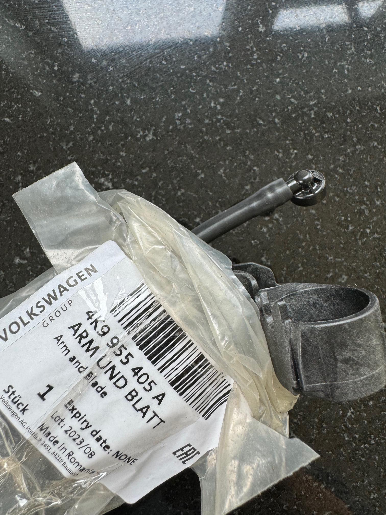

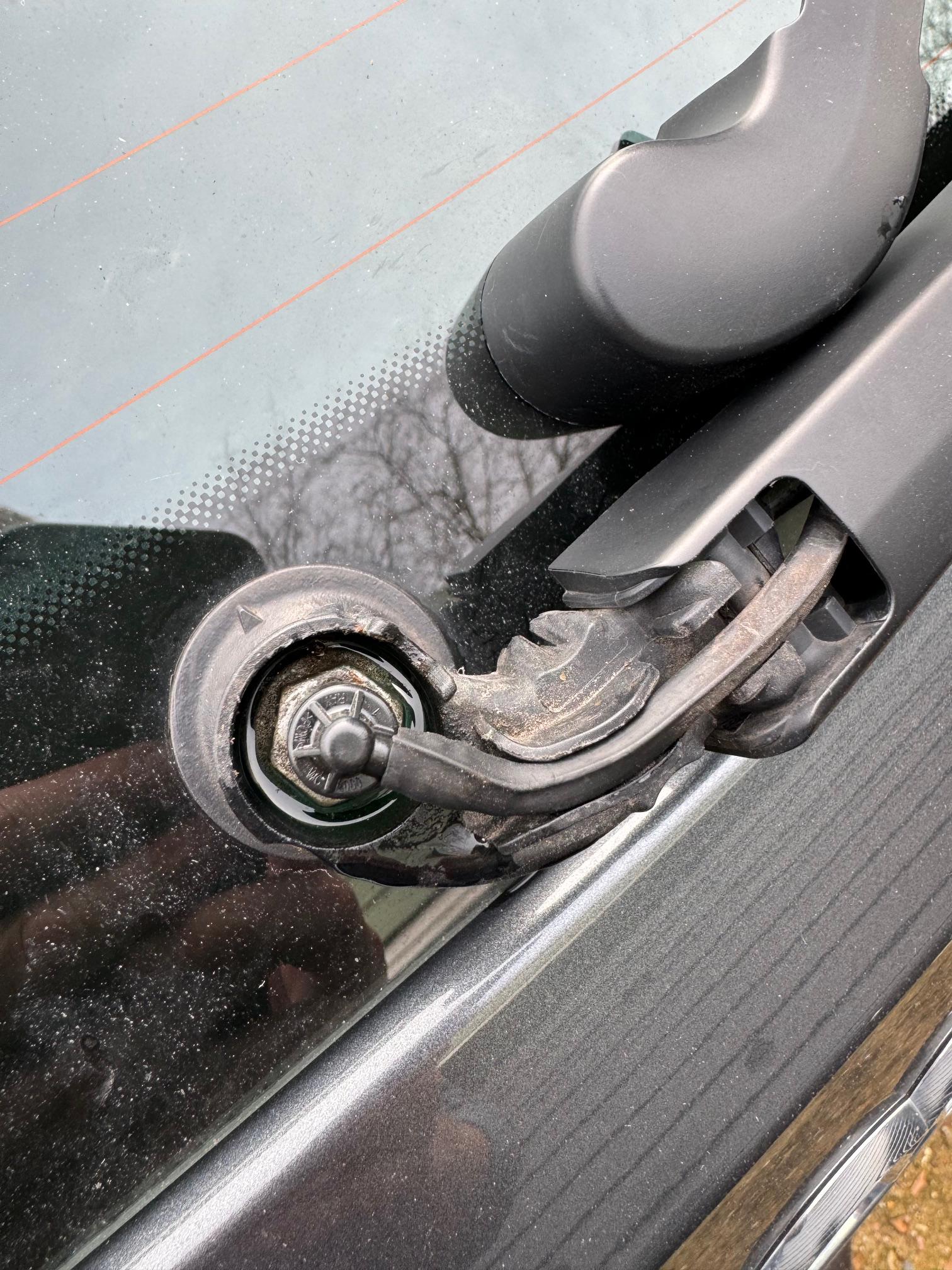

Solution Daniel Ralph Posted February 10 Author Solution Share Posted February 10 How can I edit my title and post ? 4K9 955 405A The above part is for the whole wiper arm with the hose/washer. £50 from LLL parts. I pulled the black plastic connector off and put it on the existing. Shame you can't just buy the connector (or better, the dealer should sort nonsense like this out for "free" - after all it is a £75,000 car as part of customer service) Quote Link to comment Share on other sites More sharing options...
Daniel Ralph Posted February 10 Author Share Posted February 10 On 1/22/2024 at 3:24 PM, Magnet said: Hello Daniel, Apologies if this isn’t going to be practical - always difficult to gauge from photos- but can’t you sleeve a suitable small dia. brass/ hard plastic etc. pipe down into the section in the tailgate, leaving enough to push the plastic piece over. Obviously you would need to find a suitable dia. sort stub of pipe, or get one turned down. Thoroughly clean both pieces and Araldite the sleeve pipe in. Easiest way to measure the OD you will need is to carefully insert a drill bit etc. until you find one which is a snug fit. Kind regards, Gareth. Thanks for replying. I bought 4K9 955 405 A. Whole wiper arm for £50 off LLL. I just swapped the little black plastic connector. The Audi Parts diagram is truly awful. I thought I was looking for the "B" part. Shame the Audi Dealer wouldn't give me the part number to help me find actual pictures. Quote Link to comment Share on other sites More sharing options...

Daniel Ralph Posted February 11 Author Share Posted February 11 On 1/30/2024 at 9:13 PM, Waldo said: There is a design fault with this wiper washer. Constantly blocks and detaches. Audi not interested. Thanks. Just an update to MARKED SOLUTION. Whilst the black connector was broken and I replaced this. Turns out the rubber tube (which has pin prick holes along it) and jet nozzle at the end of the tube was blocked too. So I've replaced the tube/nozzle & connector. All working now! Which was fun as I obviously ran out of washer fluid during testing, which made me think I was going mad. LOL Hopefully the rear wiper will last another 5 years. £50 for a rear washer arm every 5 years is not the most expensive Audi bill I've had. It sounds like the motor and the tubing are future "opportunities". Quote Link to comment Share on other sites More sharing options...
