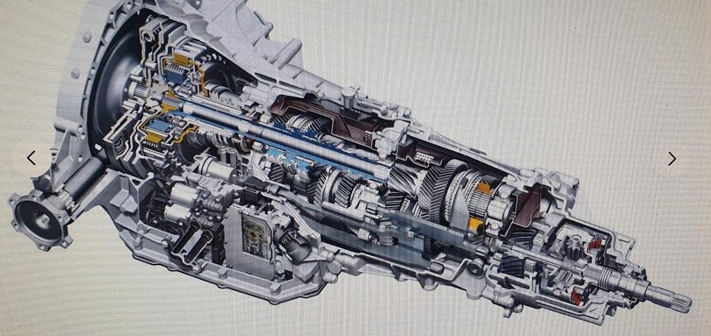

Another question surrounding the failing of an S-Tronic box
So firstly Hello as a Forum newbie ! but not new at all to Audi as a brand, I apologise if this is a little drawn out but I'm definitely old school and been around the block a bit when it comes to cars, all will become apparent.
I'm going to be straight up from the word go here regarding my Audi journey, I first came to the brand way back in the 80's with my first Audi 100 and later the same but in an Avant, over the years I've had classic early 80's and later a couple of Quattro's from circa 1986 on a D registration and a 1987 on an E registration, I had two Audi A6's into the late 90's and by the 2000's I had worked my way though another A6 and an A8 ( business was good and so were the cars ) ........ BUT .... then I bought a 2009 A6 2.0 TDi Avant with the multi-tronic gearbox and it was nothing but a disaster, three times over 100,000 miles it had serious gearbox issues, so much so that when the last attempt to repair didn't resolve it I simply had had enough and I foolishly traded it in for another 2012 Avant, again with what I hoped would be a better experience, within 70,000 miles it too had failed and I decided there and then to go over to the dark side and bought my first 330d BMW Tourer, in 90,000 miles it never missed a beat, that gearbox in my mind was bulletproof and silky smooth, in late 2016 I sold that and got me a 530d M-Sport Tourer, again I did many European work trips and it never gave me a moments problem, in 2018 I had a life changing experience which focused my mind pretty intently to say the least, I sold the business, moved nearly 200 miles away from my home town and went to live on the West Coast of the UK, I didn't drive for a while, but when I did I bought a BMW 320d Tourer loaded with everything you could want and used that sparingly up until a few months ago, again I have to say that Auto box was faultless and it had 113,000 miles on it when I sold it ........
What has all this got to do with a post in the A7 section of this forum I hear you ask ? Well, not long after that a very good friend of mine offered me his 2011 Audi A7 3.0 TDi Quattro 250bhp S-Tronic which he had had since 2013 and bought from his local Audi Main Agent, I knew the car very well and it has always been serviced on time, had a full gearbox service and adaption at 60,000 miles, has the original purchase invoice with nearly £18,000 of factory extras, and every MOT from new, every service stamp, and every single invoice for anything he has bought or had done over his ownership, needless to say I have always admired the A7 3.0 TDi "Quattro" and with little persuasion I happily bought it as my motoring needs are simple now with rarely any long distance or European driving. It has now done 120,000 miles but I kid you not when I say it looks like a five year old car in and out, not even a car park or supermarket dent on it, not a single warning light or electrical fault, in fact it drove faultlessly ! ..... Note I say "Drove" not Drives ..... Last Friday I did a 400 mile round trip to Kent to see my elderly mother, on the way there I pulled into the services on the M25 at Fleet and as I slowed down on the slip road and into the car park the gearbox jolted and thumped slightly as it changed from 2nd to 1st, not harsh but noticeable, as I came to a stop the yellow "No reverse Gear" warning flashed up and indeed when I put it in reverse nothing happened !  a little stunned that history was once again repeating itself I turned it off went inside to grab a coffee and a re-think about my journey, when I returned it started as normal, no warning light went into reverse no problem at all ? off I went up the Motorway and all was smooth once more, fast forward as I came into Tunbridge wells and at the first roundabout off of the motorway as I slowed down once more it jolted into the last two gears and the dreaded "No Reverse" came on again, as I pulled away the change ups from 1st to 3rd were jerky and slightly higher revving than usual, luckily ( or unluckily) I've experienced similar before in the past with Audi and used the technique of knocking it into Neutral and coasting to a stop before engaging Drive again to pull away.
Long story short I made it my Mother's by this technique and every time I shut it off the warning goes away, reverse returns and you can you can drive it with impunity providing you don't do any stops from 7th gear to 1st, around town and in low gears its sort of fine, and it drove back the nearly 200 miles without fault until I stopped in a petrol station where as I came to a halt the yellow warning and "No Reverse" returned, but turned it off, went and paid and when I restarted it had gone again and all was well ?
I like to think I'm not a novice or no clue mechanically having owned and supplied parts for Motor Vehicles (especially classics for many many years ) I've read many of the technical bulletins on these gearboxes, watched untold amount of professionally made You Tube videos from gearbox specialists, Mechatronic reconditioning companies, long term owners etc on the perils of the S-Tronic 7 Speed DL-501 which I believe my vehicle has, I have lost count of the amount of stories online concerning symptoms of this gearbox that Audi themselves farm out to other garages, quote for a New Gearbox, or simply don't want to touch the older out of warranty examples, I know I could go down the route of DIY programming, holding the throttle down for 30 seconds etc ( in fact done that, works for a day only ) or have a reconditioned or later circuit board Mechatronic unit fitted and hope that works, as an aside there is no burning smell whatsoever so hoping the clutches are good as this has only just started to happen in past few days, Its mainly the jerky, slightly clunky downshift in low gears ( 1st & 2nd) throwing the warning light, everything is smooth and silky, and as I say it goes away every time you turn it off and sometimes depending on how you come to a stop in traffic it doesn't happen, but at the next set of lights or queue of traffic it will ?
Sooooo .... my question here is really to any Tech Guys on this forum who know their stuff, have experienced this problem themselves, or have fixed this fault by way of "Pattern" parts or non manufacturer parts ( which I can probably source through my contacts ) but just thought I'd ask the question as I'm always open to "Good Sound" advice, no guessers or "Go to a Main Agent" advice please, I'm a bit past that and am cynical for a reason with my dealings with Main Agents on older higher mileage vehicles ( of any brand ! ) although in fairness some are way way better than others.
Its an old but really lovely thing, seeing is believing but I'm not about to throw silly money at it, sensible yes, but not silly.
Thanks Folks, sorry to have waffled on, I hope you are enjoying your A7's as much as I was enjoying mine ! ............ Vehicle specific targeted advice gladly welcomed.
