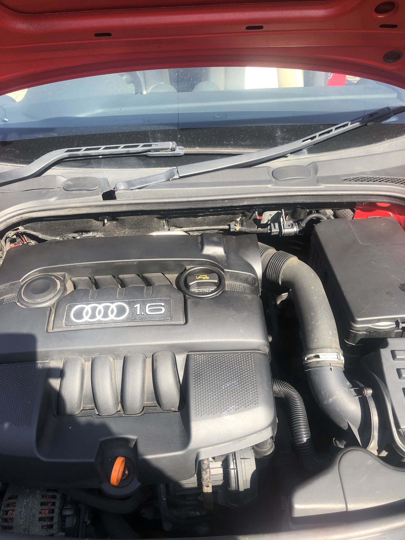

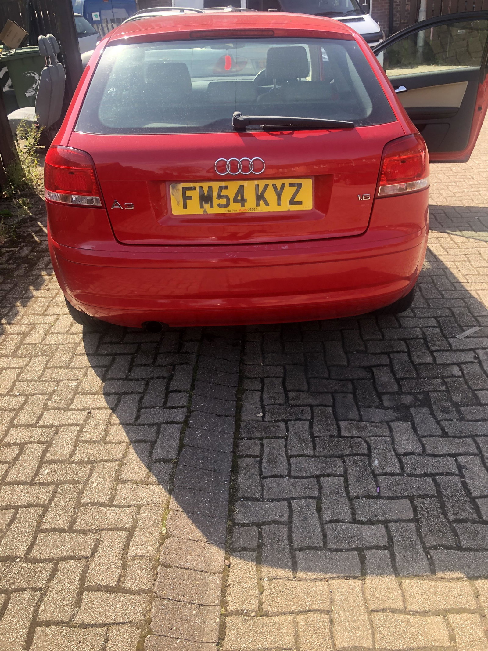

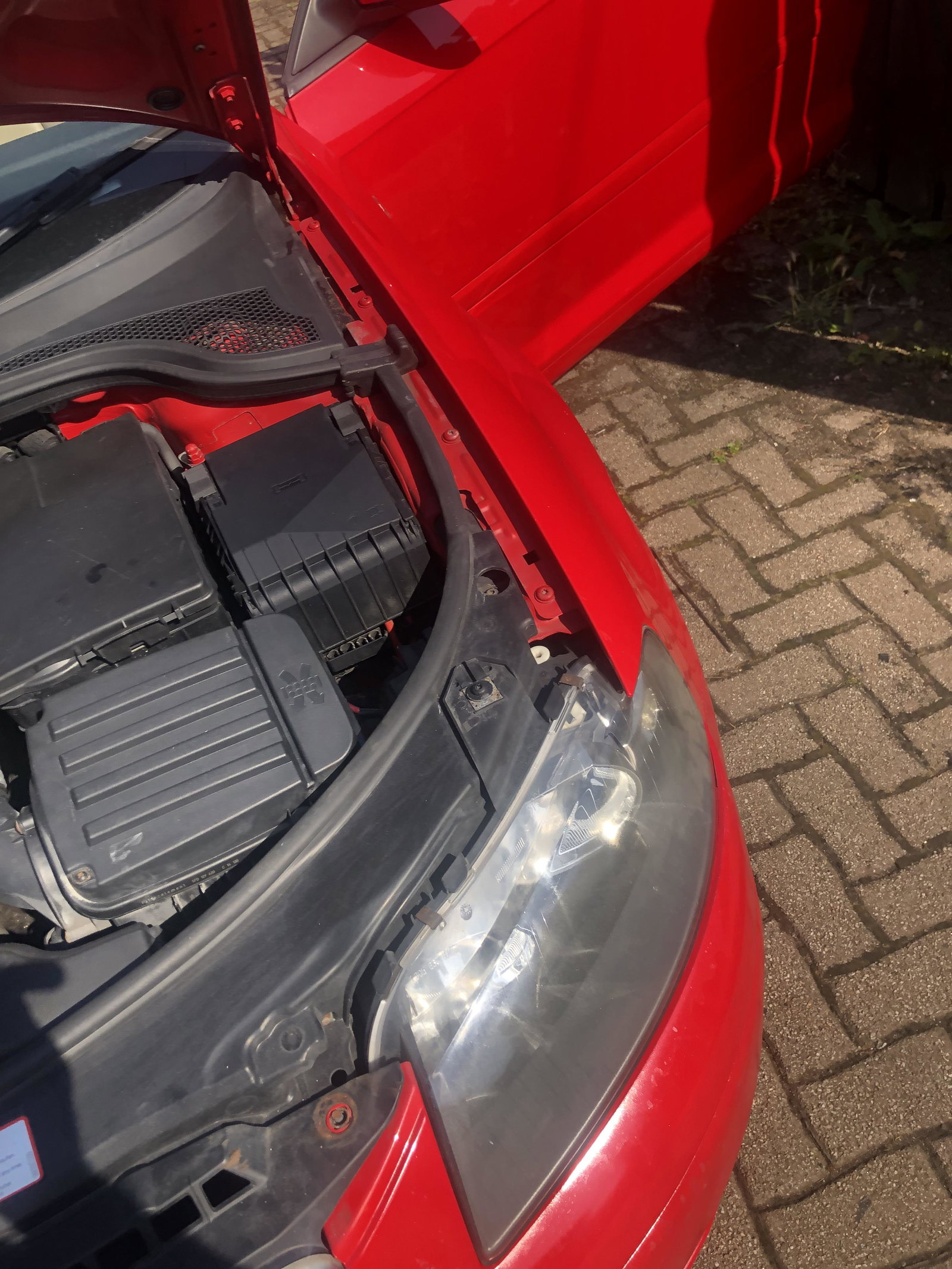

2004 AUDI A3 SPECIAL EDITION 1.6 PETROL  JUST  PICKED UP  CLUTCH PEDAL ON FLOOR   FORGOT I BIDDED ON  IT ON EBAY  AS  MOTHERS NOT WELL  SWEET AS NUT LIKE   FEW BLEMMISHES  BUT  MINT INSIDE  COULD DONE WITHOUT IT AT MIN LIKE  BUT DID NOT WANT BAD FEEDBACK    JOYS FORGETTING  LOL
Release bearing hydraulics likely to have gone Kev? Simple enough clutch - no DMF here!

Probably the slave cylinder, ours went in the sharan, the pedal slammed back although still drivable you had to flip the pedal back up.
Not good.
