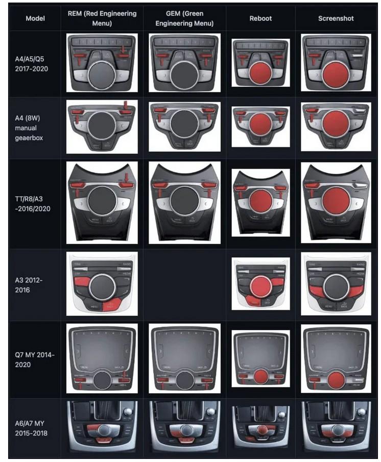

I've checked all the online vids about resetting the MMI system with Menu, knob and top right buttons, but I only have 2 buttons around the centre knob, not 4.

So, bizarrely the probelm appears to have sorted itself out. However, I have managed to find all the reset button movements for the car which is a plus!
