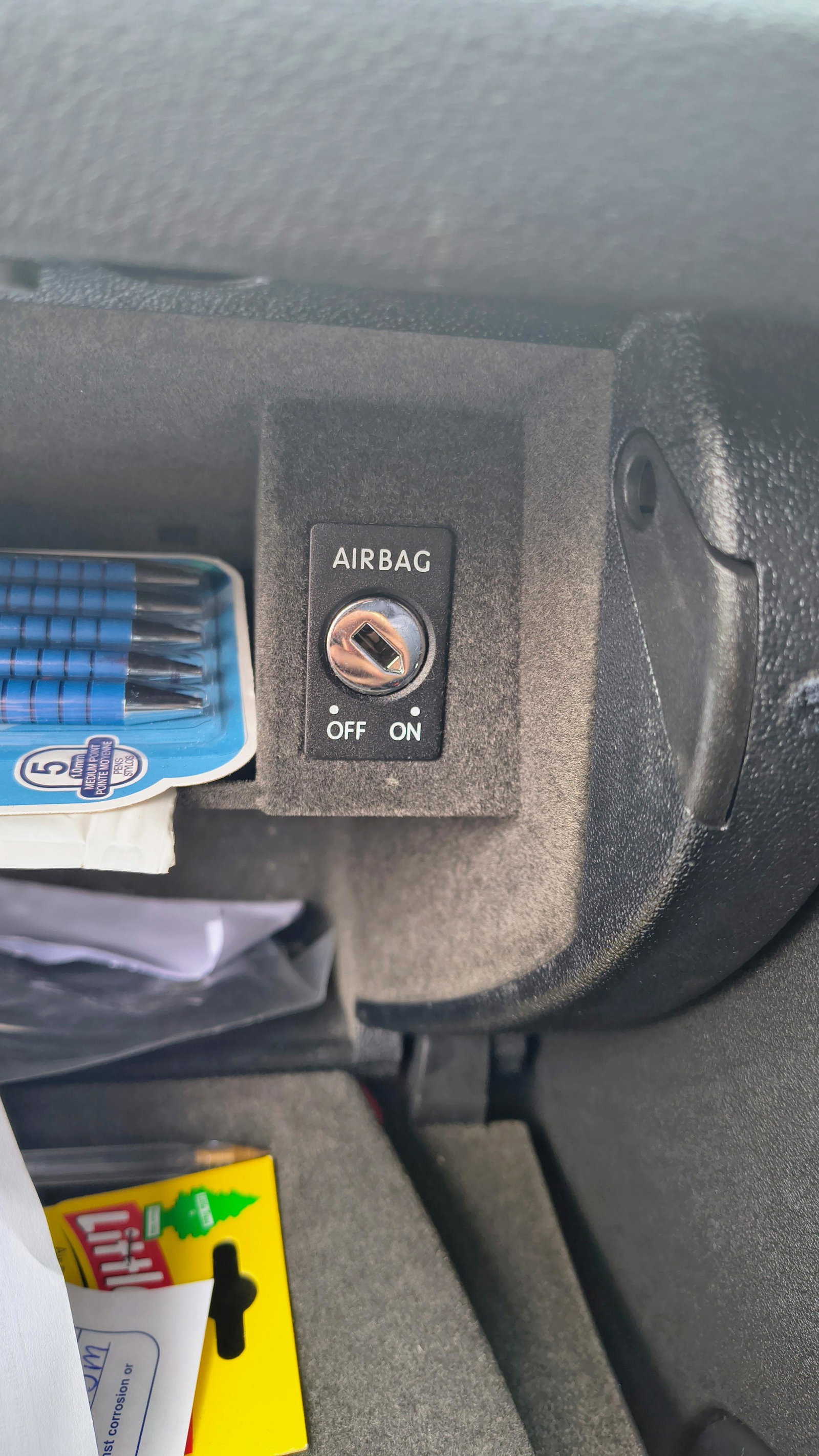

Yes it's the multi plug on the glove box, I had this just the other day, I was messing about with my head unit, while I had the glove box removed the light on the dash and in the binnacle were illuminated, the glove box had the passenger activation key switch inside.
Switch off when connecting it back up

What switch is this, and where about is it please??
When you remove the glove box, the is a cable connected near the footwell light, has 5 wires I think, this connects the footwell, glovebox and this
