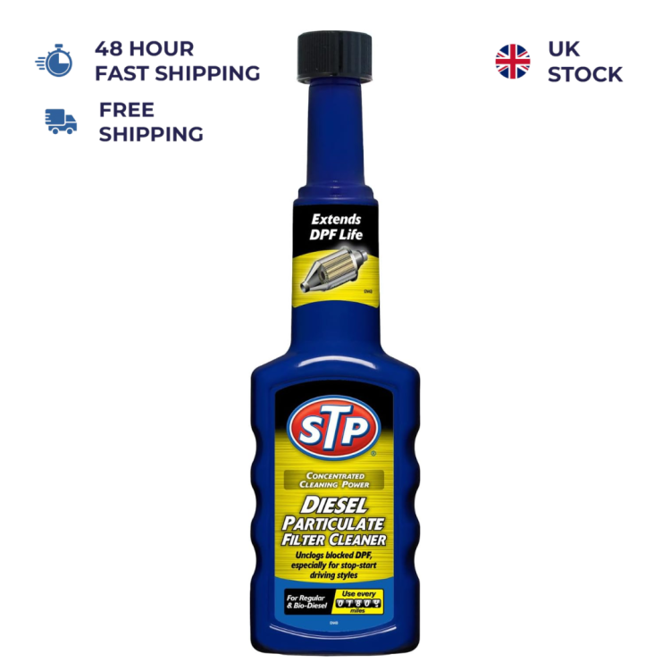

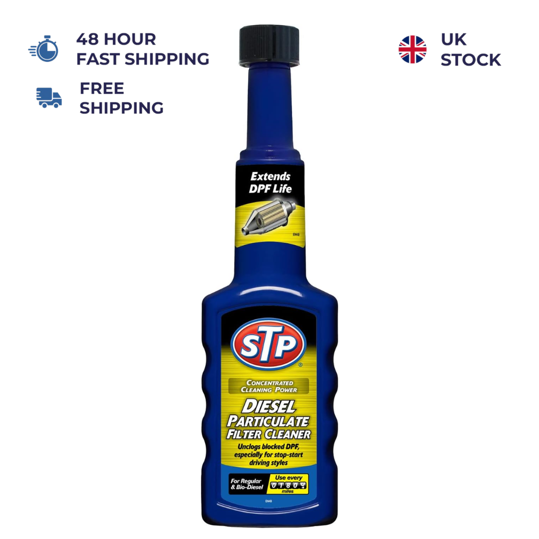

gsmdo Posted 23 hours ago Posted 23 hours ago Hi all, Not been here in a while, as the convertible is behaving itself... 😆 However, the other day, the DPF light came on, along with a beep. I dealt with it as I usually do, by taking the car up the three-mile bypass at 70 in fourth gear - an Italian tune-up. This has always worked in the past, but not now... 🤔 So, I bought a bottle of this stuff... ...which arrived this morning. I've put it in the tank, but haven't taken the car out yet. If it works - huzzah! - but what advice if it doesn't? 🤔 Cheers, Mike 😎
cliffcoggin Posted 23 hours ago Posted 23 hours ago While I am sceptical of these fuel additives, I am open to persuasion by long term results. The treatment may solve a sticking pressure switch in the short term but I question if it can solve the more fundamental problem of the exhaust system being blocked by soot, which is what the DPF switch is telling you. If the treatment fails to work I understand it is possible to induce an exhaust regeneration with VCDS or similar equipment. Others here may be able to confirm this point. 1
