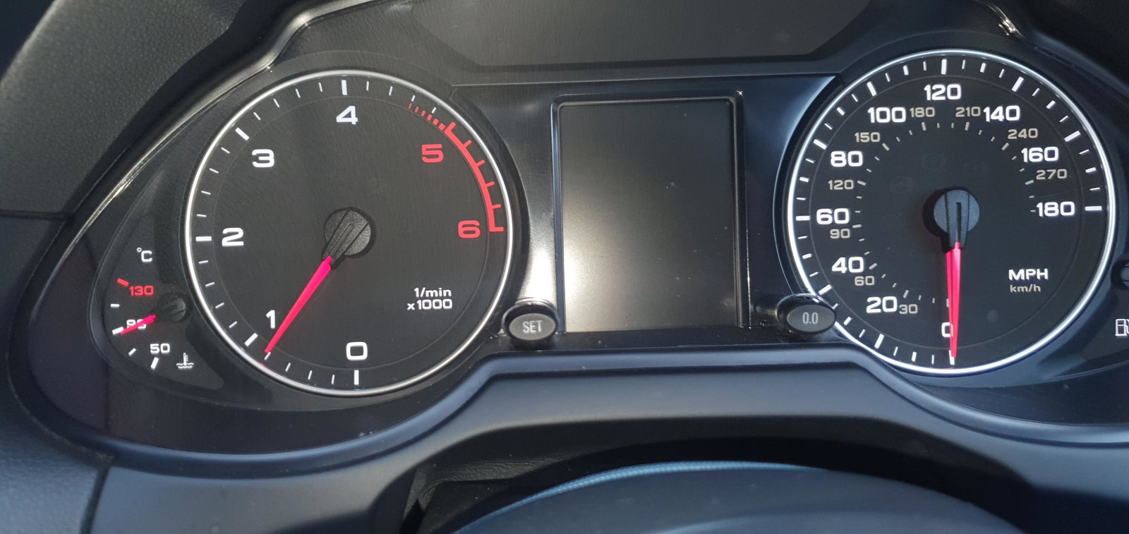

Looking for advice. The square display between the dash clocks on my Q5 has gone blank...worked fine then didn't. I have also noticed the seat belt warning no longer sounds and the cruise control doesn't work. Anyone point me in right direction. Thanks.

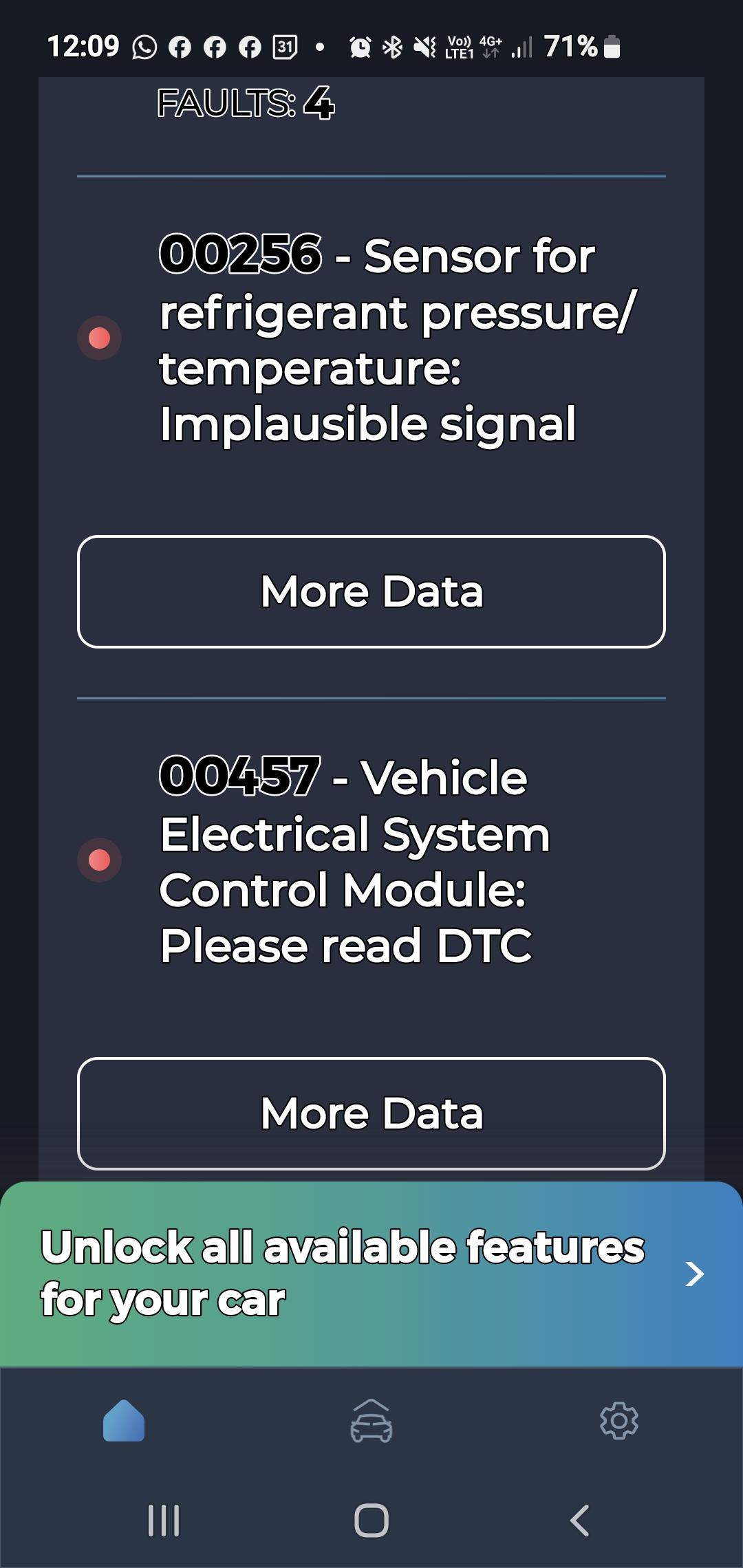

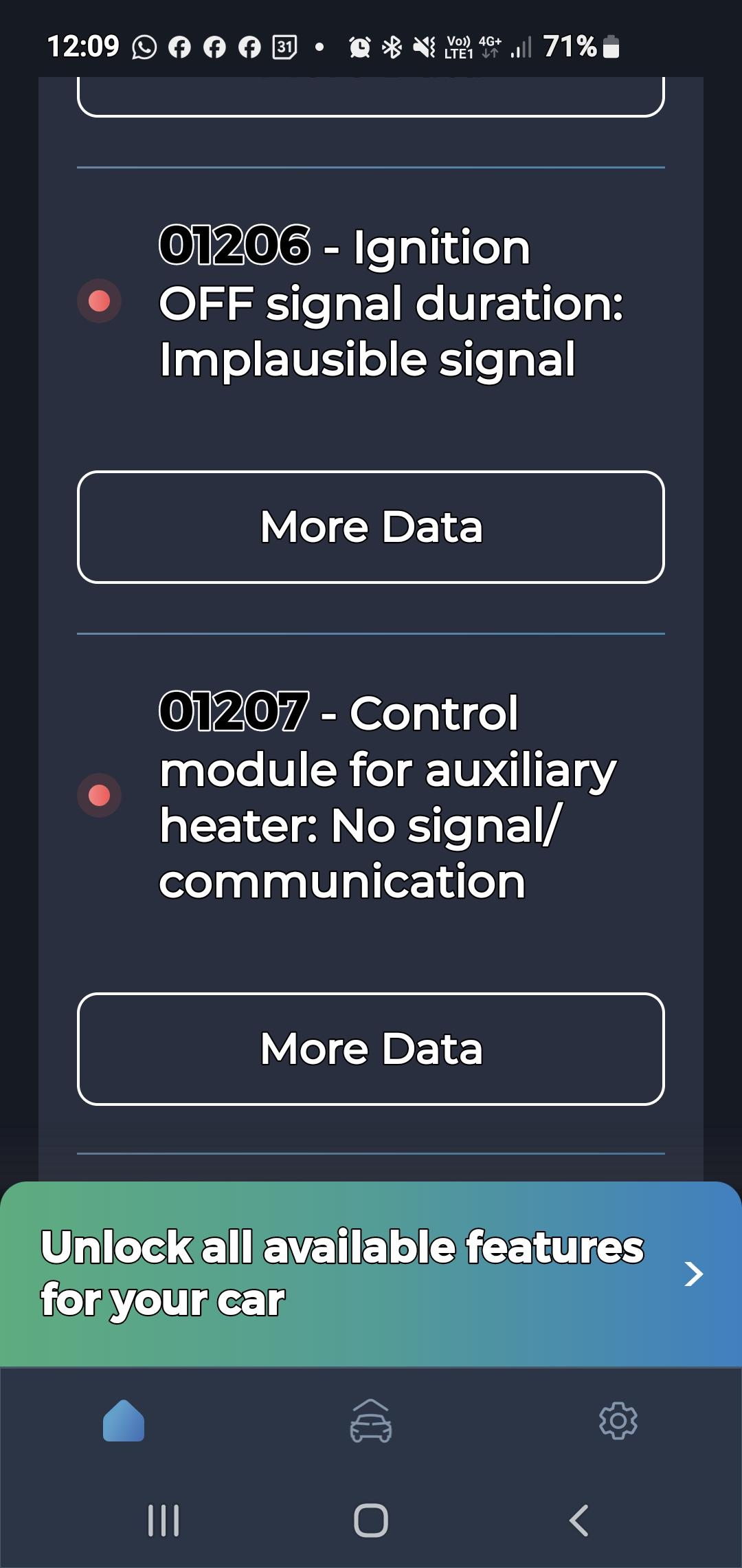

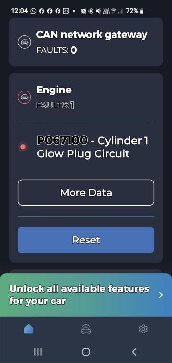

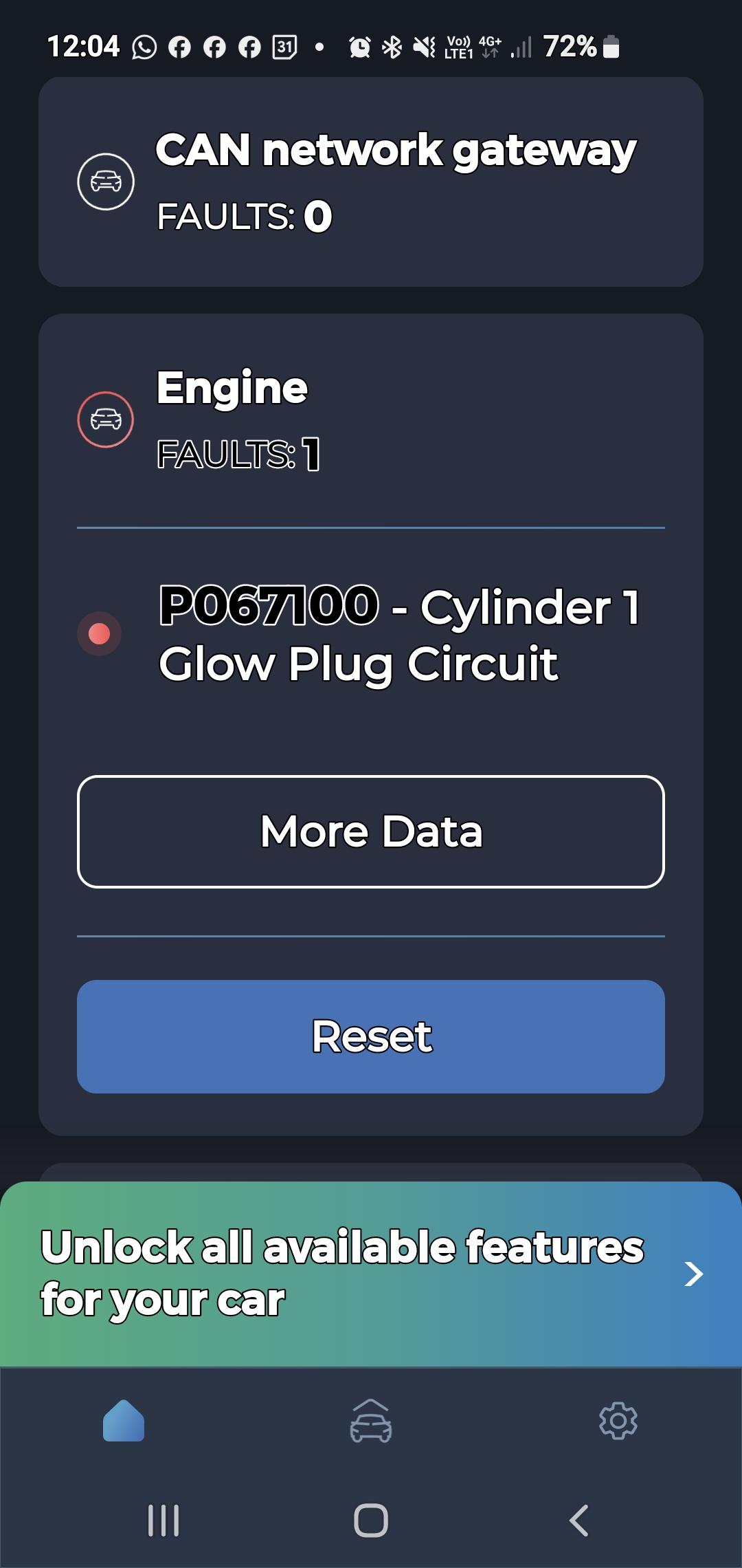

Will do. I've done a basic scan with my carista and got a few codes but none that really point to anything specifically related although the 00457 code may??? Never had the glow plug code either but will look into that.
