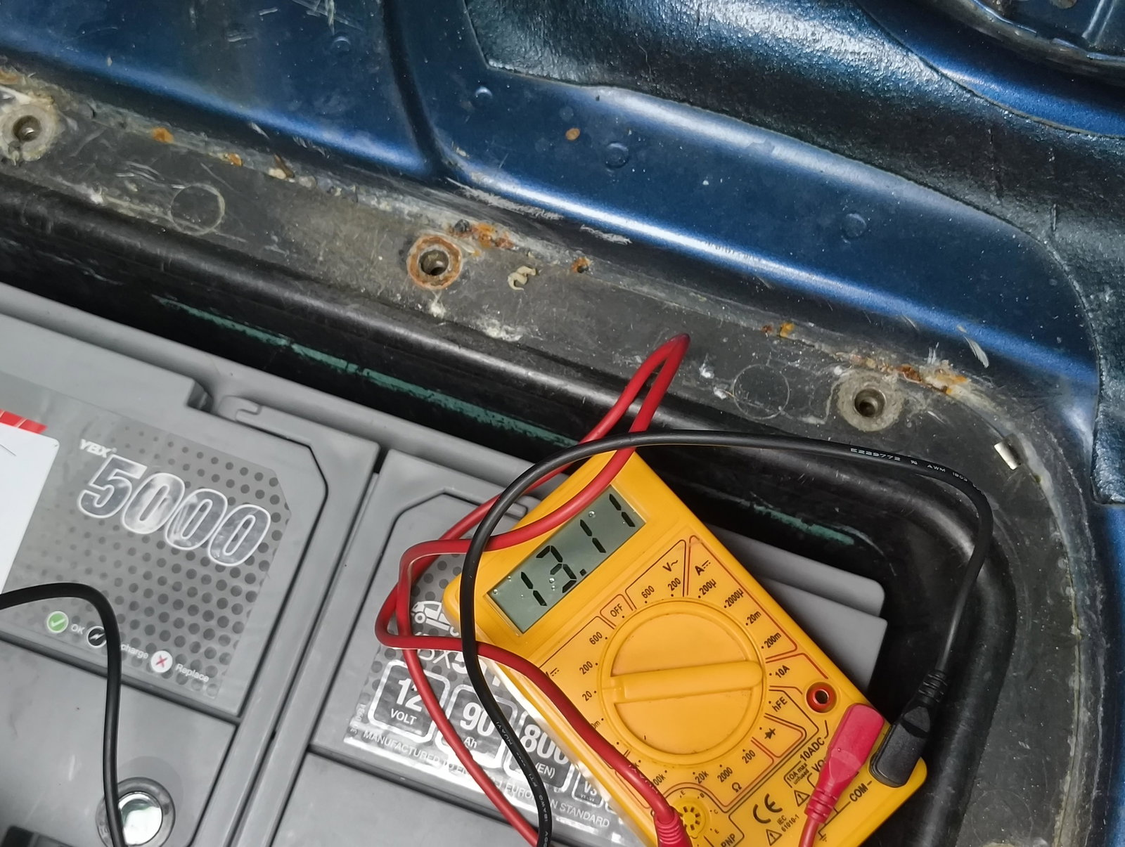

I checked the battery the last time there were no dash lights, no ignition etc (This was just after driving for 40 minutes) and it was fine at 13.11 volts, brand new battery with the green indicator.
Sent the clocks off to ECU Testing and they confirmed an error (Didn't say what), so had them back today. Here is the email I just sent them:
When I reinstalled them, the car was still completely dead, no dashboard lights, nothing, no ignition.
The battery is a brand new uprated Yuasa model with a green indicator and a 'car off' multimeter reading of 13.11 volts as can be seen in attached picture. (Voltage 13.93 when the car was running)

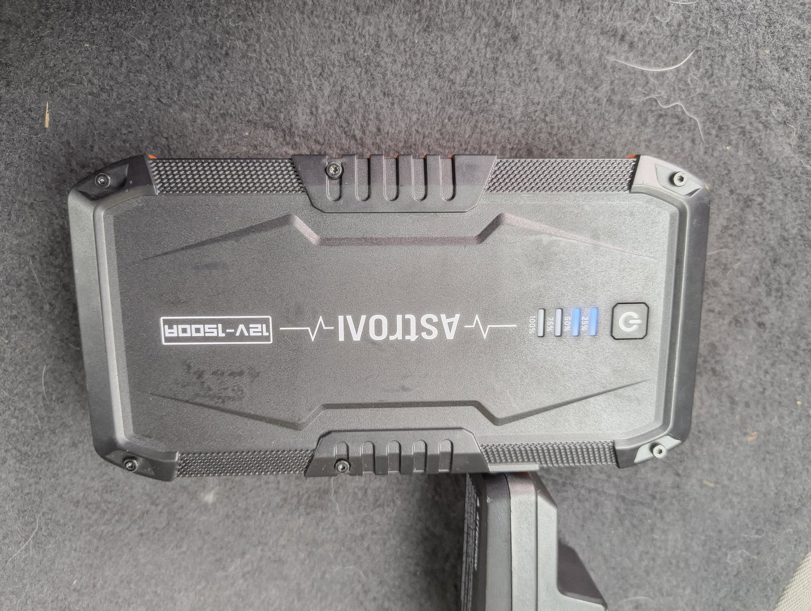

I had to connect my Astron battery booster pack and then the car started. I left it five minutes, turned off the ignition but the car was dead again. I boosted it again and then let it run for longer and it finally restarted after I turned the ignition off and on.

The voltages of 13.9 and 13.1 strike me as a little low, though that may just be an inaccurate meter. It would be worthwhile getting the battery and the alternator professionally tested, mutimeters are inadequate for that job.

As you wish Michael, but I can state that a simple multimeter voltage reading is useless in determining the condition of a battery. Only a deep discharge test under a heavy load will reveal internal faults, hence my suggestion of a professional test. See this:

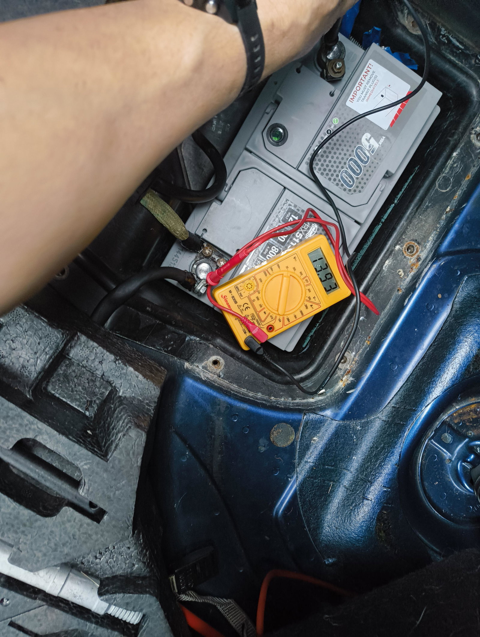

I did a bit more testing just now and I think perhaps the alternator is faulty.
Car has been standing now for about 6 hours since I let it run when I reinstalled the clocks.
'Car ignition off' battery test read 12.71
'Car ignition on' battery test with no electrics switched on was 13.62.
'Car ignition on with all electrics on' battery test was a lowly 12.33.
I kept the multimeter on the car whilst engine and all electrics on and it was on 12:45 and dropping.
Car on but no electrics slowly rose to 13.8.

Pleasure Michael, but why are you booking it in to have the alternator replaced, before you have positively identified it as one of the a culprits? Similarly get the battery checked as Cliff recommends.
It just isn’t  good and logical practice to get components renewed simply because you believe it is faulty, and prior to having it tested to prove/disprove it is at fault.
