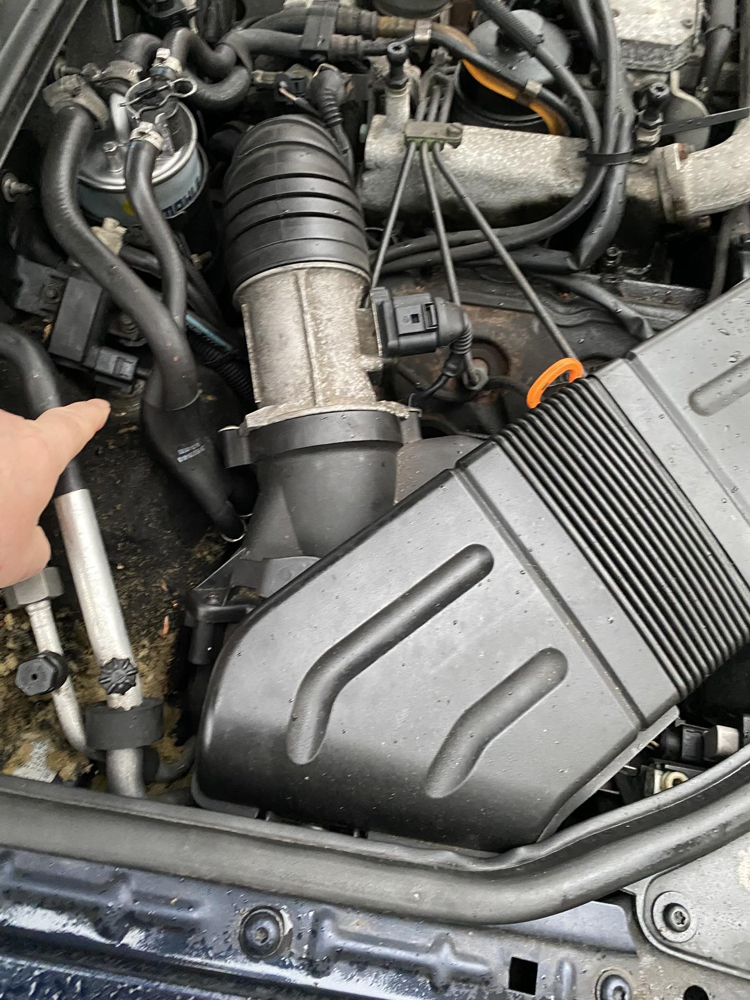

Is it engine code BAU (132kw)? Search on Autodoc quoting your registration. My understanding is they are 3-pin hall sensors, and will be located near or behind timing belt cover on both banks. You can also double-check on LLL Parts and access diagrams (likely under electrical), not engine.

The list of sensors on Autodoc show a 3 pin connector. I think I've found that position. I'm pointing to it the the picture attached. It disappears behind all sorts but it looks like the sensor will be on the back of the block offside. I will need to remove the air intake to be able to see better but I'm going to wait until the weather improves.
I've looked on LLL parts and they don't list my model which is confusing
I'll take another look later on. Autodoc can be a bit of a lottery unless you have Audi part number to cross-reference. There's also erWin (pay to view).
Thanks Spartacus 68
That's why I'm trying to locate its position so I can remove it and hopefully get a part number off it. I know I can test if it's working with a multi meter. I guess it will be a process of elimination.
