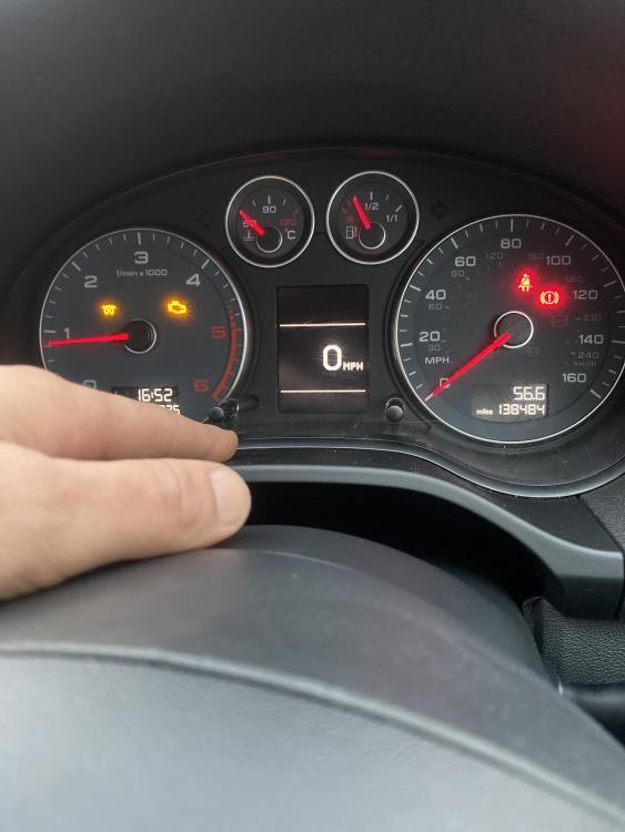

Hi Everyone, got a small problem with my car, well I hope its small. Ive done a lot of reading up the past month and now ive finally got around to posting my problem. Basically at around 80 mph in 6th gear the car goes into chimp, I mean limp mode. I pull over, turn ignition off ,pull key out, start car again and hey presto the beast is alive again. Now ive bought another egr valve and cleaned and checked what I can but now I'm stuck. Pulled the vac box off, cleaned it and checked what pipes I can for air leaks. I'm guessing its the turbo vanes sticking, but this is just a guess due to what ive read up on the net. Can some lovely person help me or give me advise. Really hoping its an easy/cheap fix dude to my financial status at the moment ( no heating, combi blown up ), so having to save to get that sorted too. Thanks for reading this, Paul :)

Hi All, thankyou for all your ideas and taking the time to reply. I plugged my foxwell nt500 reader in and basically says the car is overboosting, hence the limp mode. Looks like its more than likely the turbo vanes. By any chance is any one local to myself in Wirral, willing to fill my ( wait for it ) turbo with Mr Muscle. I have no way of getting under the car to remove the engine tray and take the pipe off the turbo. Ive read up and a lot of people have done this trick and got away with it ( cheap option ) . Obviouslly happy to cover any costs, don't expect it done for nothing. Most garages around me basically want to supply and fit a turbo. Guessing if I cant find someone local to me then I will just have to save up and in the summer get the turbo replaced. Any ideas welcome as per usual. Thanks.
