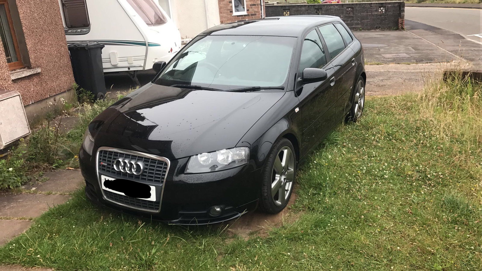

Martyn85 Posted June 25, 2017 Share Posted June 25, 2017 Hi guys my first post, just recently bought my first Audi. It's a Audi A3 2.0 tdi s line model 2007. I have just noticed that the airbag light has come on, I plugged my obd2 reader in and no codes or faults found. Has anyone else had this problem and is it a easy fix? I bought it from a used car garage and they have given me a 3 month warranty. Is it worth ringing them or can I just have a look and try myself? Don't want the hassle of going back and for the dealership. Thanks in advance Quote Link to comment Share on other sites More sharing options...
Steve Q Posted June 25, 2017 Share Posted June 25, 2017 Welcome to the forum Martyn :) youll find the members on here are a friendly and helpful bunch :) nice looking a3 by the way :) first thing I'd do is check your warranty paperwork as I wouldn't be surprised if the warranty is a separate company. If so your best bet is to check the list you would have been given to see if airbags or electrics are covered. If it is through the garage then I'd take it back to them. With regard to the airbag light it could be a simple case of a loose wire or even a faulty passenger airbag switch in which case it wouldn't be expensive to fix. Obviously if it were an airbag then this will be an expensive repair. But also I'd be checking the car for any previous accident damage. Hope iv helped :) cheers steve 1 Quote Link to comment Share on other sites More sharing options...
