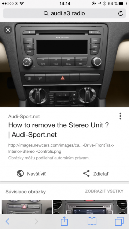

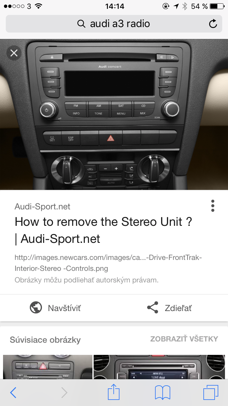

How to listen to iphone music on this radio? Got aux  port by handbrake but cannot find way to make it work
1 hour ago, niedzial1983 said:
Im to familiar with audi chorus or concert units
If you have aux already the  plug in any music device via small jack cable and then you need to select aux on your radio
That why its strange it does have aux input but no option to select aux etc
Hi Patrick
Plug in your IPhone through the aux socket,select a track and press play. now press the CD button until you get to EXT.Source, you should then hear your IPhone music.
In the radio operating manual it is page 23. :rockon:
