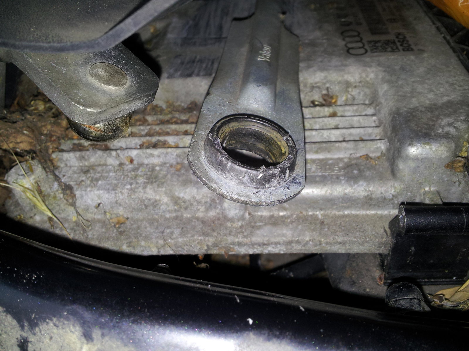

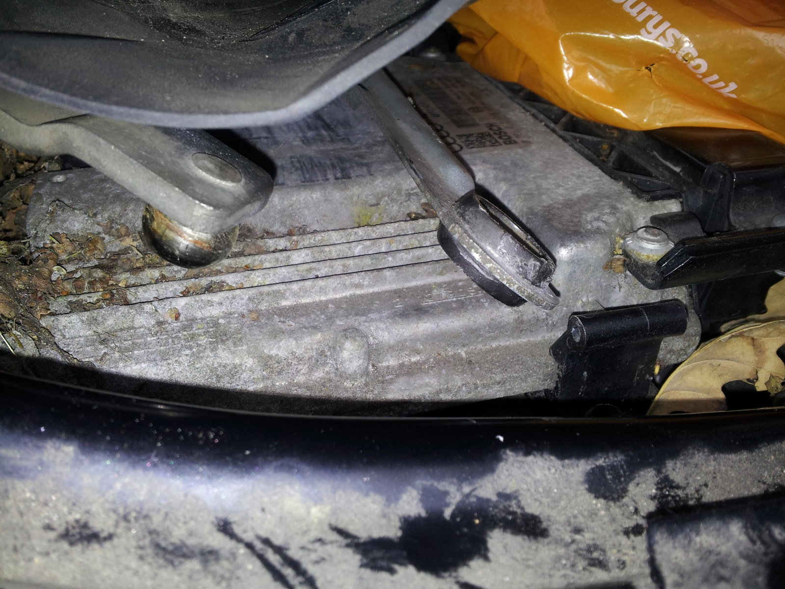

TWIXXN'DD Posted September 25, 2018 Share Posted September 25, 2018 Hi Chaps, I've recently bought some of these clips but find them very difficult to fit,do you need to remove or thin down the circular bushing(as it totals some 15 mm in thickness) I'm trying to do the job with the linkage attached to the vehicle (fitting clip on near side linkage) i've attached a couple of pics here; Your help/suggestions greatly appreciated. Thanks, Charlie. Quote Link to comment Share on other sites More sharing options...
Bigdave1230 Posted September 26, 2018 Author Share Posted September 26, 2018 Dead easy mate. Put the clip on the arm with the hole in it, so the plastic is sandwiched between the clip the offer the arm back up. Then using a pair of grips squeeze back onto the metal ball Quote Link to comment Share on other sites More sharing options...
