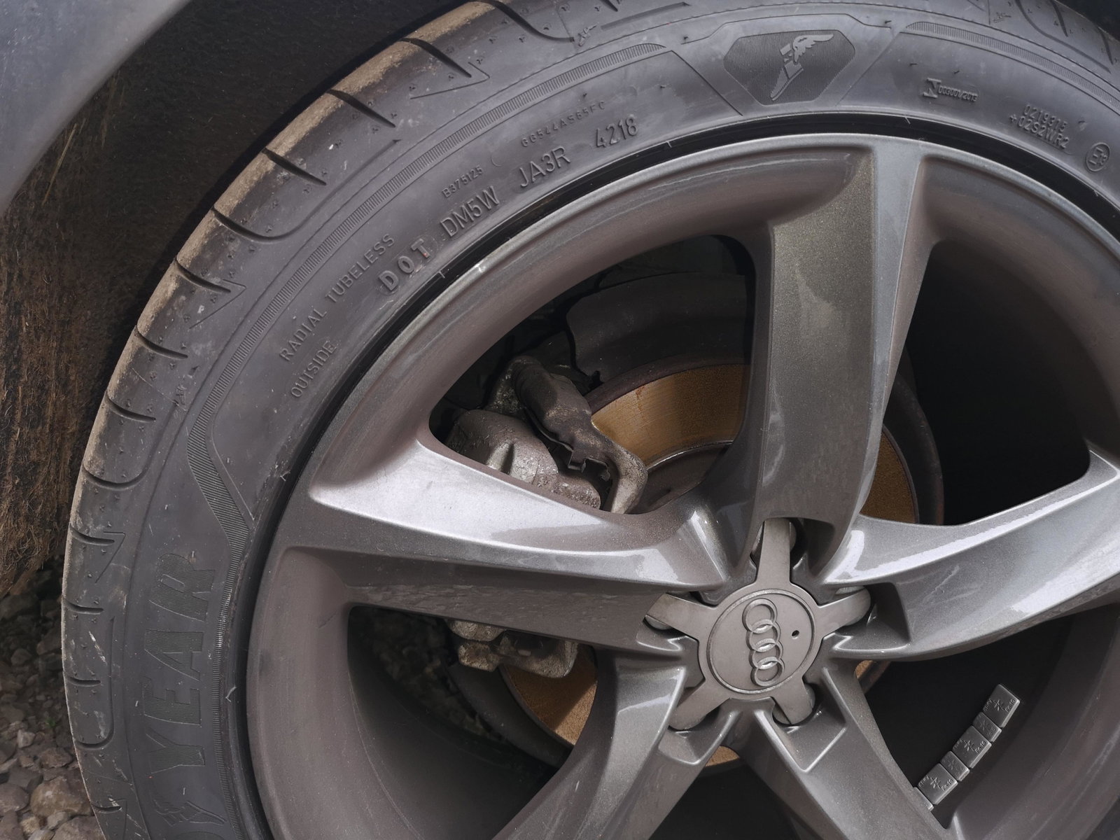

Car breezed through MOT the other week but needed 2 new tyres.. Have a camber issue at the front but the excellent specialist I use knows how to manipulate the front subframe to sort the geometry out.
Had the wheels refurbed in Audi Anthracite...
