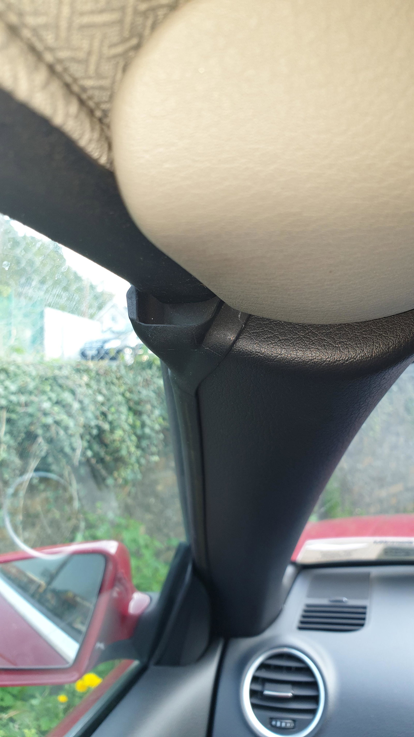

Update , but not in the sense anything got sorted.
On closer inspection, the roof is actually sitting to the right so is off on the side to side axis rather than up and down. On the drivers side, where it sits properly in the seal, the roof is sitting a few mm outside the A pillar and on the passenger side its sitting a few mm inside, so im guessing this is the issue. Im still at the point where I need to try adjusting the roof to move it left so Im going to see about stripping back the headliner at the back and seeing if theres any adjustment in it.
