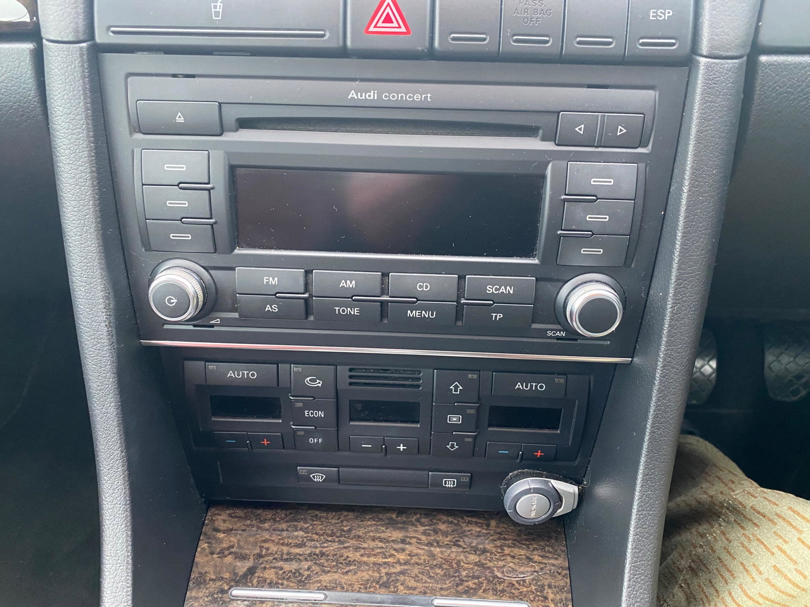

9 hours ago, S-Line said:
Yes Tommy. You appear to be missing little flat black panels that hide whatever is behind the vents.
CDE5F945-9236-49B2-8FD9-4F3187F6125E.thumb.jpeg.d54d1130f0b555990487268b623e3dda.jpeg6AF74A86-E734-43C0-9EFA-CA300F03B65D.thumb.jpeg.093fe5a7702d2a9c89b8df47d04ed4a2.jpeg636FF103-903E-4115-896B-66D9FAD271C7.thumb.jpeg.2f6965dd613409fff782b0d0933bea45.jpegB8EB6774-E3D2-409E-AC79-A269E3C6C293.thumb.jpeg.f22d90b364941c6cd97b69cb36ae4d70.jpeg
Cheers for the assist. Ordered the part today for €10

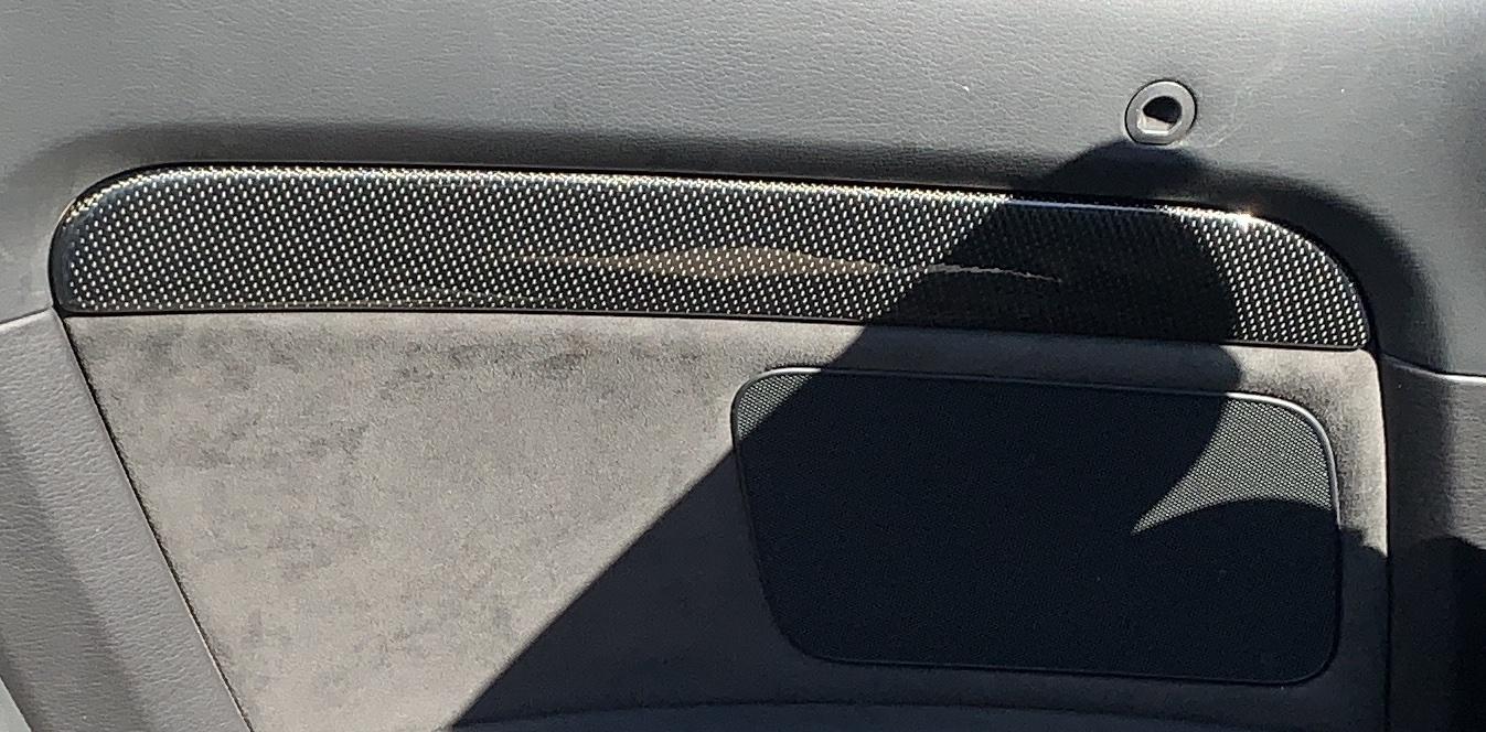

Quick question - did you throw out the old faux-aluminium trim? If not, what sort of condition was the driver's door trim in (mine's a bit scratched)?
Hi Mike, I still have all the bits. There are a couple of seat belt marks on the drivers one but I'll grab a pic of it in the office tomorrow and see if it's better than the one you have
Thanks Tom - it’s not a big thing, but I’m sensing you’re as particular about your car as I am… 😁

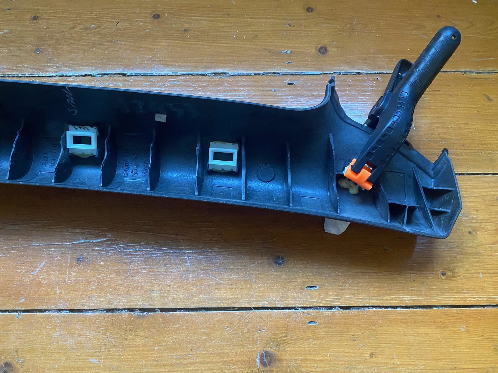

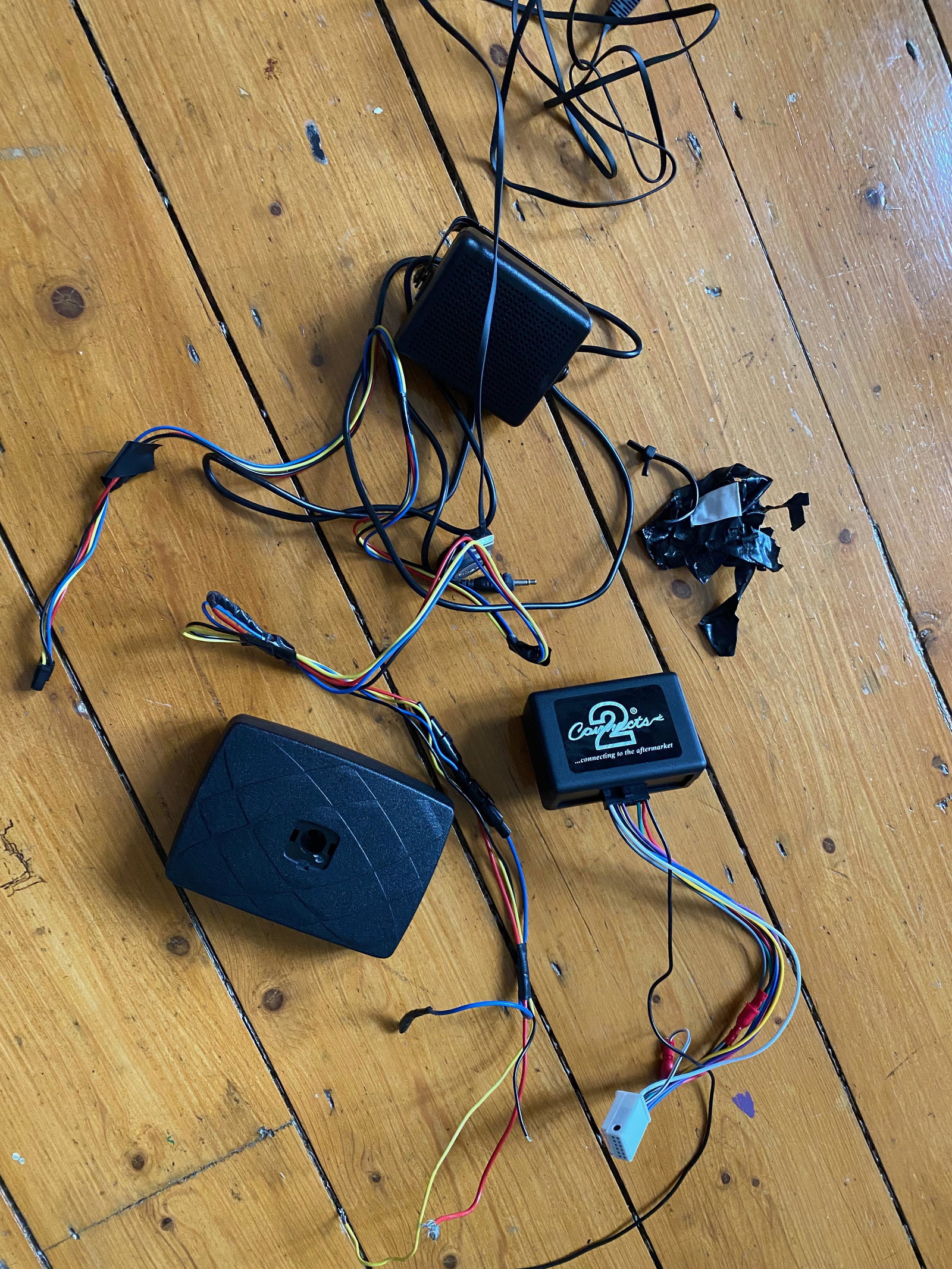

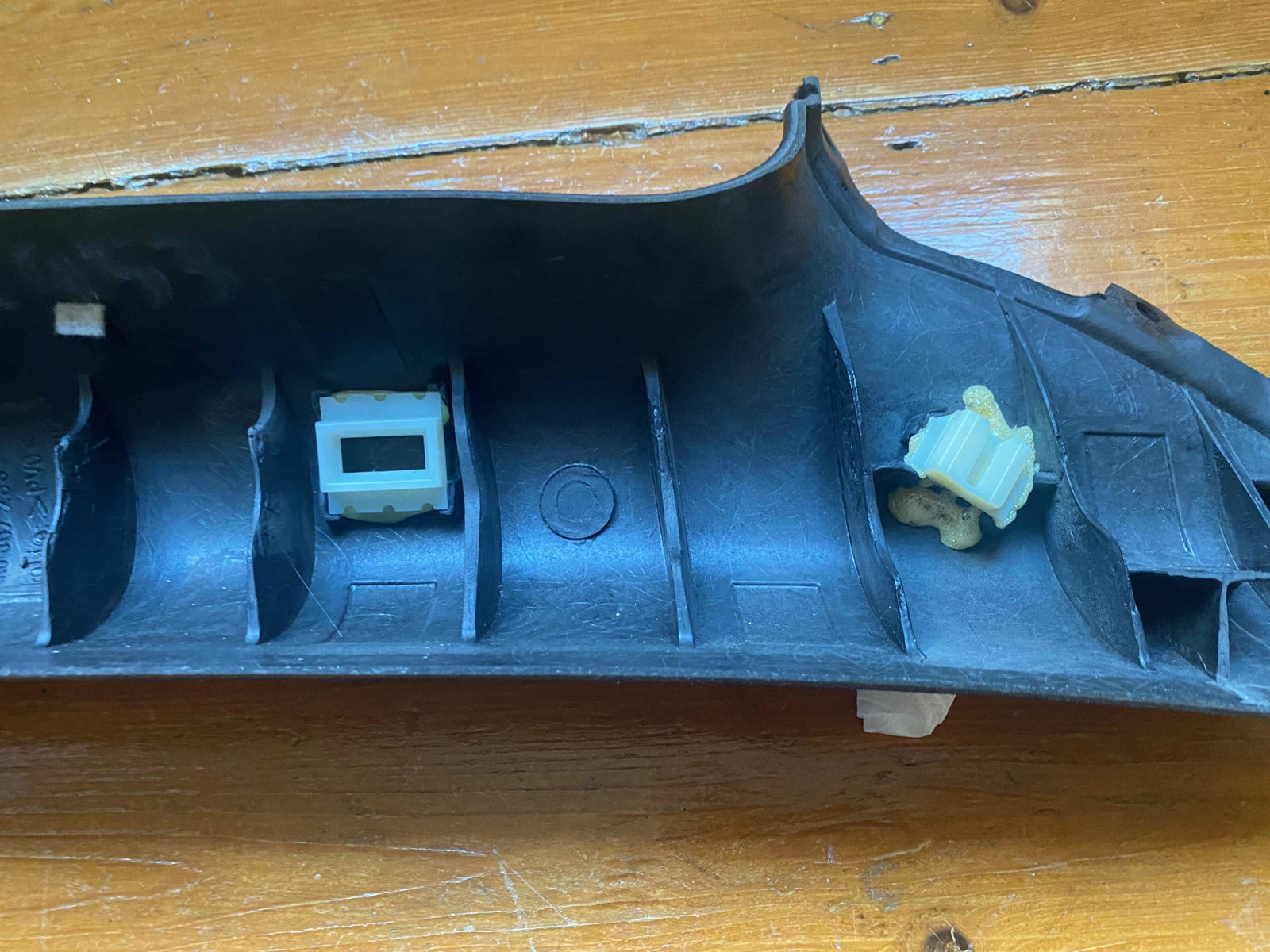

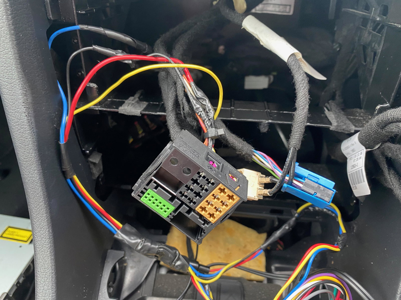

When I got the car it had a Nokia phone kit and a wired aux in for music but I wanted something much better so that I didn't have to plug in my phone like a savage. I bought this Dension unit, there is a better one if your car has MFSW but mine doesn't
You have certain control from the stereo and it's 100 times better than what was there. I did this in April and didn't fit the mic as it would necessitate removing the trim around the windscreen and it was too wet. I pulled it all off yesterday and found that the person who did the earlier install had broken some of the clips and seriously bent the metal spring clips. I was able to bend the metal to an acceptable  standard and re glue the clips with Gorilla glue. If you haven't used this before, it's simply the best available for gluing trim clips back on. A little water to activate and a clamp or two to help it set.  Removing the glove box was a little tricky because my car has the cool box/ fridge and there is the AC vent in there which needs removal. You need to reach in and unscrew the vent.IMG_1586.thumb.jpeg.0132e22e5228d3bc298f900753997856.jpegIMG_1587.thumb.jpeg.fc793994c194702cd54be517971689d8.jpeg

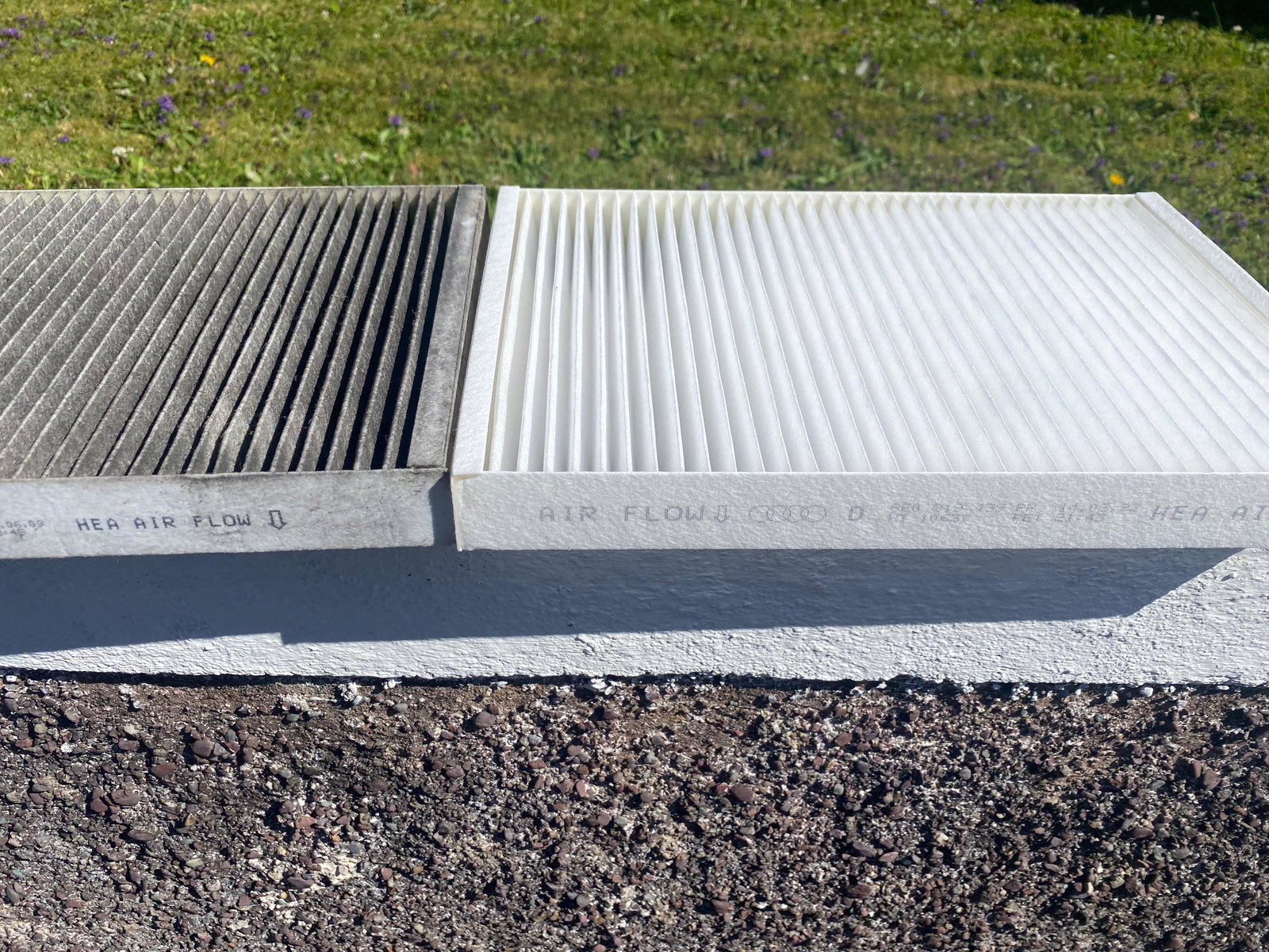

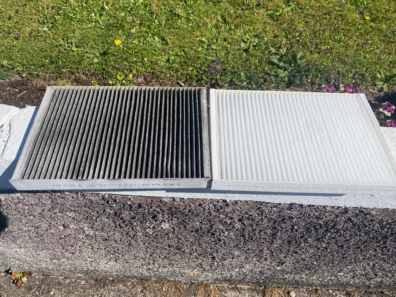

Since I had the new pollen filter, I pulled out the old one and replaced it. It's a 10 minute job. Check out the difference
There is an arrow to indicate the airflow direction

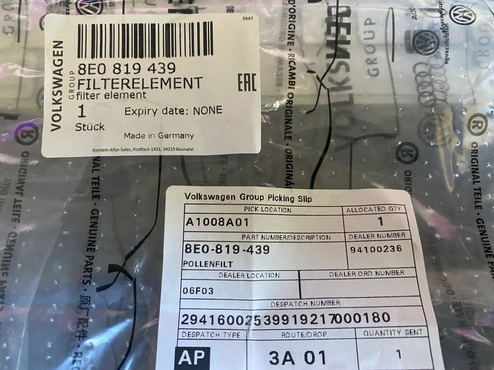

And finally, the part number in case anyone needs one

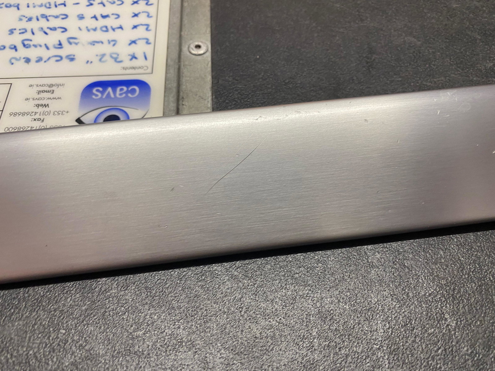

On 7/8/2022 at 10:09 PM, gsmdo said:
No - all good except for the driver’s door trim…😆

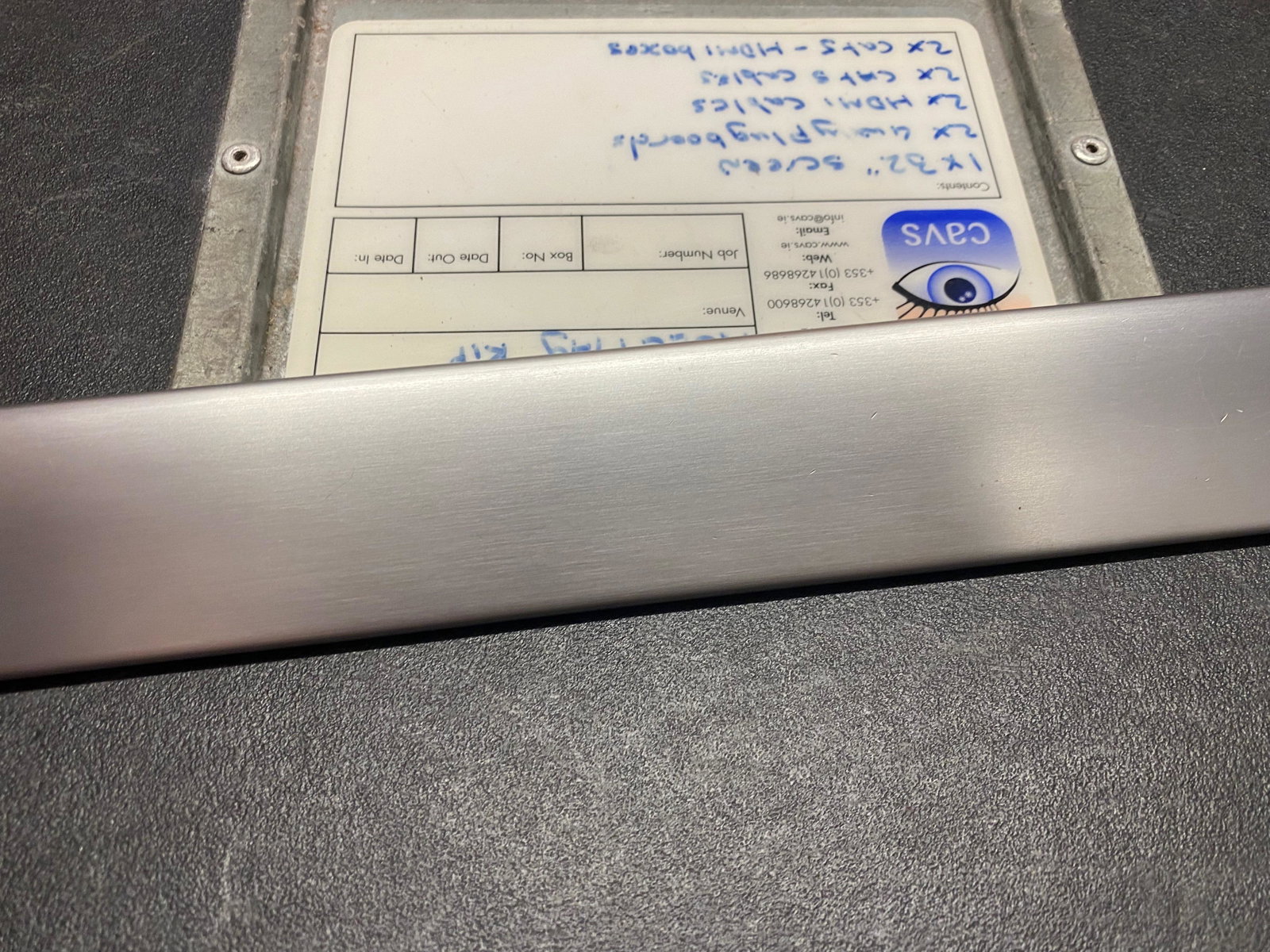

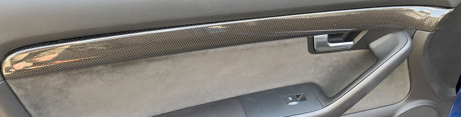

Here's my drivers side trim. It does have a couple of marks but it's yours if it's better than yoursIMG_1683.thumb.jpeg.6ac976222d32be8f1629642a8b69cc85.jpegIMG_1687.thumb.jpeg.71666575366b25effaf1b31b1e358bee.jpegIMG_1685.thumb.jpeg.afbaf69bf094f650b13b33c788ca5e35.jpegIMG_1688.thumb.jpeg.43cdf56c452ac05286a1e83acdb4eb0d.jpeg

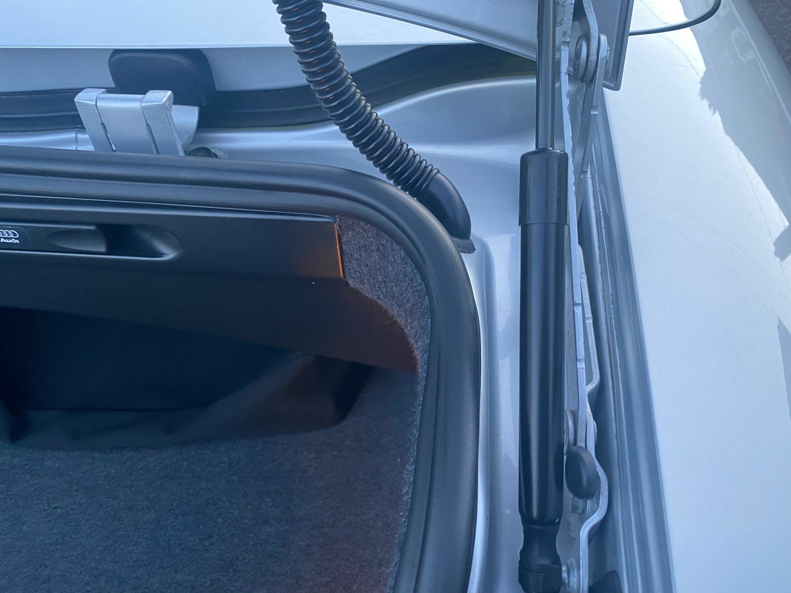

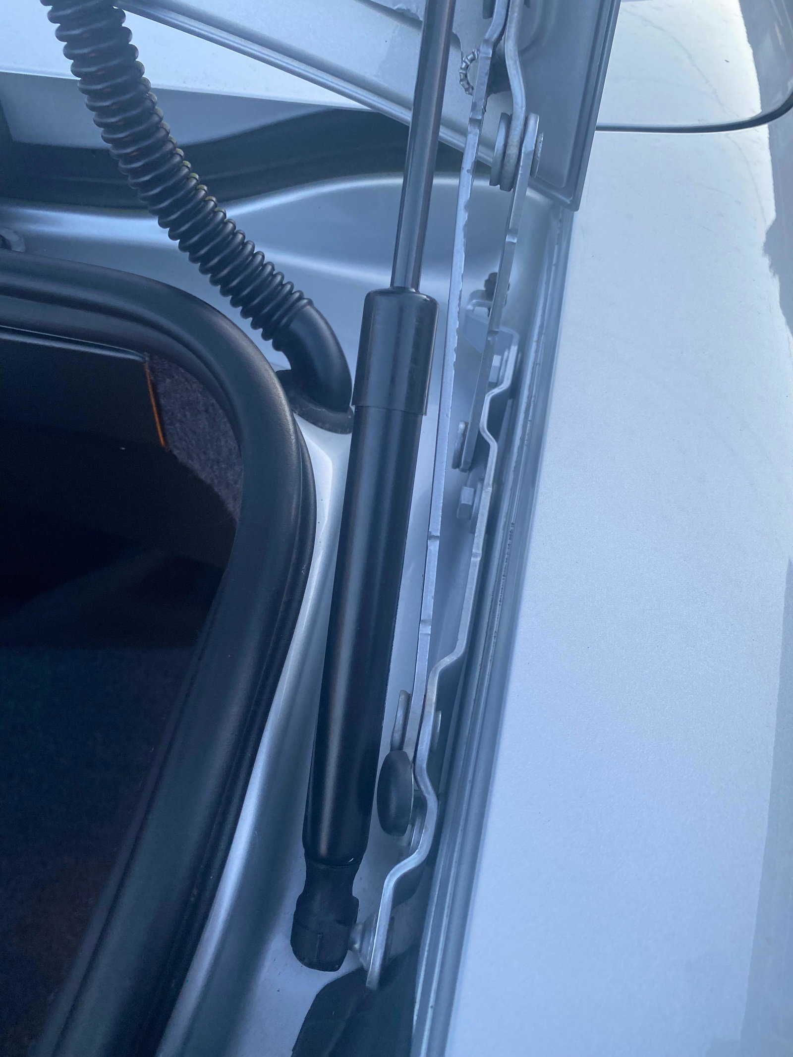

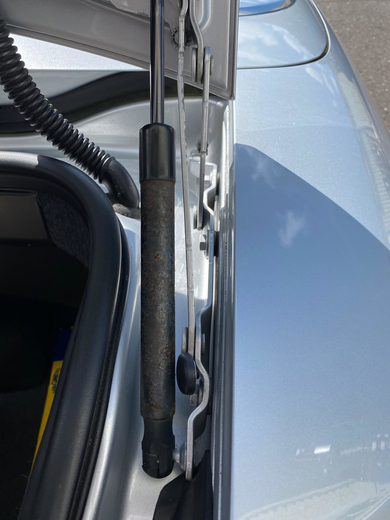

Each time I open the boot, the state of the gas struts has been annoying me. Decent replacements are only €20 each
IMG_1639.thumb.jpeg.bd41341c8238a88df824efe27d98869e.jpegIMG_1640.thumb.jpeg.f6b0db6009926e818fdda88a87e24c2f.jpeg
Fitting the new ones is a 2 minute job
IMG_1653.thumb.jpeg.9a627f76b6c6d404ff34d6c3124a5815.jpegIMG_1652.thumb.jpeg.77464e137f52999a2aa0218edadf27b7.jpegIMG_1651.thumb.jpeg.256cb432a53b291416433922b9f6ef27.jpeg
About the same as mine Tom - thanks anyway... 🤔

I cannot believe how clean your boot shut area is... 😮
We may well be cut from the same cloth - I replaced the boot struts on mine as one of the first jobs - simply because they were rusty looking... 🤣😂🤣

I clean all the shuts when I wash the car. It’s only difficult the first time you do it. Keeping it clean after that is easy. It does need another polish, the winter has left it covered in swirl marks. Shame that my trim isn’t any good to you. Have you priced it from the dealer?

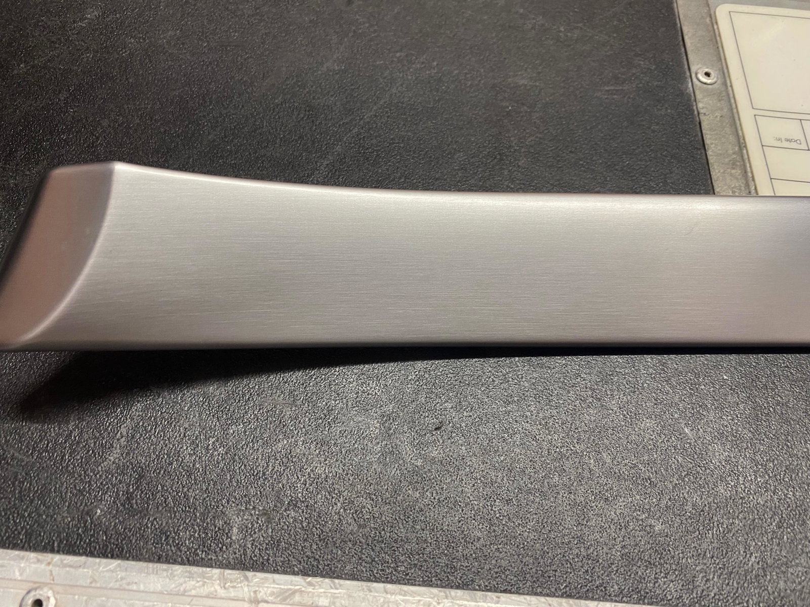

I'm pretty sure it's no longer available. It's not something that keeps me awake at night 😆 I keep looking for a set of Carbon-fibre trim from an S4 on eBay... 😎
I wonder if it would respond to T-cut, or simple polish, to take the minor scratches out... 🤔
T Cut won’t do it. A polish would help if you followed the direction of the lines on the trim. Try a cutting compound on a sponge

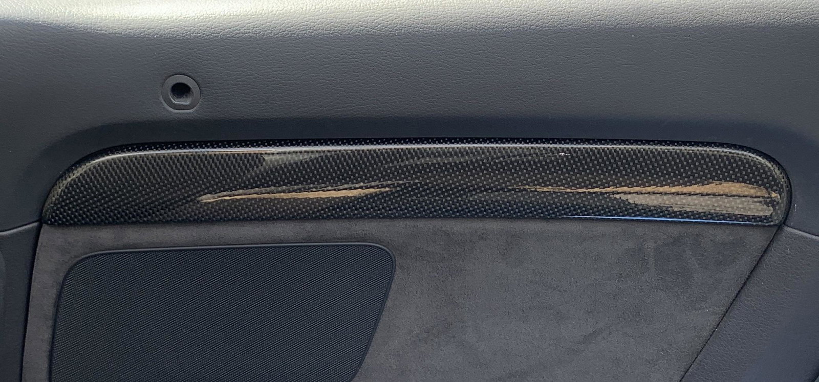

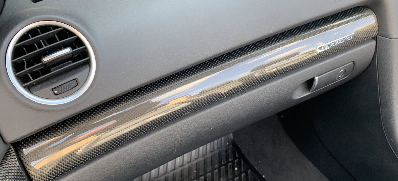

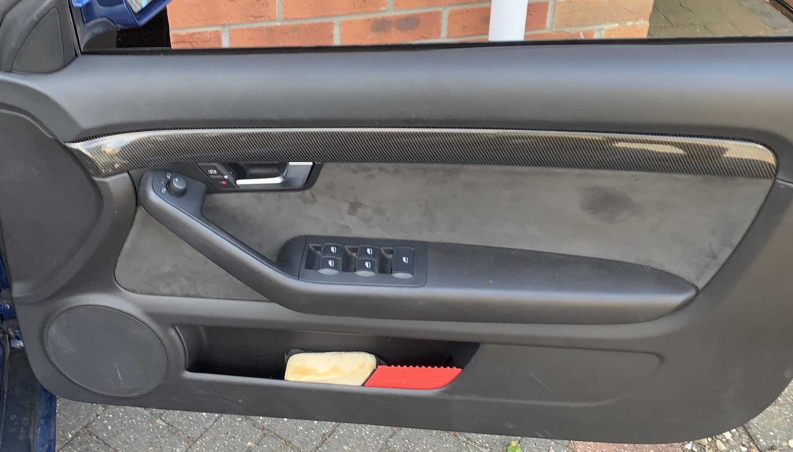

So there I was, thinking, "It's about time I did another search for carbon trim"...
Two hours later...
The trim around the light switch was the most complex to remove - but YouTube guided the way... 😃
It was expensive, but you can't take it with you. Also, it introduced me to a new VAG tuning shop and breakers over in Fakenham, less than half an hour away...😃
The gear lever surround and front ashtray cover weren't in good condition, but, as luck would have it, I didn't need either, as I have a phone charger hard-wired onto the ashtray and the controls for my aftermarket heated seats on the gear lever surround...

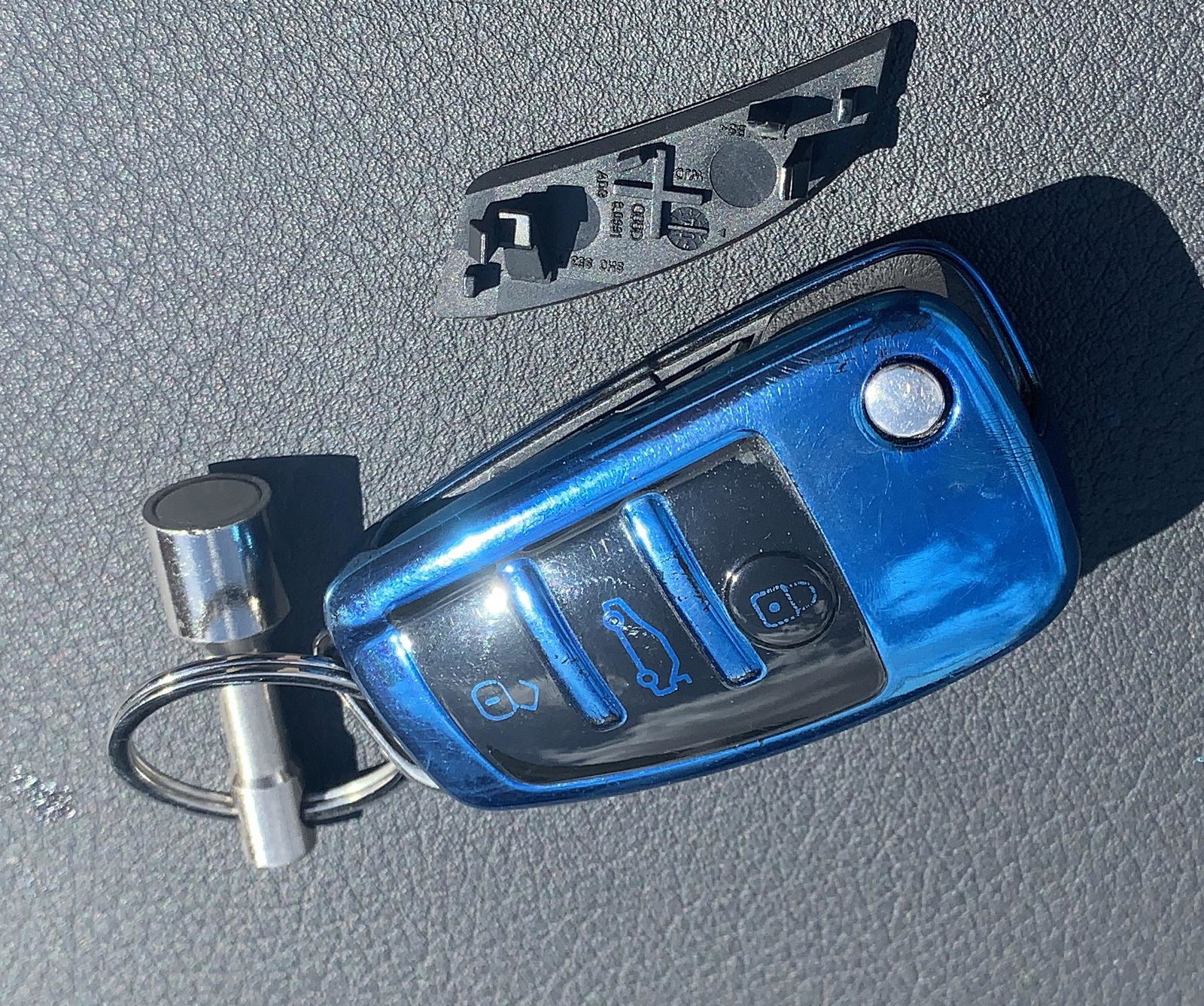

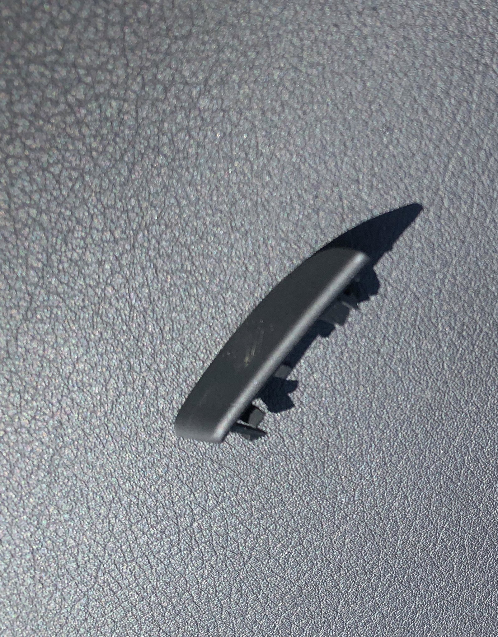

So - whilst I had the trim around the headlight switch off, something dropped into the driver's footwell...
...(key for scale). I'm unable to see anything missing (and it may have arrived with the new trim)...
...any ideas?

Delighted you found what you were looking for. You’re welcome to hijack this thread anytime. It’s so satisfying to do these upgrades. In my mind, the car seems to run better afterwards
  • Thanks 1
The CF trim round the shift and the ashtray cover would polish up very well. I hope that you took it anyway. It’s not the hardest to hand polish. The wood in mine was pretty scratched
