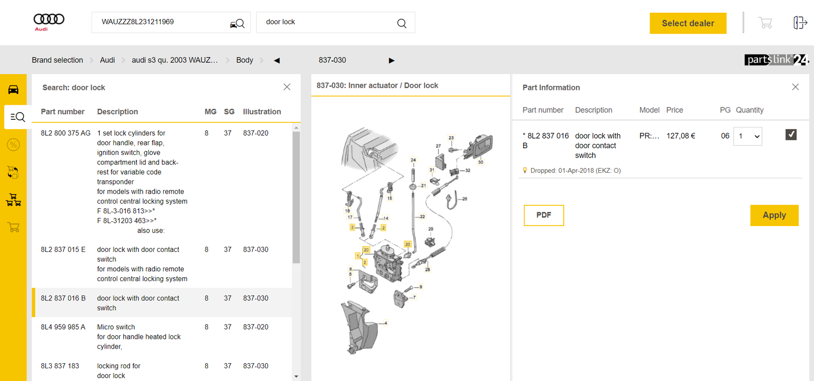

s-l1600.thumb.png.6b55e42b3bd3c72ddff6321906e1f78c.pngHi
audi s3 8l mk1 2003
Having trouble with osf drivers side door catch  will not close properly.been told part number is 8l2837016b but having no luck finding  this part!! Does anyone know if there is other part number that is compatible with this model? Many Thanks.

Have look on ebay search online & online scrapyards no luck. Part no longer available brand new. Can see part numbers 8l2837016 & 8l2837016a but not sure if compatible
Many Thanks
