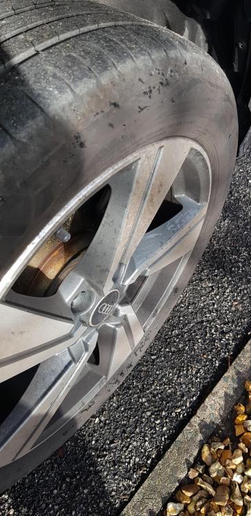

My wife purchased her Q2 in July 2021, from new, and we have noticed that the inner wheel between the Alloy and brake housing on all four wheels.

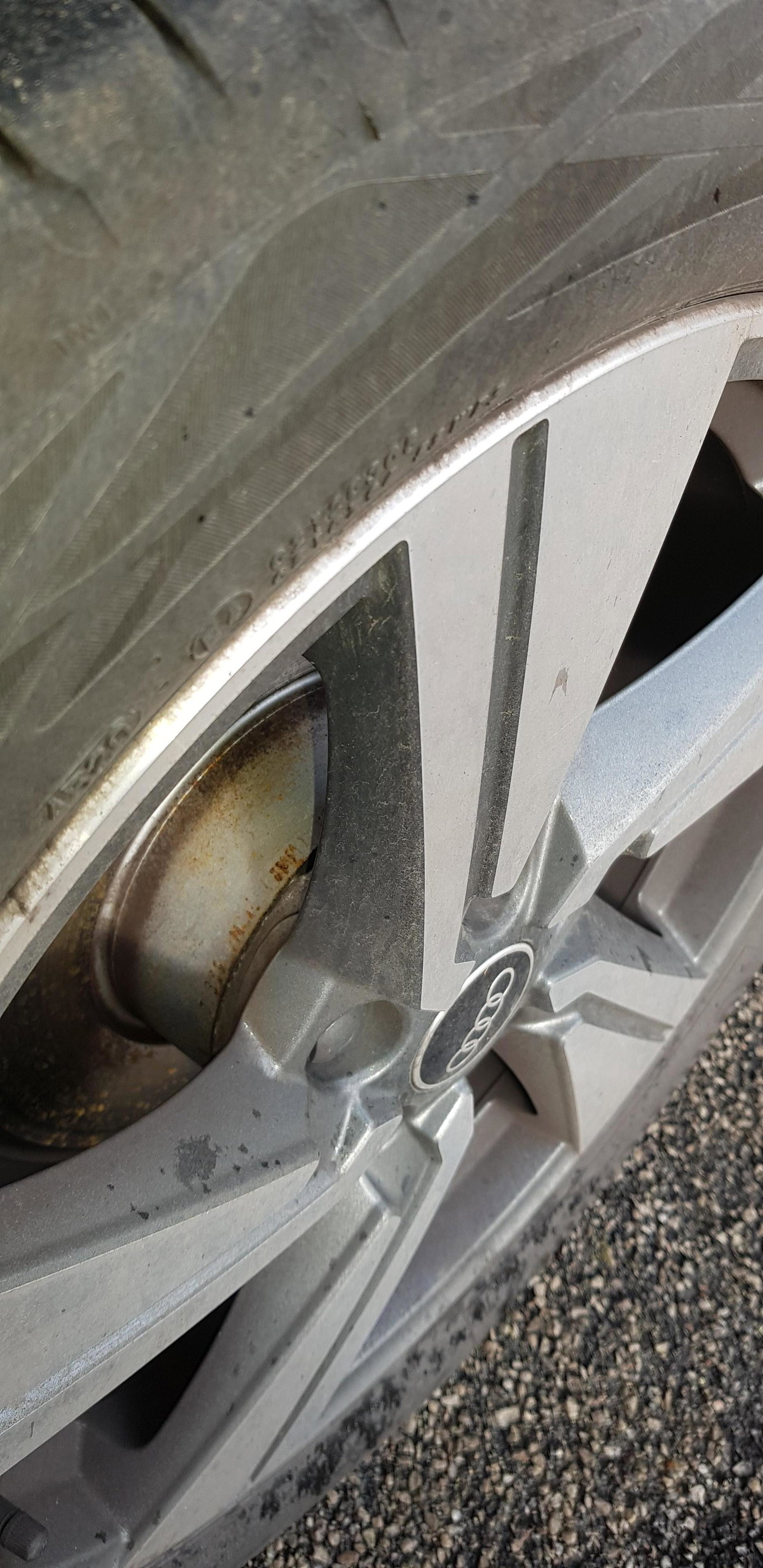

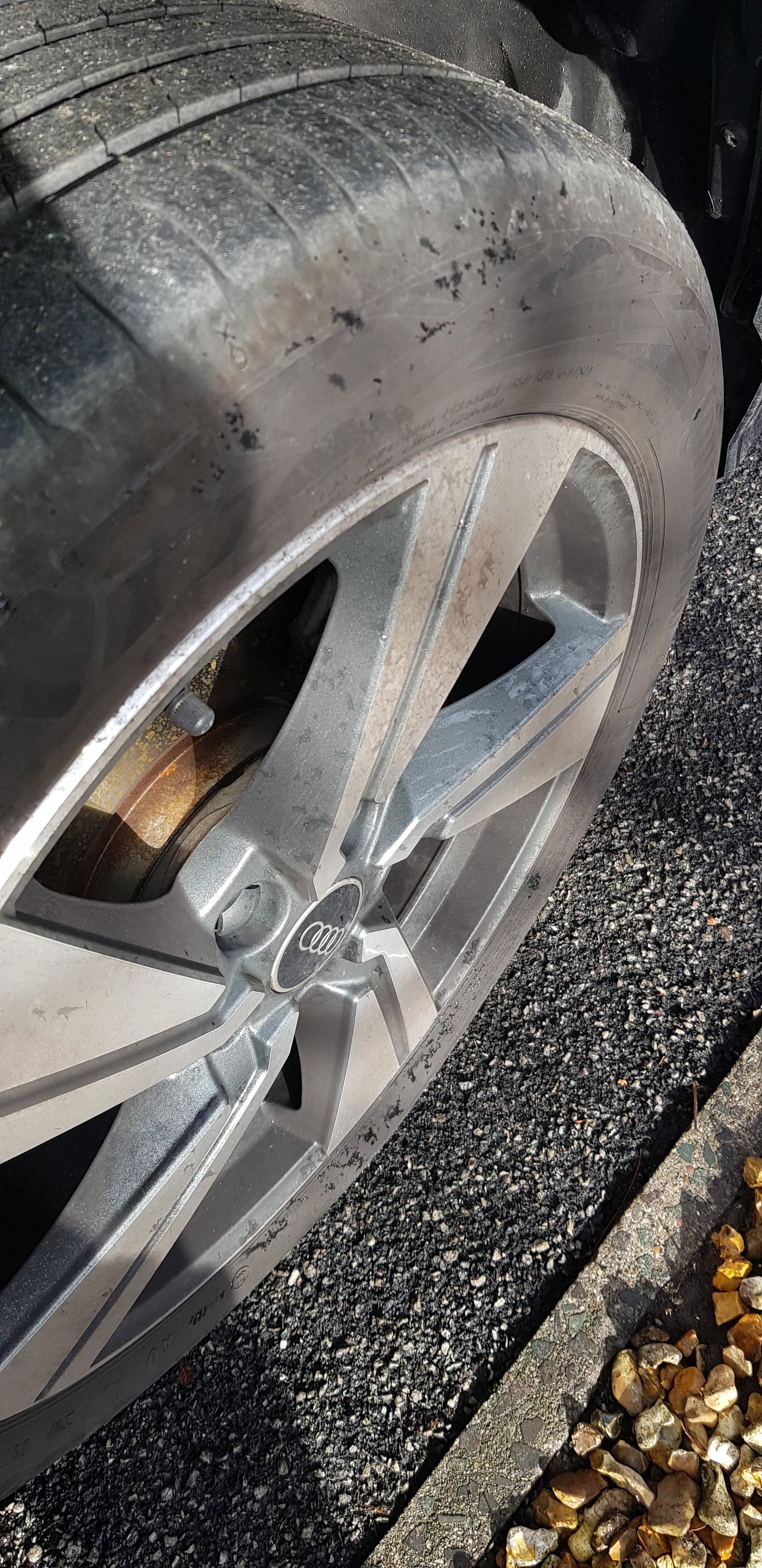

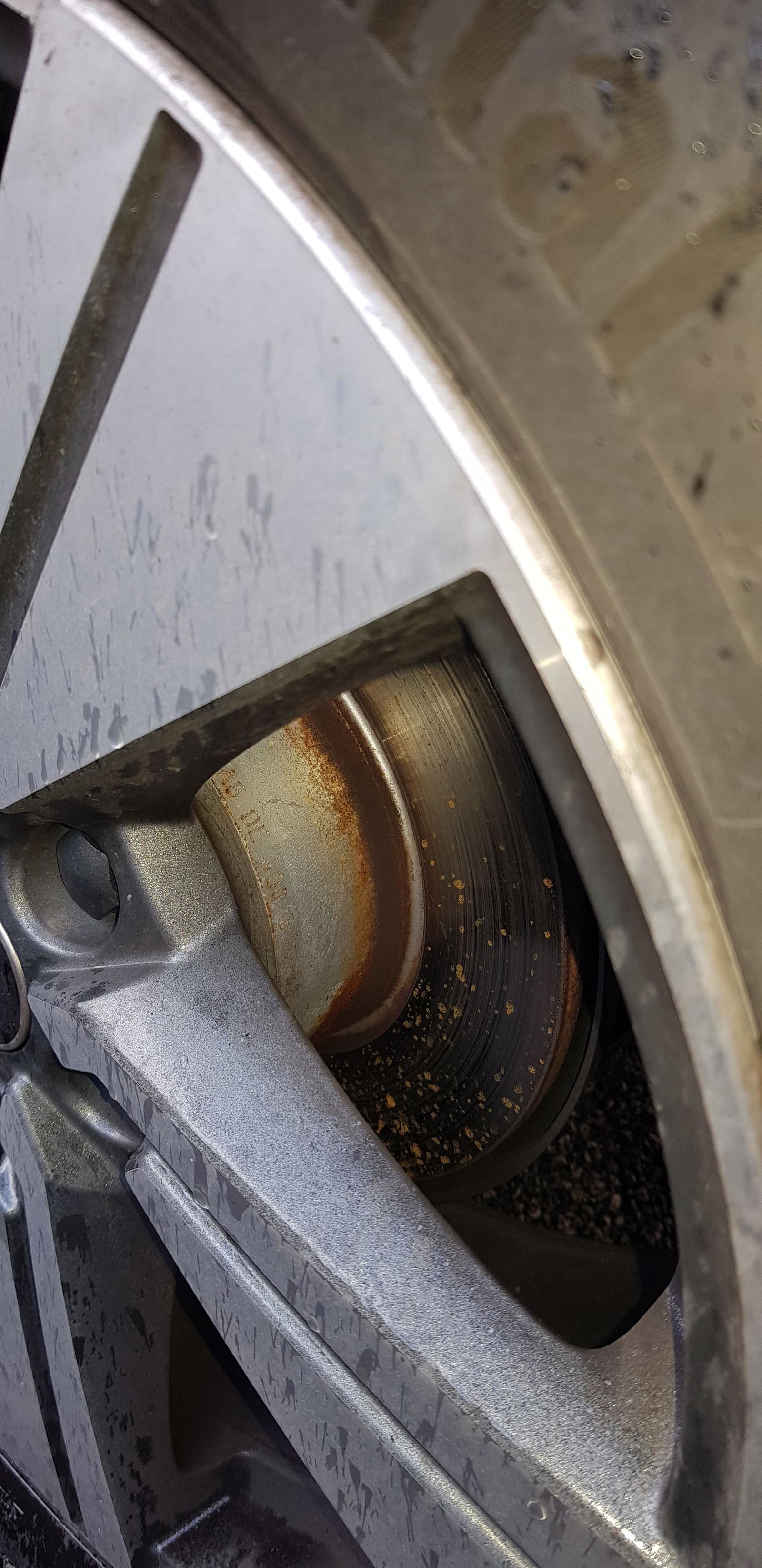

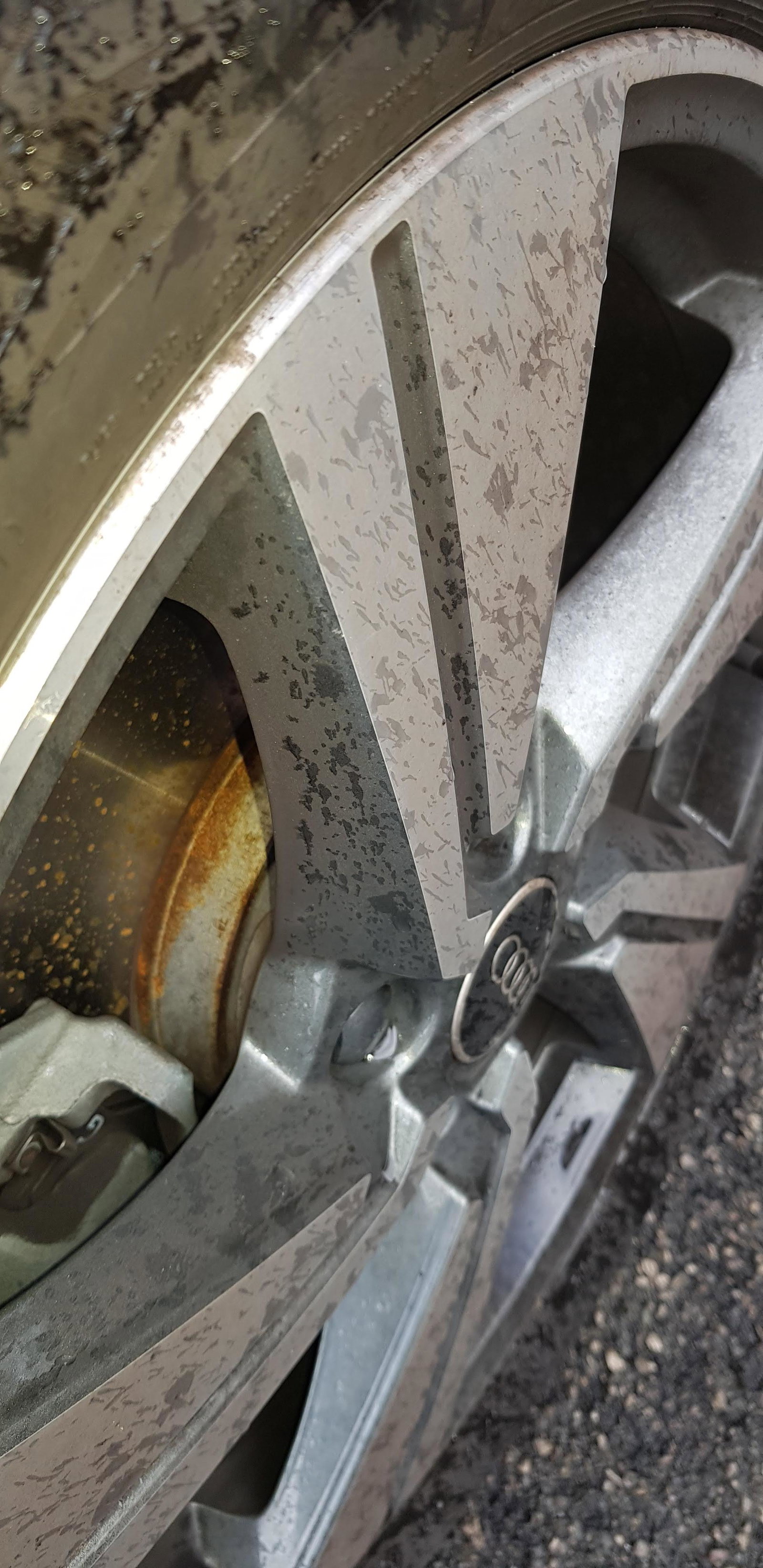

Morning. I have up loaded the pics. I'm hopeless with cars so my description was not the best.  Re washing, Normally the old fashioned bucket and sponge way, but on occasions I use the local car wash folk with their jet wash.

Looks typical of corrosion of the centre of the brake discs - not uncommon as the discs age - and largely cosmetic. The difference here is that that surface rust is manifesting itself in a relatively short space of time, and is not a good advert for Audi.
Rust treating and painting should improve the situation, and if done properly, should last longer than it has so far.

Hi to be honest they all do that after about a year as the coating from the factory is only about two microns thick unfortunately if you want better you will have to take the wheels off and purchase some VHT paint and using a good quality paint brush do it your self on a nice hot day where you can give them a nice thick coating it will last the life of the disc.

I just wonder if the aggravator/ accelerated deterioration rests fairly and squarely with the local car wash folks with their jet wash. Personally, I wouldn’t let anyone with a jet washer anywhere near any car of mine. If you consider that a jet washer will remove debris from your patio, then just consider what it does for the paintwork of your car.
If that isn’t enough, then wheel cleaning consists of dosing the wheel in acid, before blasting that acid around the wheel and between the ‘spokes’ - including the brake discs and any associated suspension components. Real bad news in respect to preserving the finish on any component.
I’m with Steve’s method if you want to correct the damage already done, and sorry Ian, but I think blaming Audi for the result of any aggressive cleaning regimes at any time, maybe a a step too far. if you do opt for the dealers ‘temporary’ fix then I would be staying well away from anyone wielding a jet lance in future!
