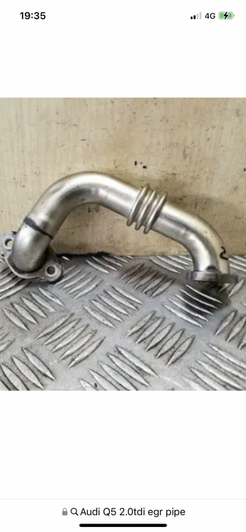

1505D190-7291-43D9-9AEF-BC62B8290FEB.thumb.png.65823501d674dcc9af257169b282784a.pngThis is the pipe that has cracked again Stevey,right in the middle where the 3 strengthening ribs are,i wondered if the egr was blocked and whether just get a new egr first as last,

Hi its only a short run pipe so I would not expect it to do that, it would suggest a blockage but it could well be an engine vibration issue but I doubt it as these things are made of a high grade stainless steel trouble being its very brittle, check the EGR cooler is not blocked.

Exactly where in the middle has the pipe cracked. Can you highlight it on the photo? Radial or along the length of the pipe? I think I know where you mean, but want to be sure on exactly where.
Was  this replacement pipe new? - it looks rather secondhand for only 1000 miles of use.
Dependent on this location - it could be a too-much- movement issue, but….
Hi Gareth,its cracked both times on the 3 ribs in the centre of the pipe,that pic is just a sample pic off Google,i bought a genuine Audi part to replace the 1st one and shall do again to replace this one,i did wonder if it could be a vibration issue but the car doesn,t feel unusually rough,quite refined really which surprised me when i bought it having mainly run 6 cyl petrol BMWs over the years.
The crack has been radial both times.

Thanks Mick,
Sorry to be pedantic, but in one of the two ‘grooves’ of the three ‘peaks’, or on the ‘peaks’ themselves?
Failure point of the replacement, exactly the same point as the original?
No its ok Gareth all input gratefully received,the first pipe blew a hole on its outer edge with a radial crack going round the back but the most recent is just a small crack radially in the 1st groove

So you’ve had two different modes of failure on two pipes - very odd. I would say the latest failure is typical of stress fracturing - which could be excessive movement between the two fixing points.
Looks like you have hit the nail on the head with your comment on stress fracturing Gareth,
My mechanic says that at some time in the cars history it looks like a stud has broken and been drilled out and replaced by a pin that must be slightly misaligned as the first pipe to break was an absolute pig to replace,so he is thinking that with the car getting hot then cold it has caused the pipe to fracture,so today he is stripping it all down for access to hopefully remedy this issue and fit another new genuine egr pipe,
