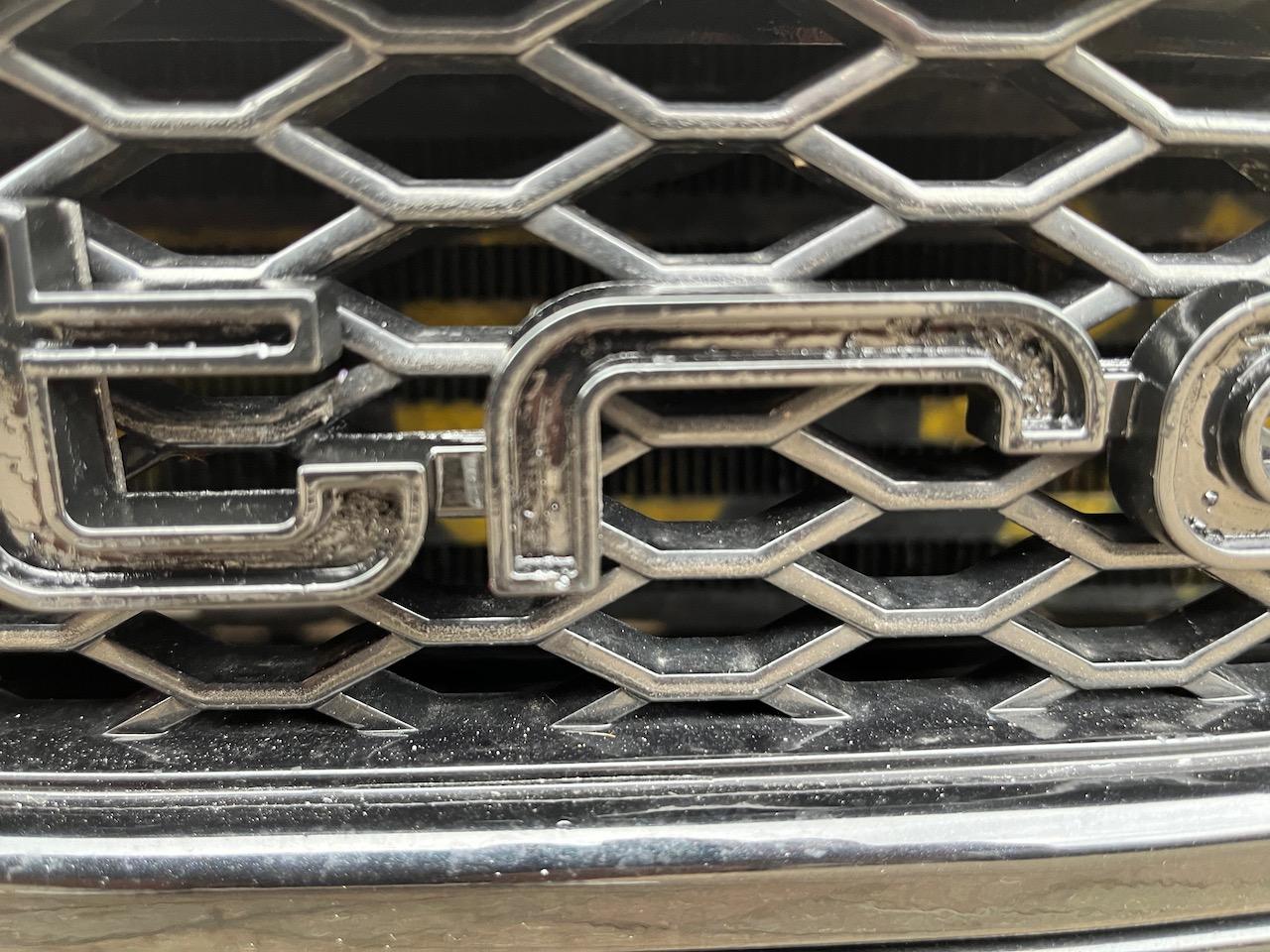

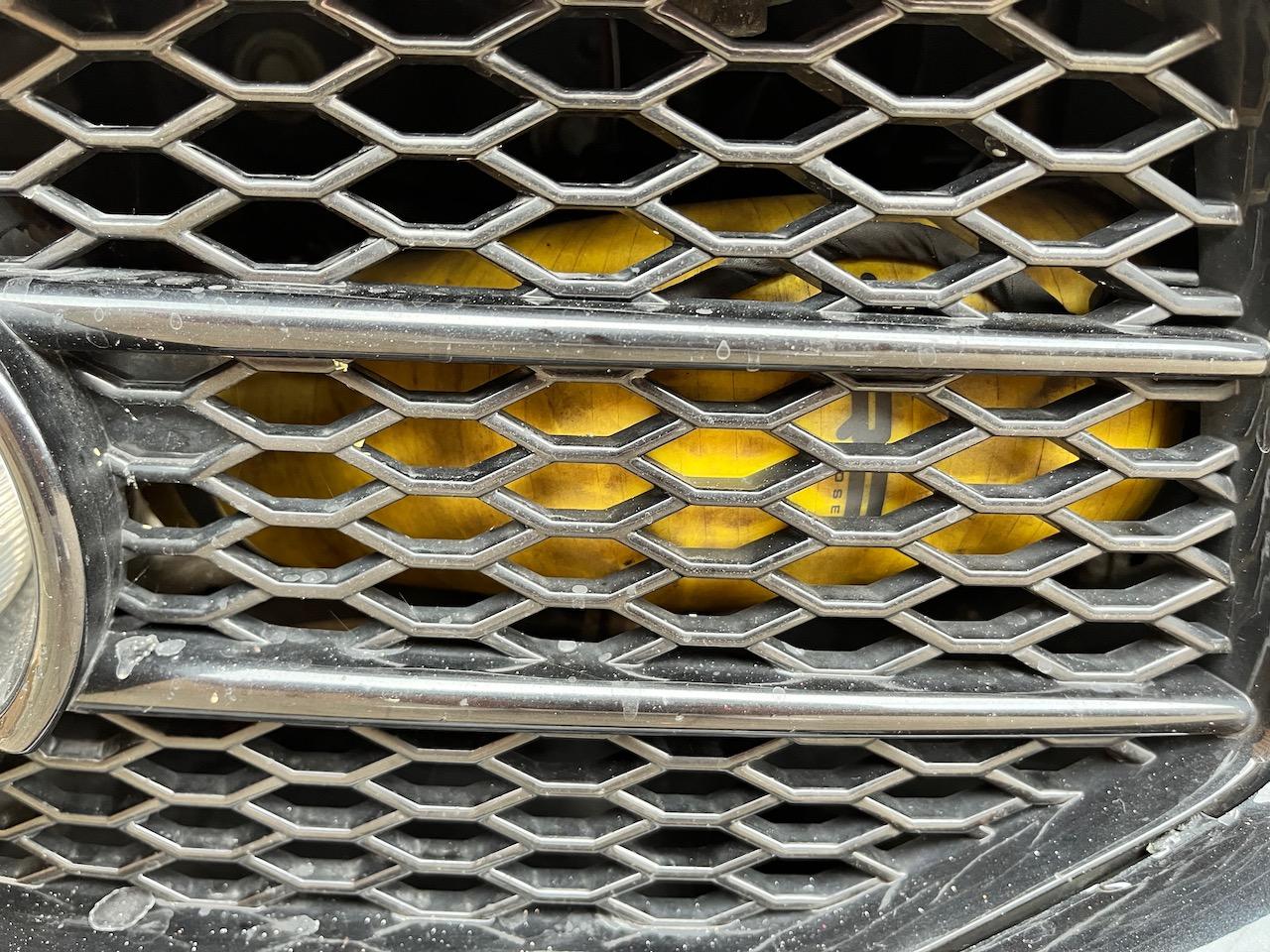

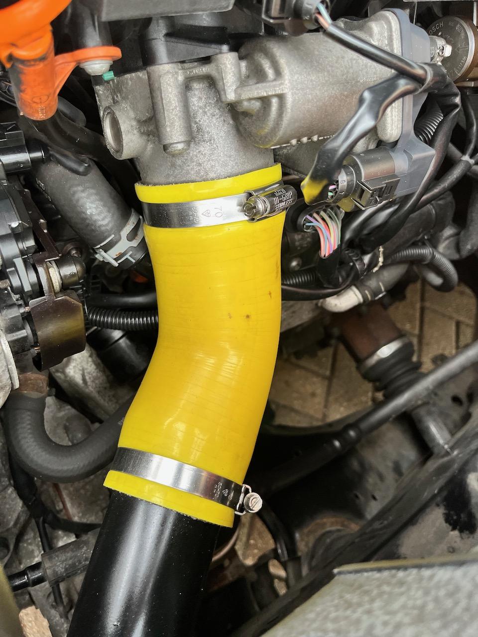

Ok after some investigation in the engine bay it seems I have an Airtec Intercooler upgrade for the B7
https://www.airtecmotorsport.com/product/airtec-motorsport-front-mount-intercooler-for-audi-a4-b7/
As it looks similar to the hose colour and logo sprayed on the fins

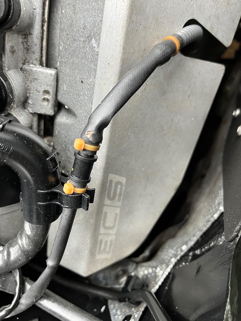

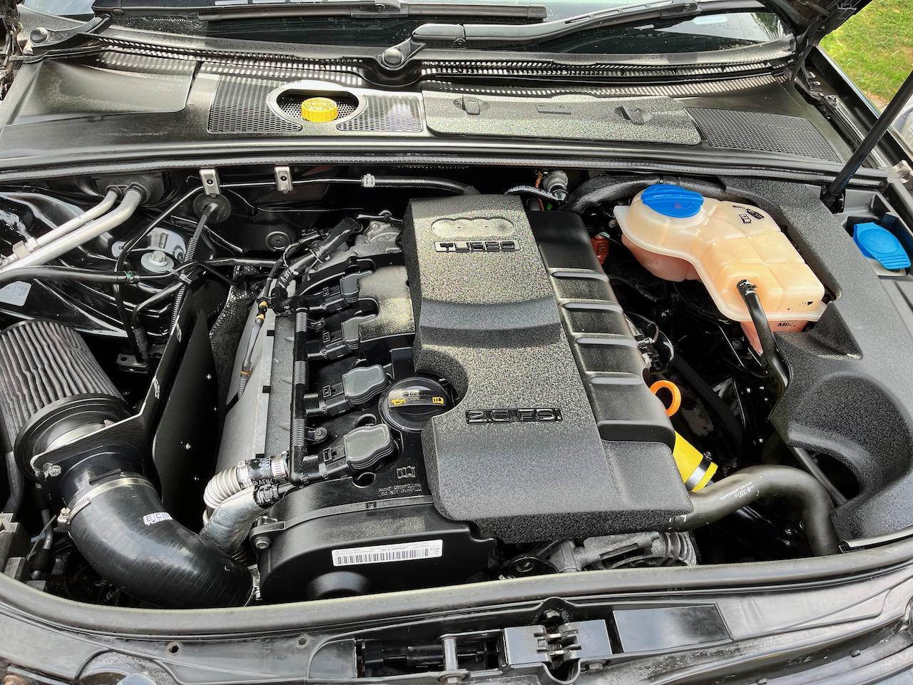

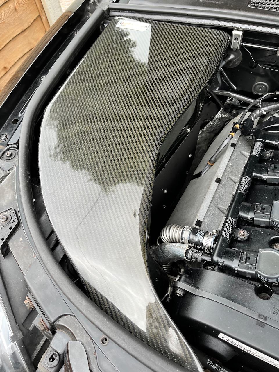

Now the ECS, well hiding under the carbon cover is the ECS induction kit

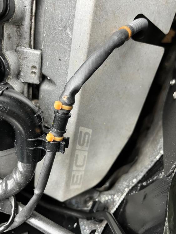

but not sure what is hiding under this shield over the turbo ?
thats an ECS carbon induction intake kit, just an uprated air filter box that covers a larger area, performance gains are questionable on the B7 platform but it does look much better that the OEM layout.
As you may find out along the way during ownership , there are a lot of options, and i do mean a lot, for the B7 variants and a lot are interchangeable from model to model.
you will very rarely find two with the same spec and more often than not some special editions have very few options given there original cost, which is annoying but hey thats audi for you.

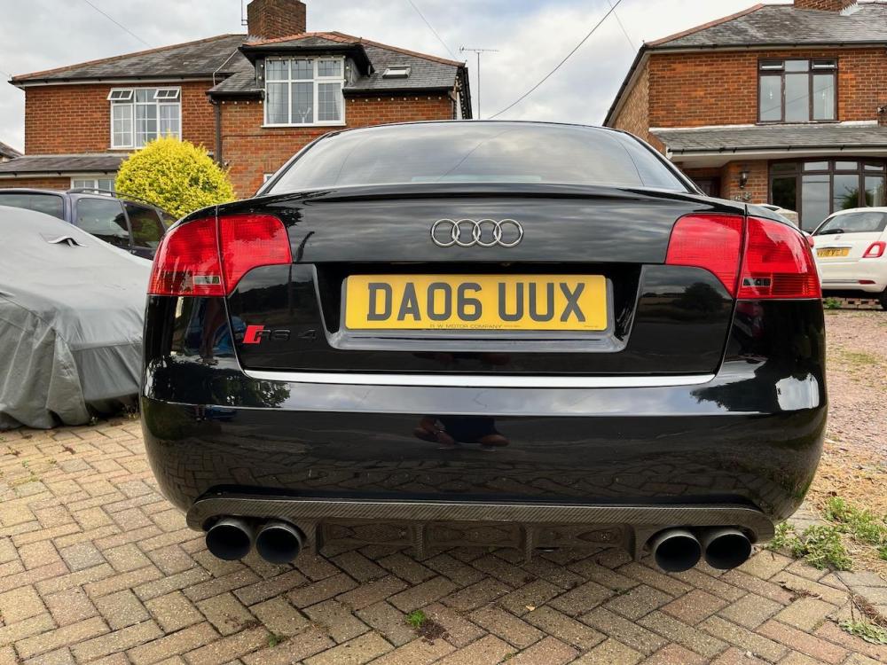

It most likely fitted with a sports cat or similar HFC  , maybe just a straight decat pipe connected to that straight through system, eitherway can be a challenge at MOT time with emmisions, a look under the ECS cover will confirm which.
quad tips indicates an S4 rear valance or similar aftermarket valance.

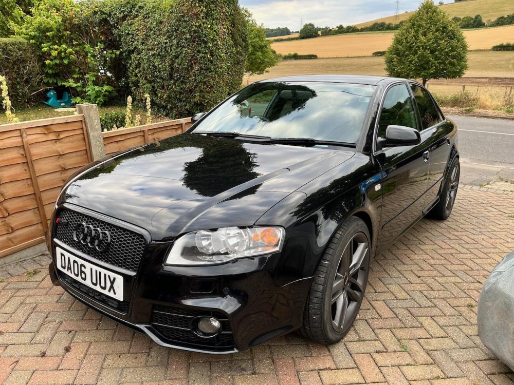

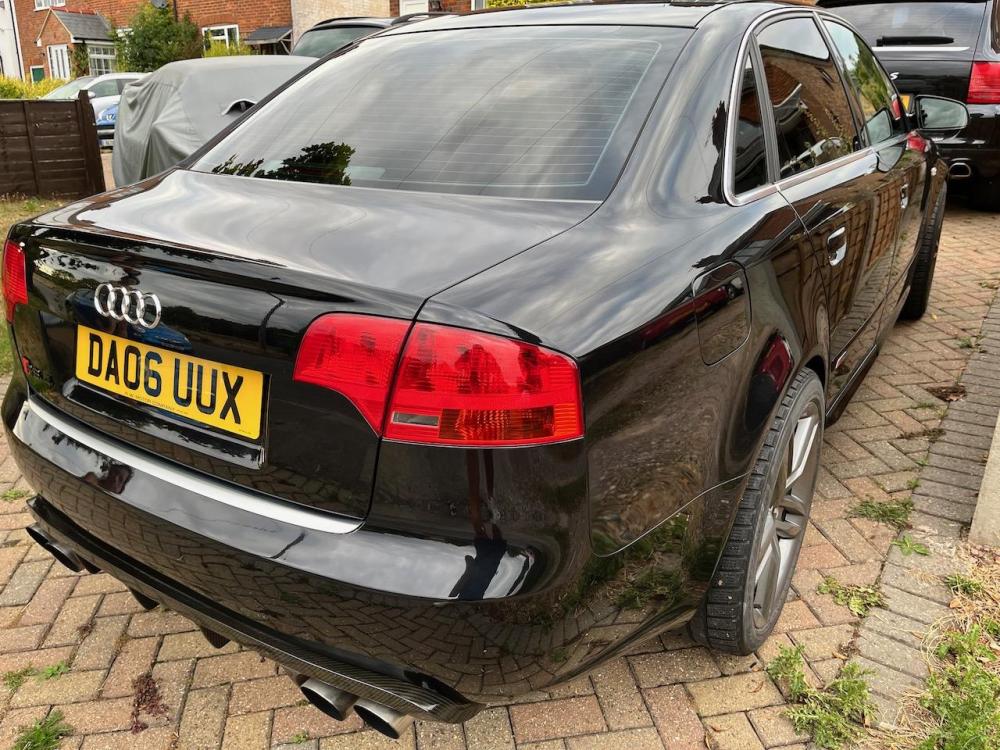

Yes indeed. Please ignore the wrong wheels, overtyre look and the dodgy "fast and furious" styling by the previous owner. He was from Essex after all 🙂
19" alloys are not an issue on B7 provided they are the correct offset and tyres have been reduced in profile.
OEM setup on the special edition is 18" 8j et43 ronal alloys with 235/40 18" tyres, going to 19" is fine but that needs to change to 235/35 19" and offset can be upto ET 35 to retain clearance of the rear wheel arch liner, and certainly no more on the front.
I run 19" 8.5j OZ alloys on ET38 which is perfect, with KW coilovers, absolutely spot on and still retains a level of OE appearance too.
Ok, front bumper is aftermarket with what looks to be a genuine RS4 grill.
Rear valance is aftermarket S4 , looks like an ecs one but sticks out a bit too much for ecs valance, cant recal the other brand but it will come to me.
Alloys are wrong offset or width , maybe both from for looks tyres dont help.
Still like we all say , it was the previous owners preference and if he liked it that way then fair enough.
Hu units, swapping to aftermarket devices requires a fitting kit which will inc the frame and surround, also a suitable adapter loom , most double DIN  oem B7 hu's have the quad lock setup so the fitting loom will get your ISO sony wiring into the Audi quadlock inteface.
depending on what audio spec was fitted at the factory the previous owner may not have fitted DAB ariel into the correct plug as there are two fakra plugs on some units , also the Ariel adapter needs power which many over look.
those alloys may infact be spaced aswell, suspenion ride height looks a bit high but possibly still on oem kit or similar spec , maybe the tyres making it look a bit too chunky though.

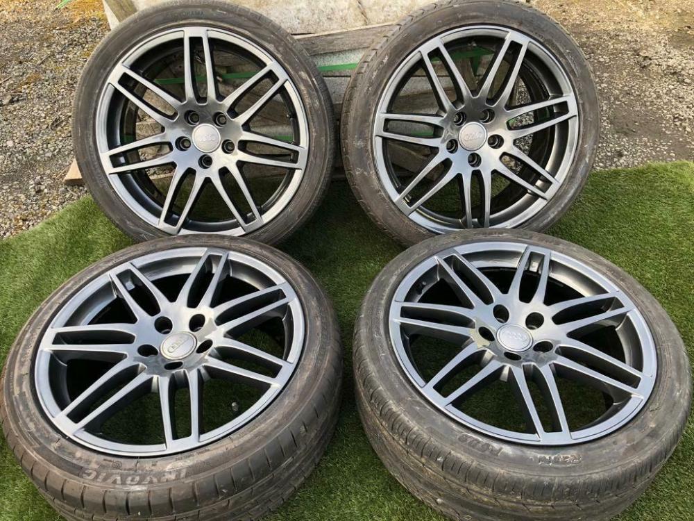

I think these are RS wheels which with the wide body on that model may suit it but on mine it looks all wrong and the offset is terrible. In the week of owning it I have seen the rubbing on ther arches and picked all the melted rubber off !
I have found some lovely Le Mans genuine Audi 18.
8J X 18 ET 43 18/235/35 in anthracite which should be perfect without any spacers.
