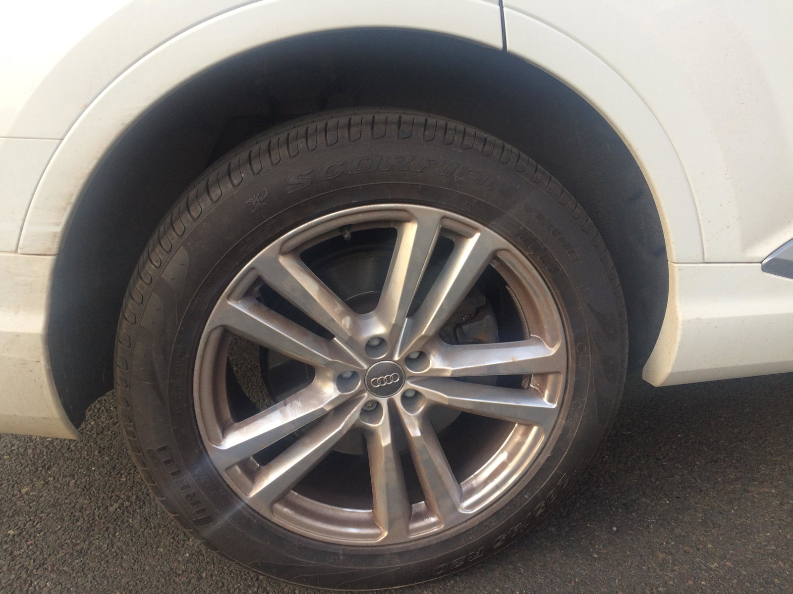

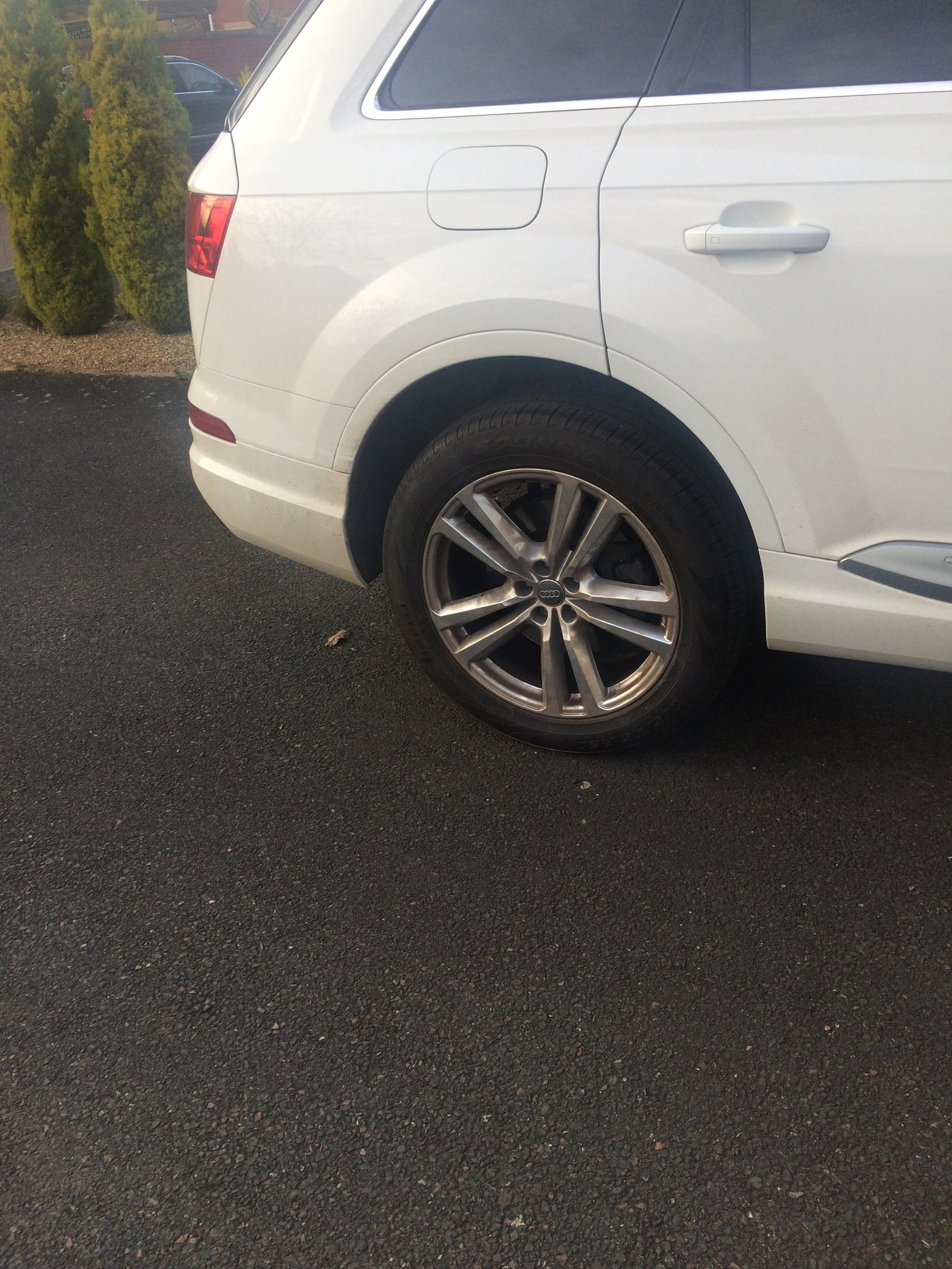

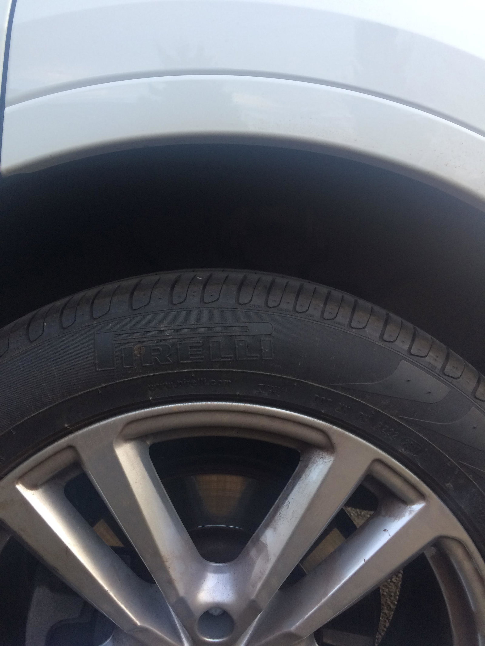

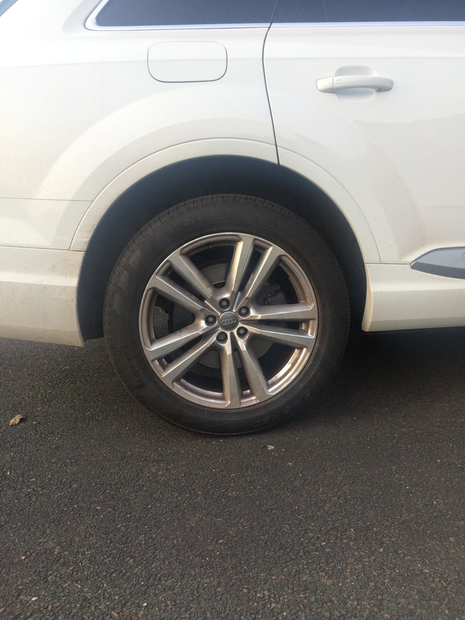

I had to replace the coil springs on my 2018 q7. Upon getting the vehicle back it looks as if it is sitting a little high.
is anyone able to advise based on the pictures. Is there a minimum gap that is required for these vehicles.
The car sat lower before but naturally because the springs had a split in them and had to be replaced to pass the MOT.
Please refer to pics
Any feedback would be appreciated.

Who fitted your new springs for you , and if not a main dealer, were genuine Audi parts used, and if not - indeed the correct replacement fitment?
There will be an unladen ‘distance’ measurement ( taken on level ground) from the wheel centre to the underside of the wheel arch, and this will have a specified tolerance.
Sorry, what measurement is? - but your Audi dealer will know, or indeed you may well find it on a Google search. If all else fails - you can always measure another example of the same model.
Perhaps you can colour in there detail for us.

Thank you both for feedback. Yes the coils were fitted by an Audi main dealer. I did phone them the  following day and was told they will settle and naturally the unladen distance will decrease. Have never had suspension issues on any other vehicle, but being the first decent car I’ve had thought to go to a main dealership. I only bought the car last October and had gotten so used to the car riding so low thought that this was the normal ride height.

Hello Sam,
’..will naturally settle..etc…’ is rubbish. If they ‘settle’, then why don’t they continually settle, until a point where the tyre touches the arch? Springs are designed to compress under load, and return to their unladened condition once the load is removed. Yes, given many years of use, they will compress a little, but that will take years not weeks. You have been subjected to ‘receptionist speak’.
Reverting:- you have to find the correct figure I mentioned in my first post, and once armed with this, you can accurately determine whether your new set up is within tolerance - or not - and anything else is simply conjecture until you do that. You should be able to find this somewhere on a Google search, but best to e-Mail Audi your VIN and ask them the specific question.
Perhaps you can come back to us Sam.
p.s. As I think may have been mentioned, your old springs may have fractured close to the ends, thereby decreasing the ride height. Alternatively, the vehicle may have been used to regularly carry heavy roads before your ownership, and have indeed compressed with some years of ladened use - but again all conjecture.
